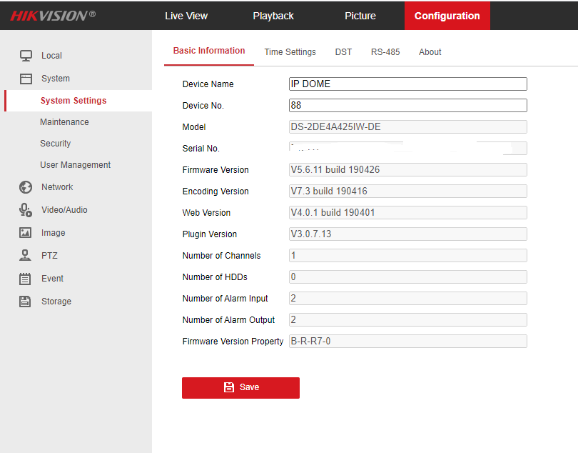

I've been reading HikVisions website user guides, using the google, using youtube, trying everyone's guides and instructions, but still am having zero luck.
Camera Model - HikVision DS-2DE4A425IW-DE
Firmware - V5.6.11 build 190426
And again, there is no NVR/DVR connected to this camera

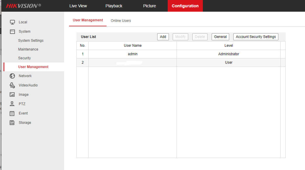

I have a local user-defined with a name/password and just has rights to Remote: Live View and Remote; PTZ Control.

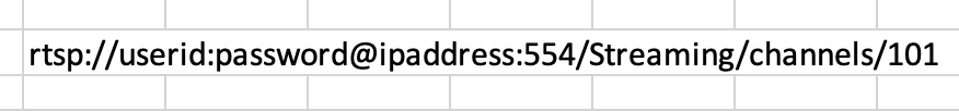

I can stream rtsp direct from my camera, use the URL in the image I posted in an earlier thread.

On. the camera admin account setup a user account with remote view privileges only, log out admin and login user. If it does not work login as admin and find out why.

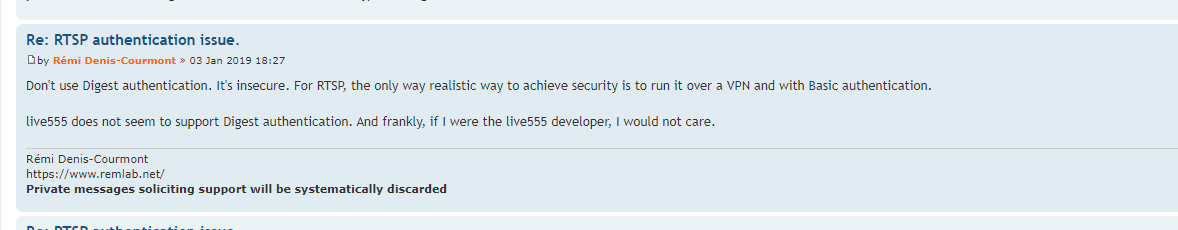

Based on the above error, i found this post, but that also didnt seem to solve the issue either. I've also tried another computer with VLC installed..no dice.

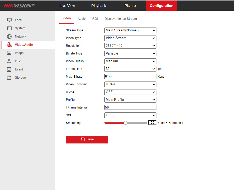

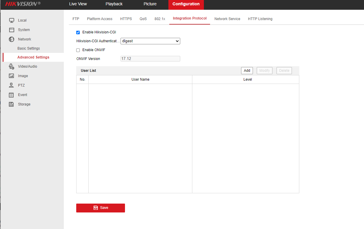

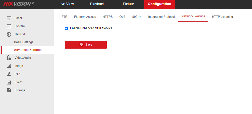

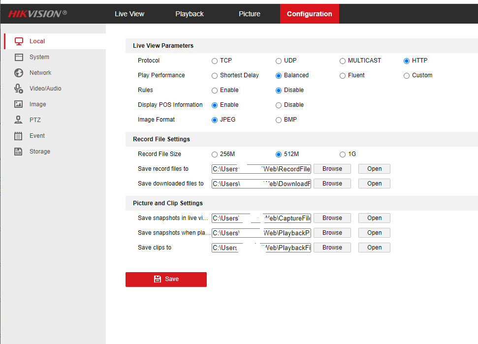

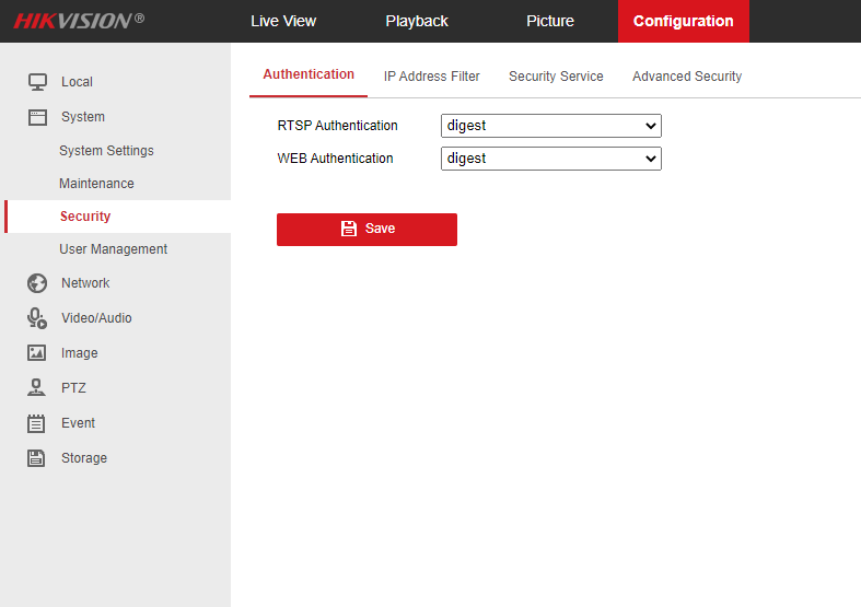

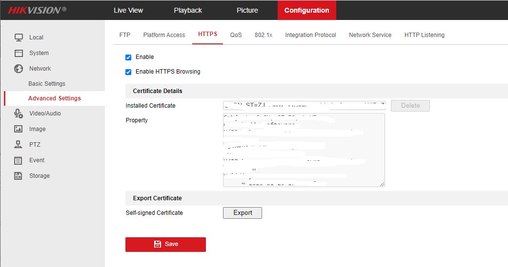

I also am attaching screenshots from camera web interface to help. I've seen videos saying to turn on Hik Vision CGI or seen posts that say to turn off SSL encryption (but not sure if that was only nvr setups )

@GetAfterIt on the vlc log it says PUBLIC IP, have you tested this on your LAN?
For now disable NVR HTTPS.
Is the NVR rtsp port 554?

my LAN rtsp url would look like this....
rtsp://admin:abcd1234@192.168.0.1:554/Streaming/channels/101

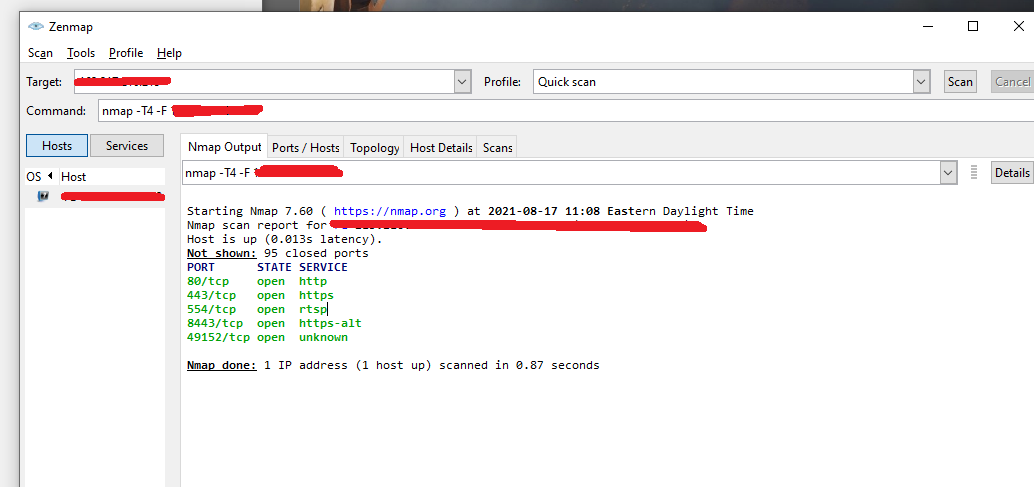

Well, the camera lives out on the internet, no nat or port forwarding, so no local IP to try. And I dont have an NVR for this, so if i disable HTTPS (screenshot 5) wont that affect the camera?
I attached nmap showing port 554 is open on the camera.
I also have access to our palo alto as we have a /24 here and i see https and rstp traffic being Allowed, so its not our firewall.
Maybe VLC is the culprit? Then again, i have also tried vlc on my laptop, and it was a fresh install of vlc.
if http port 80 is disabled yes, how do you access the camera http or https?

post the public rtsp url with IP address and password changed. In the VLC log I noticed a colon in a strange place, that could be parsing by VLC.

@GetAfterIt 3 of my cameras have rtsp digest authentication activated and rtsp streaming works with the standard URL.
Could you post the public url you are using with changed IP address and logon details?

rtsp://user:QW123@9.9.9.9:554/Streaming/channels/101
i just changed the username and pwand then swapped the IP address for all 9s.

When I saw the quad9 DNS on the VLC logs I did wonder why and then the penny dropped.
URL looks good, I wonder if that camera uses a non standard URL?
