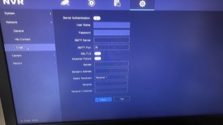

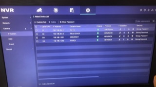

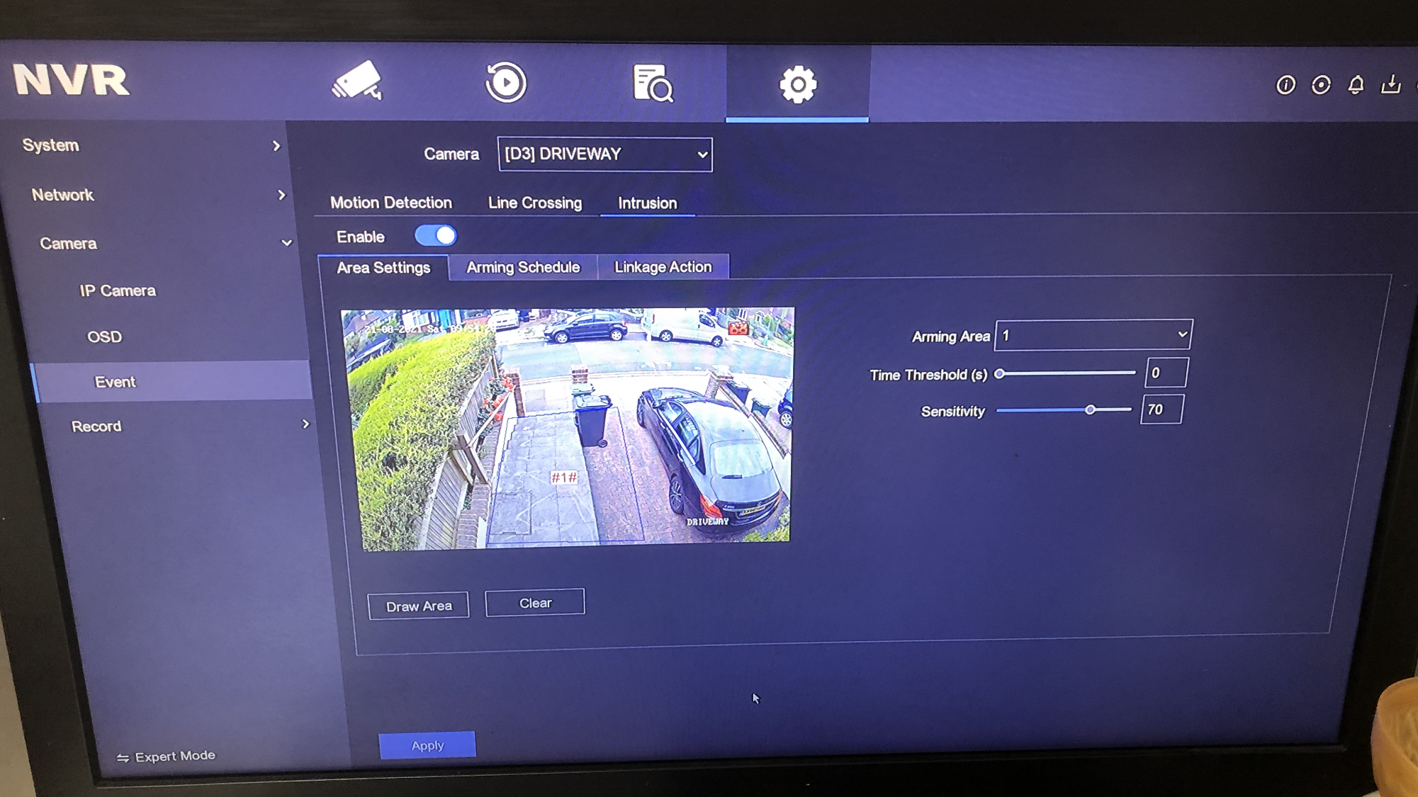

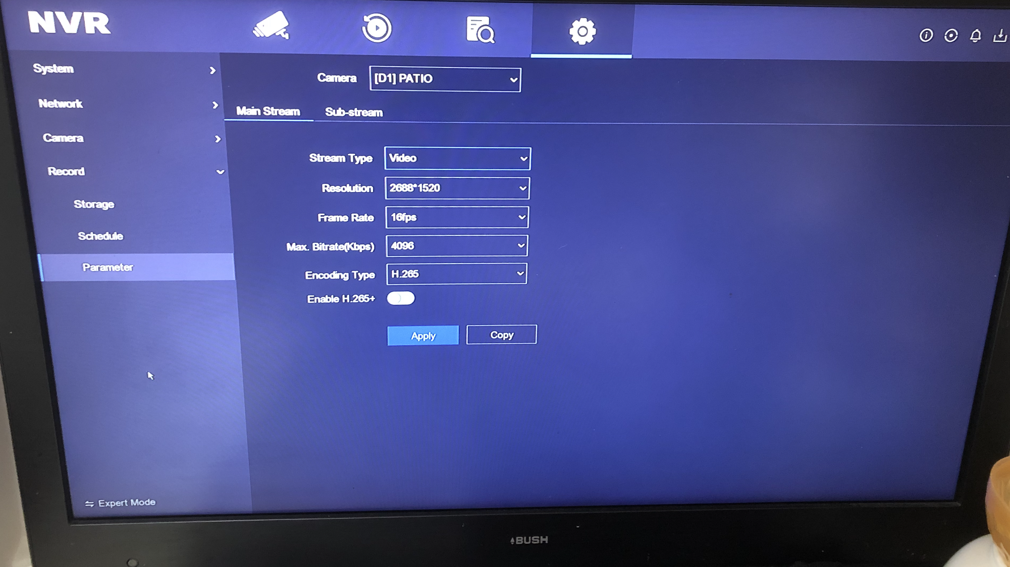

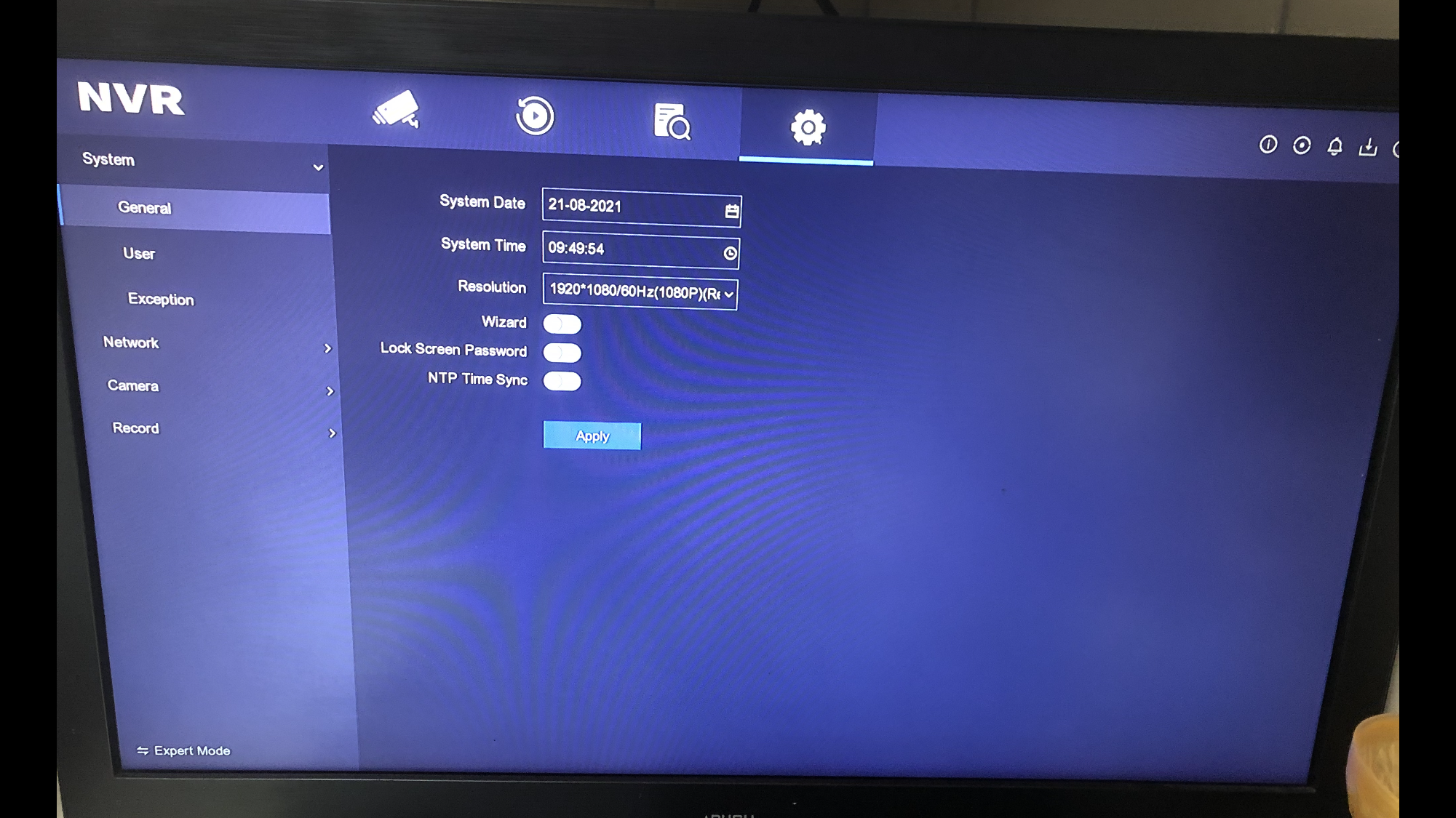

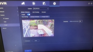

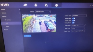

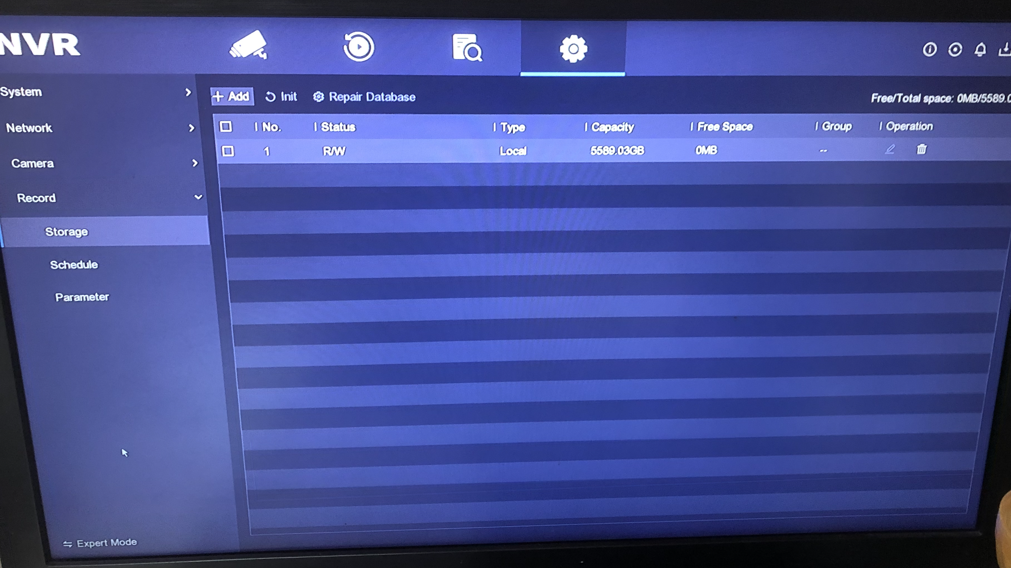

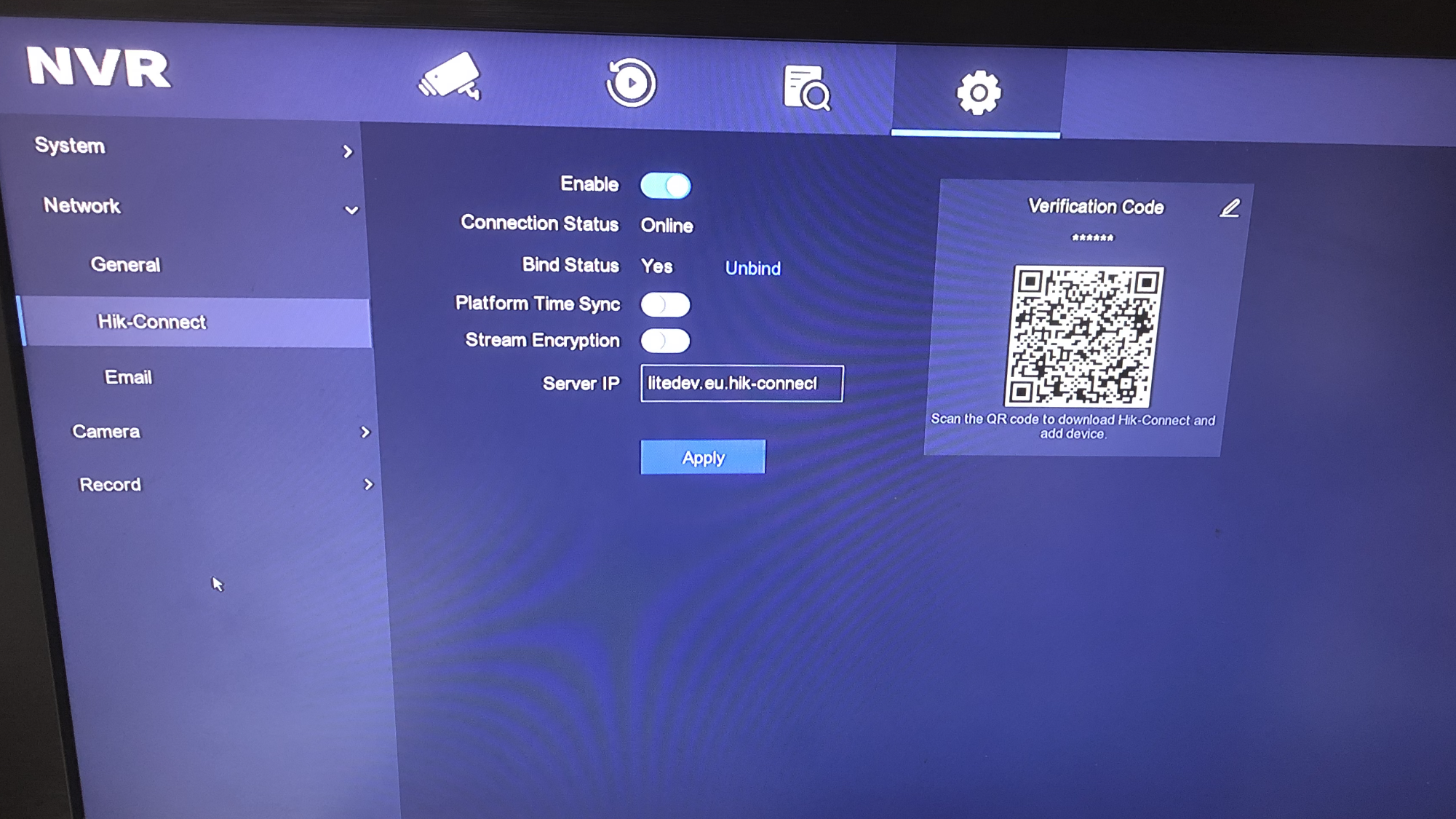

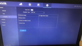

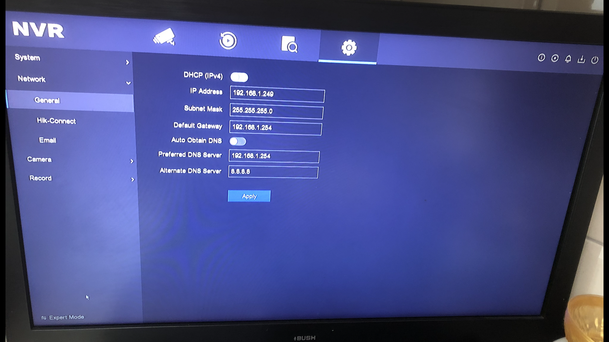

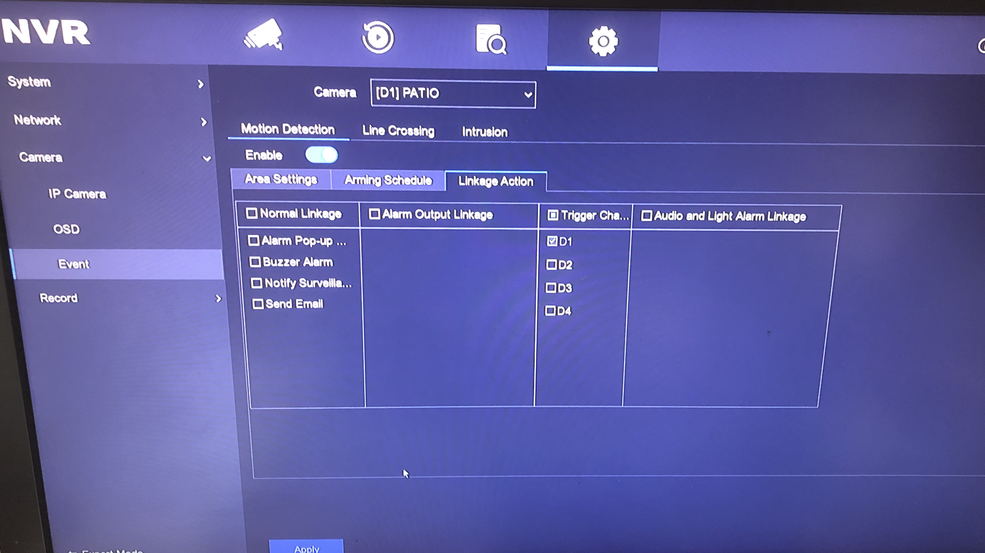

I looked for the info on "Configuration" (cog icon) on the monitor, I'm attaching all relevant screen photos
If you click “expert mode” at the bottom of the first page additional options will become visible on virtually every page.
