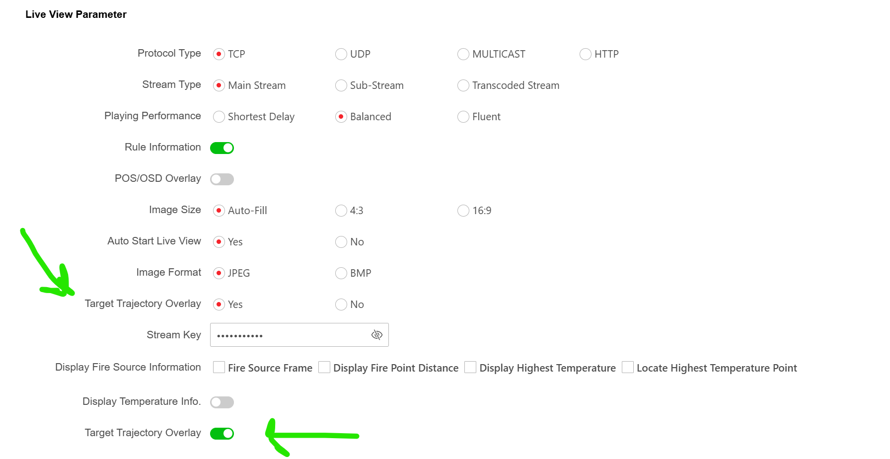

Would that be "Display targets pattern" in the following section? I don't know what is the difference? Hikvision logic?
No it's the Rule information. I think these settings concern only Browsers Live View and Playback. Not iVMS and not NVRs. The Rule information above for example does not affect iVMS or NVR.
And yes they have a very different way of logic and thinking which sometimes drives us all crazy. Unfortunately this is never going to change because there is always an explanation by their side.

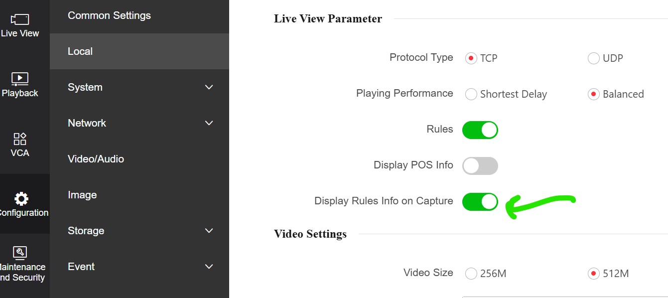

When going into the settings of my colorvu G5, the option is there to record rules to the capture. I tested it and it does show rules, but only on the local SSD streams...

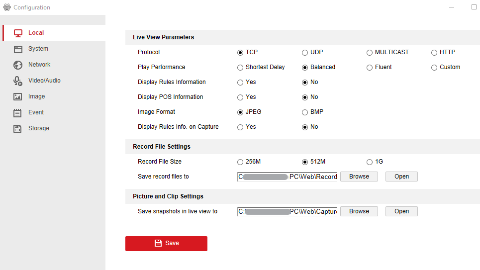

The Local settings concern or at least concerned back on v5.7.15 and before only Browsers playback. I cannot have an opinion about v5.7.17 since I do not use this and will not use if compatibility for VCA records is not fixed.
As you can see below, those settings are disabled for my Hybrid ColorVU, but Rules playback info is OK in iVMS4200 and partially on HikConnect..
