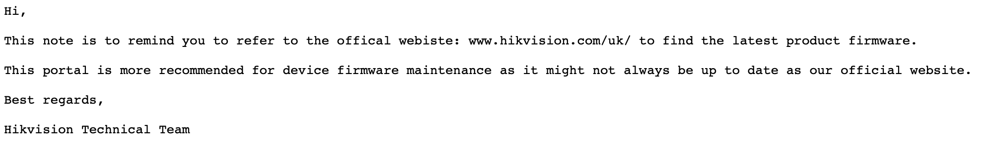

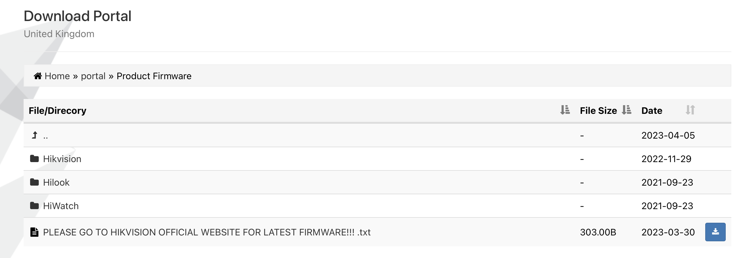

I had an installation to service this morning that was more of a job than usual as there's been nothing updated for a couple of years so I needed to update everything as well as service the system and provide training for a new customer. The NVR is a DS-7608NI-K1/8P(c) and we know from Hikvisions message on the portal, not to use the portal:

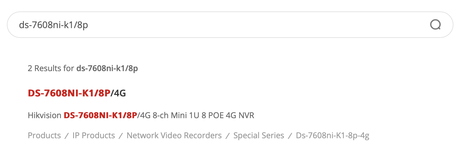

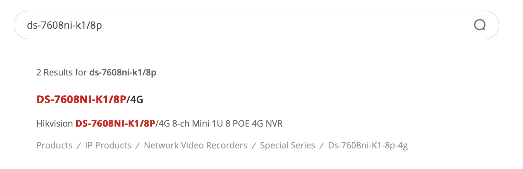

That's fairly clearly an instruction to NOT use the portal. So off to the UK product page I go and type in 'DS-7608NI-K1/8P', which returns:

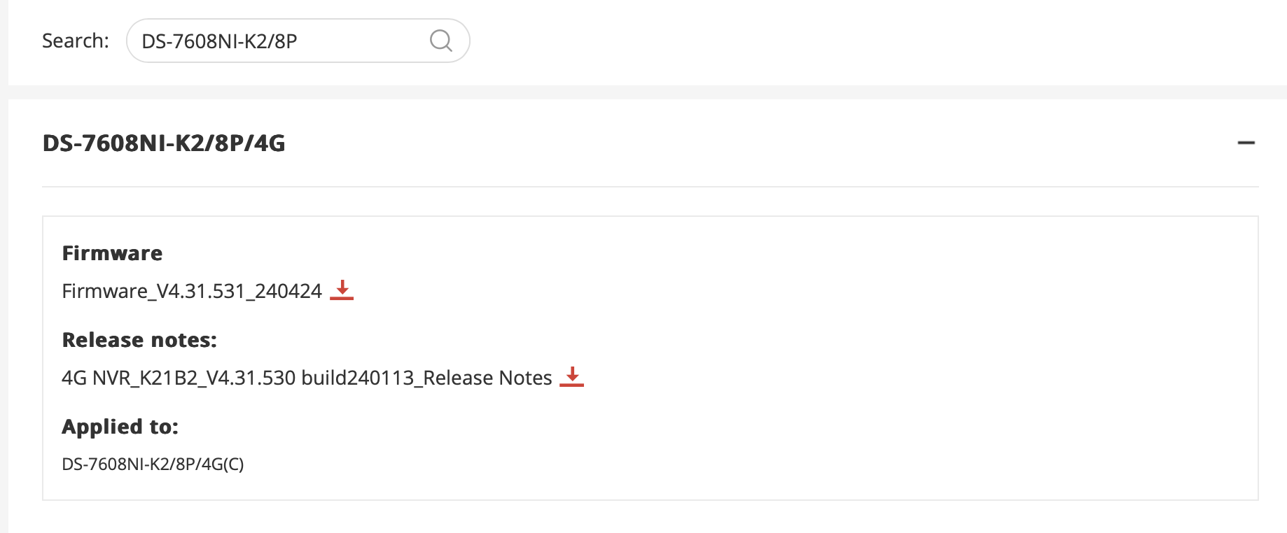

That's no good, it's not the 4G version (uses a different platform) so off I go to the UK firmware download page and type in 'DS-7608NI-K1/8P', which returns:
The same - no good. OK let's try the global download site. That returns:

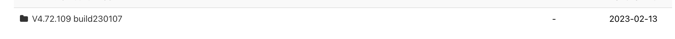

So where I this elusive up to date firmware? I get home and check the UK portal (which we're not supposed to use):

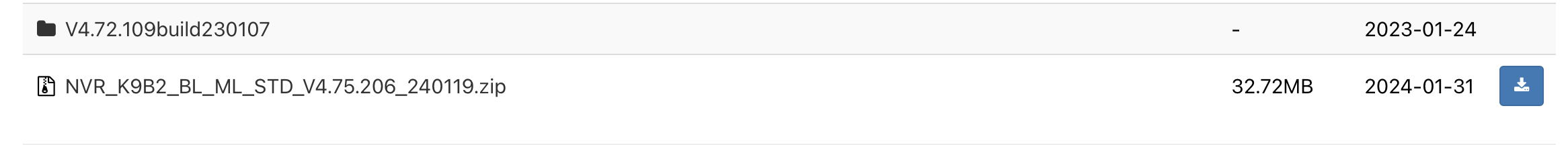

Nope, that's the version I installed to start with. On to the EU portal:
There it is - right where it's not supposed to be up to date and on the site we're not supposed to use. What a s**t show. I wish they'd just bring back the portal and bollocks to going to the product pages.

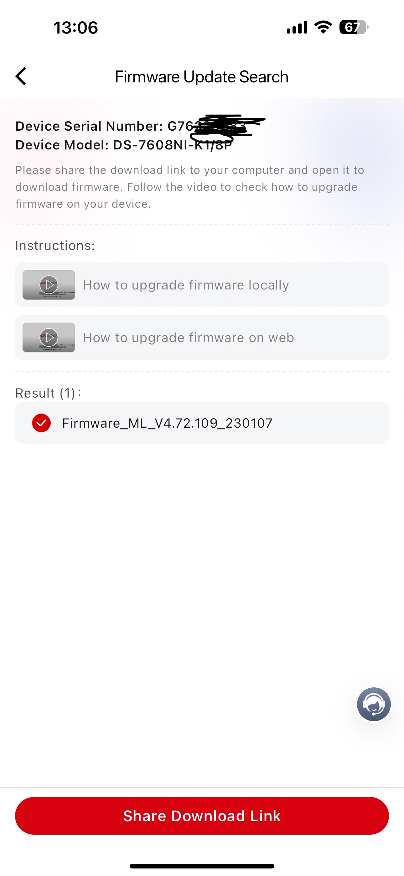

NB - I am aware of recent attempts to use the Hik Partner Pro App to make it easier to find the correct firmware for a device by scanning / entering the firmware:
I wasn't aware of that @Phil. It appears handy so I just checked the serial number of the actual recorder I was updating and referring to in the opening post and keyed in its serial number. This is what Hik-Partner Pro returned:
4.72.109_230107 [insert Family Fortunes wrong answer noise here :)] The Hik-Partner pro app has suggested a version that is one year out of date!

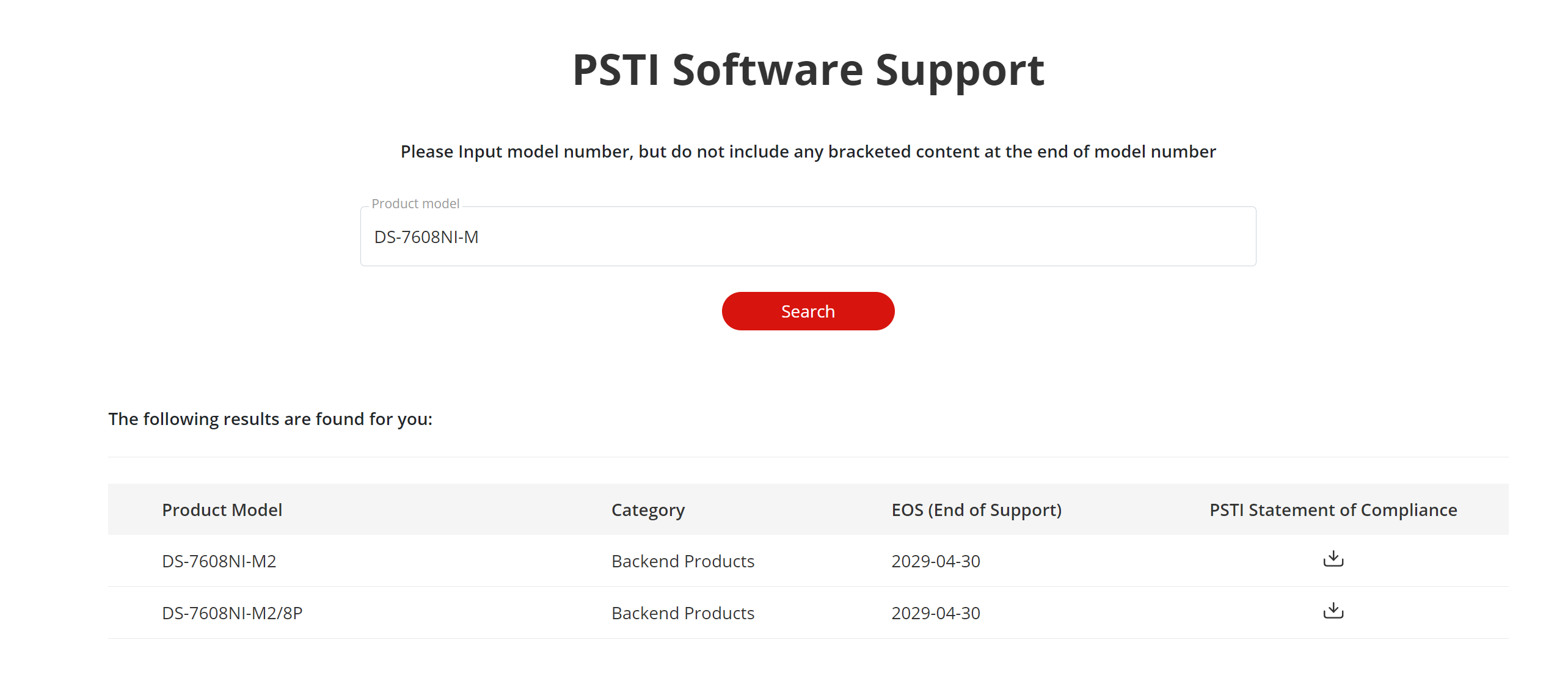

Hikvision have just released a statement on their compliance with the new UK PSTI Act (attached).
And also provided a link to a new product search service where you can check the 'Best Before' / end of support dates for each product:
PSTI-Software Support
We've only just seen this.
I am sharing it quickly.
It looks as though the end date for a lot of products is currently 5 years from now.
Since many of those products are current, and they have pledged 5 further years from discontinuation, we guess that date will remain 5yrs from now until at discontinuation it gets fixed and then the duration begins to reduce from 5yrs down.
Kudos to Hikvision for getting this in place quickly.
Here's a sample screenshot from the Software Support search:
(it's a bit fickle, you have to accurately enter a correct model number in the proper format)

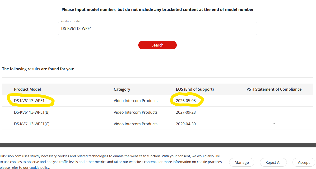

Hi @Phil
What is the difference between EOL and EOS?
We usually see on support page an EOL indication and there is no new firmware after that. Does EOL also means End of Support?
I see no new firmware for my old DS-KV6113WPE1(A)
EOL = End Of Life (this generally means when something is no longer sold)
EOS = End Of Support
I think that committing to 5yrs support after EOL means that if say new firmware is needed to ensure a security patch, then a device that has not yet reached EOS will be patched.
Beyond that date, when EOS is reached e.g. 5yrs after EOL, then I suppose the recommendation is to replace the device with a newer model.
