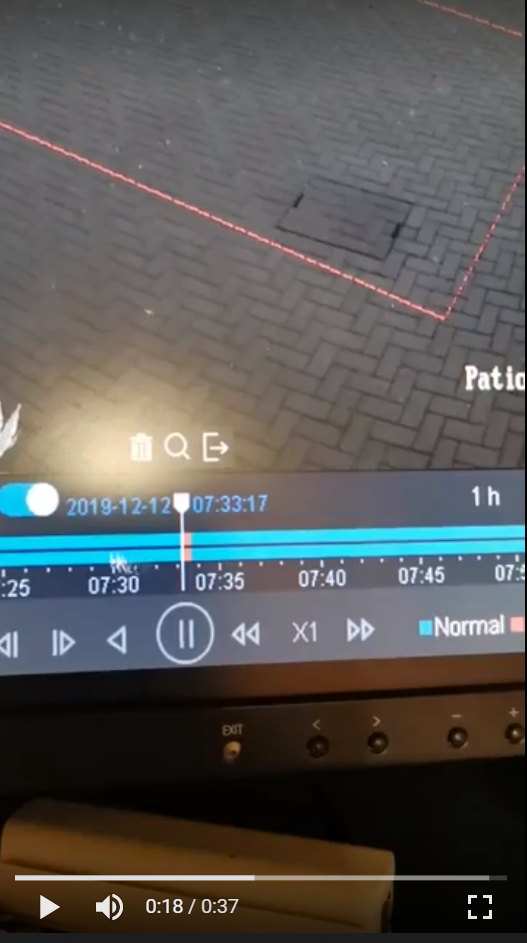

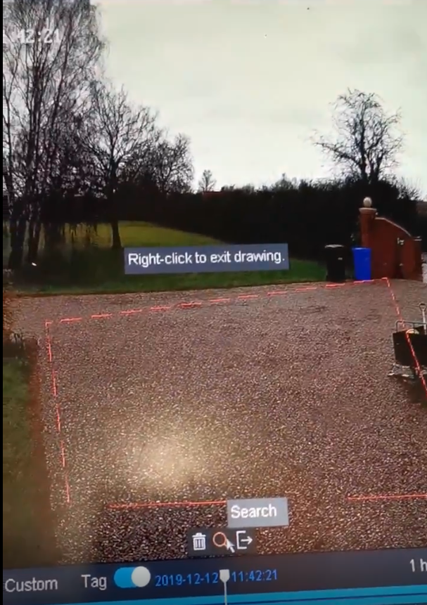

I have two identical IP cameras on my NVR.
Both have intrusion detection and line cross turned off for alerts (not enabled).
But on one of the cameras if i go on the NVR and do a 'smart' search for either line cross or intrusion where ever i want on the screen it will search all recordings files for detection. Other camera wont do it.

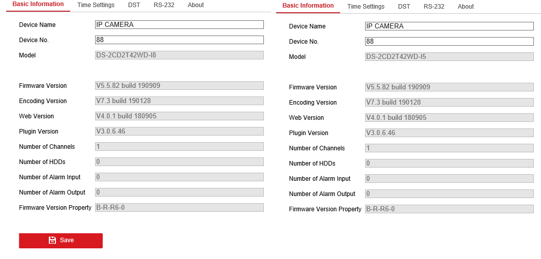

What models are the 2 cameras you have? it is probably just an age issue with the newer camera supporting the smart search feature. Smart search is not actually linked to the Event settings, you can read more about the different types of playback in this forum post:

Please see attached photos. These are the two cameras. One works one doesn't
I've also just bought a new "HikVision DS-2CD2T46G1-4I/SL 2.8mm" 2019 model and that one doesn't let me do NVR smart search,

Apologies, I missed your post before the Christmas break. Any of the current G1 Family cameras will definitely support Smart Search, any camera with 2xx3 or 2xx5 in the product code are G1 cameras.
The G1 equivalents of the camera models you currently have would be the 2T45FWD-I5 4MP Bullet Camera or the 2T65G1 6MP Darkfighter Bullet Camera which is available in both the -I5 and -I8 options.
