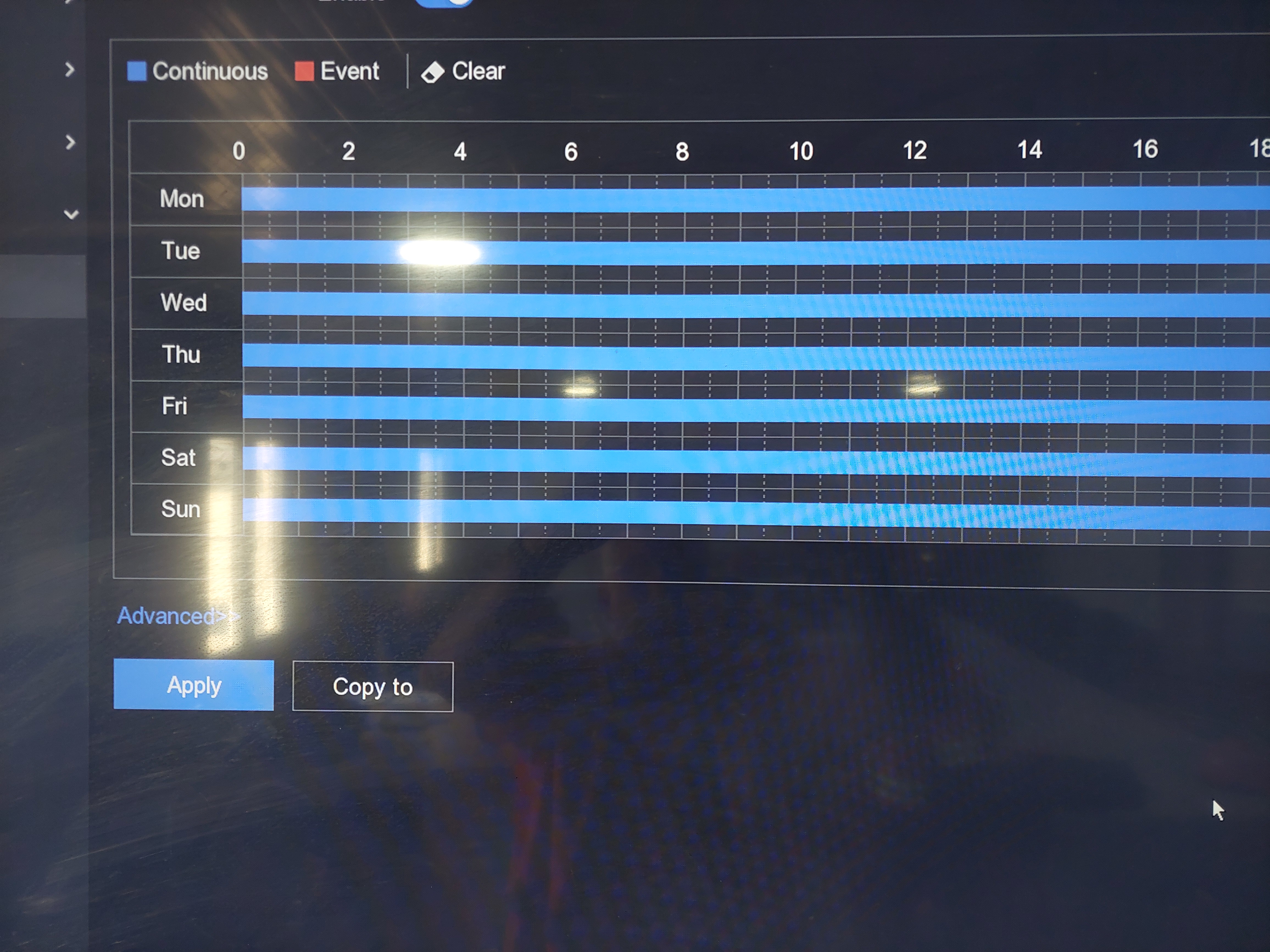

There is a problem with recording on the iDS-7216HQHI-M1/S dvr.

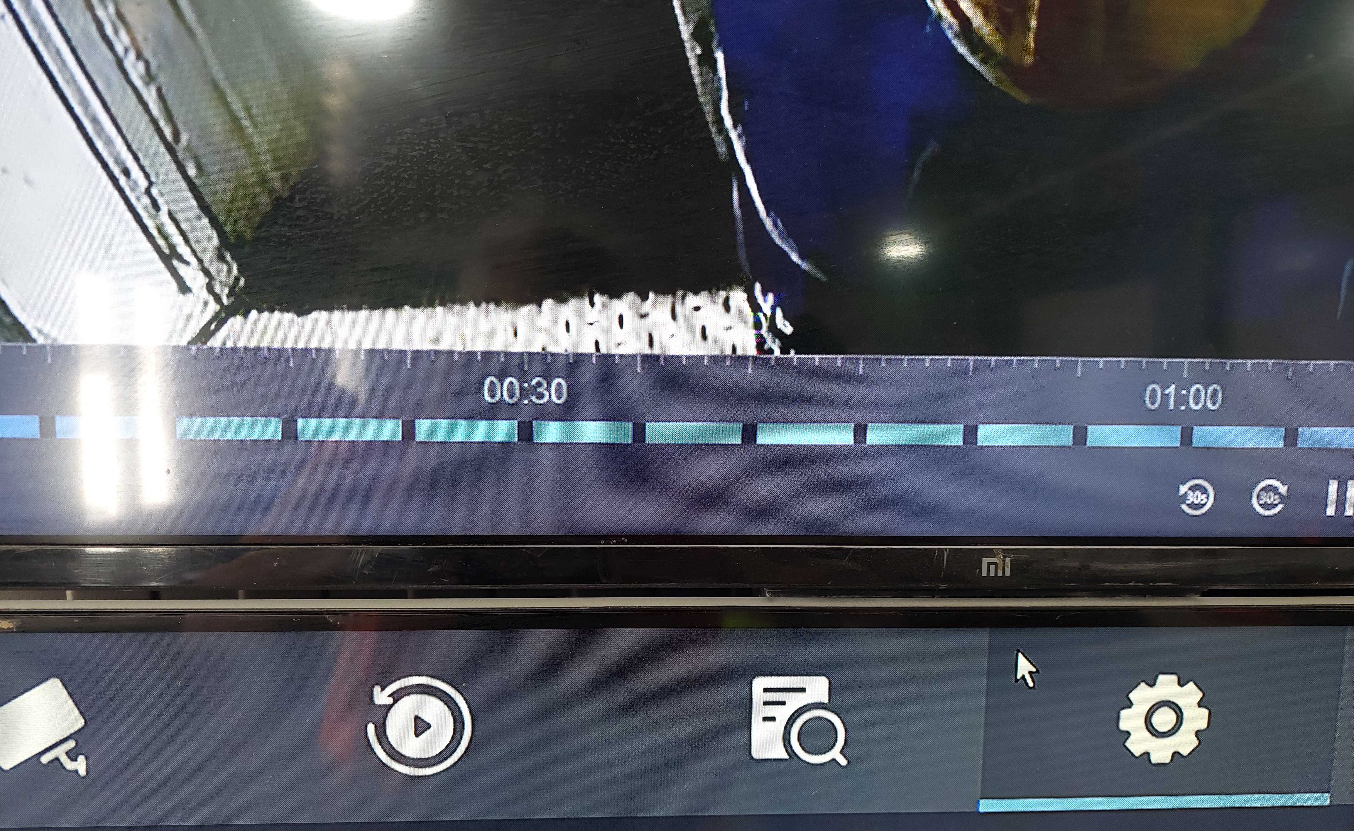

It is set to record Continuous and records intermittently (picture attached).

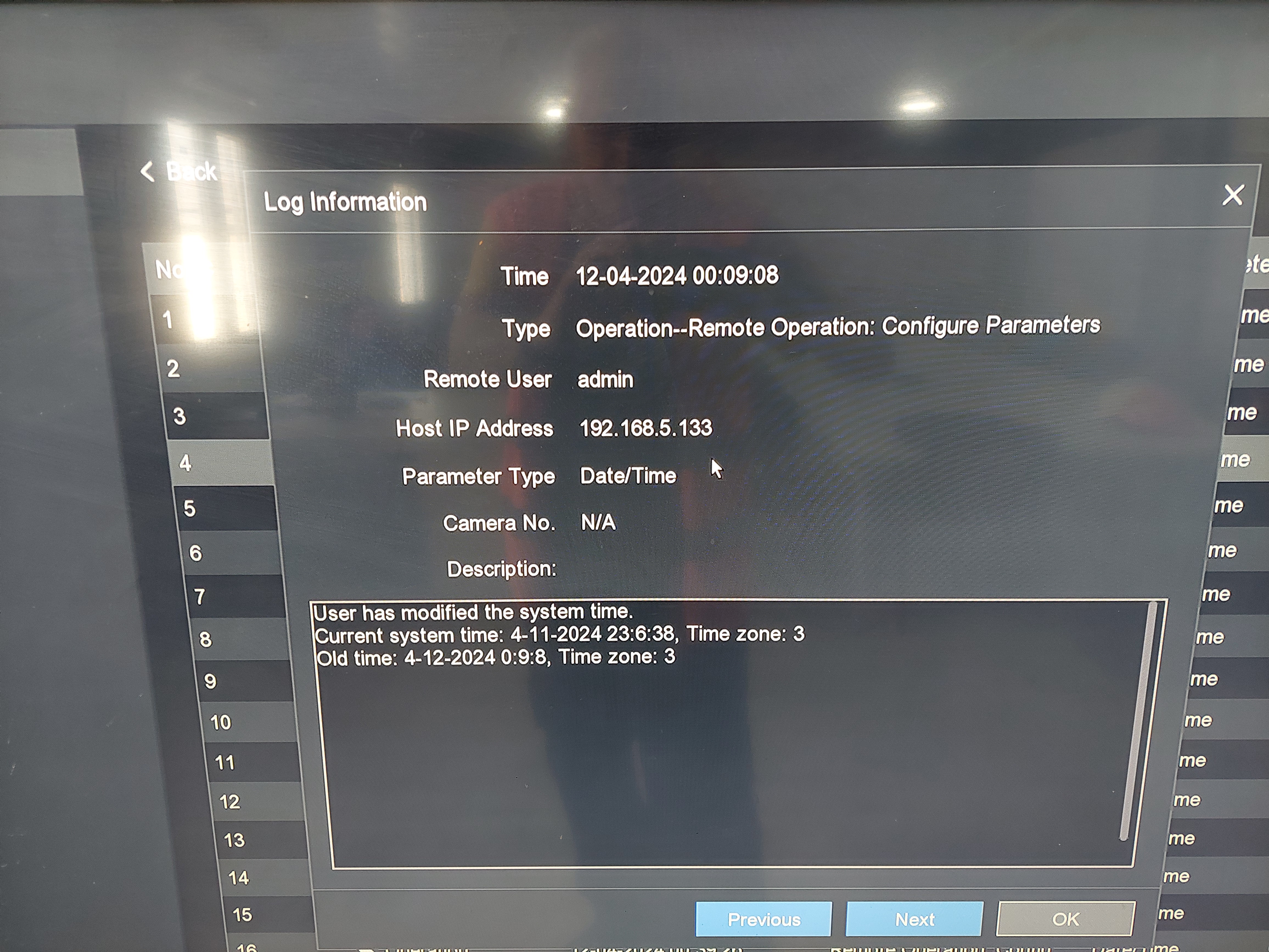

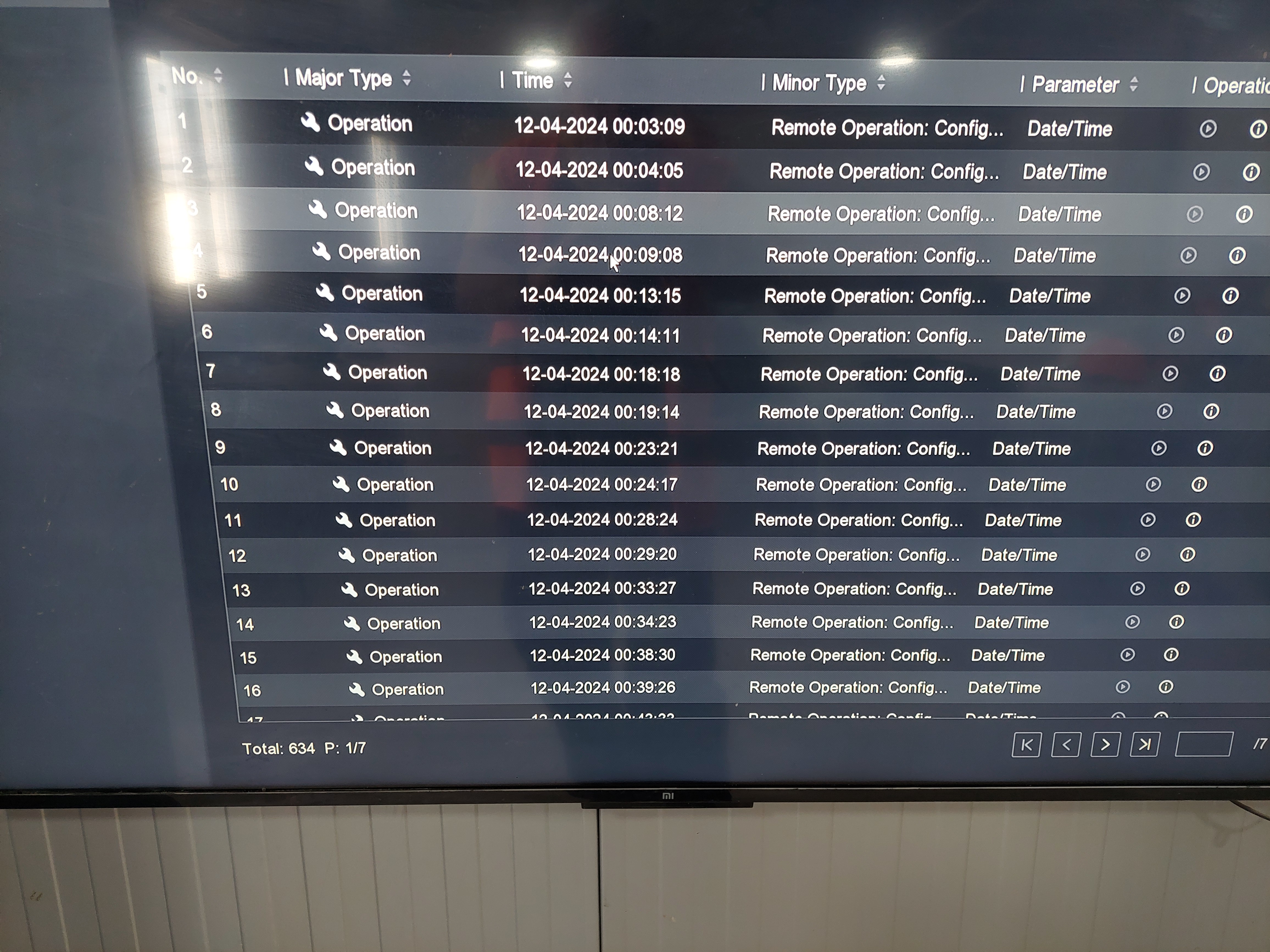

One of those two nvrs (192.168.5.133) may be causing the problem: User has modified to system time. Attached: photos
How can I turn this off, disable...

The configuration to use multiple NVRs is not clear from your description. The issue seems to be that one of the NVRs has the date/time misconfigured (one day out hence the switch from April 11 to April 12?). The NVR doing the recording checks each 5 minutes, sees that the time on the source camera/NVR does not match its own time and causes your problem (this is a best guess without seeing the full configuration but it seems to be a simple misconfiguration/mistake). You can't have a DVR or NVR with its system time not synchronised with the source that it's recording. You need to go through each recorder and set the system timezone, time, date, daylight savings the same and ensure that they both are configured to sync to the same NTP server.
