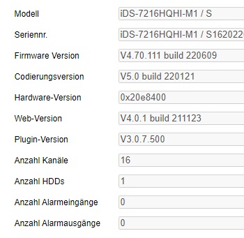

Hello,
I'm using the IVMS-4200 software and for the past 2 months the client software tells me that there is new firmware available for my recorder.
I cant disable the popup, and I can't update the NVR.
I tried to manually upgrade to the newest (Firmware_V4.71.111_231206) via the web interface, but its not working.
I assume because it's for the M1- S/ C, and I have the M1- S, but there is no newer firmware for the M1 - S.
What can I do or what did I do wrong?
iDS-7216HQHI-M1/S

Hi @DebraW
Sorry, but I believe this is just a glitch with the software, we have seen similar before.
You are running the latest firmware and as far as I am aware there is no way to permanently disable this pop-up, you will have to just keep closing this pop-up when you open the client software (it is most likely just a glitch with the latest version of iVMS that will hopefully be fixed with a future update).
