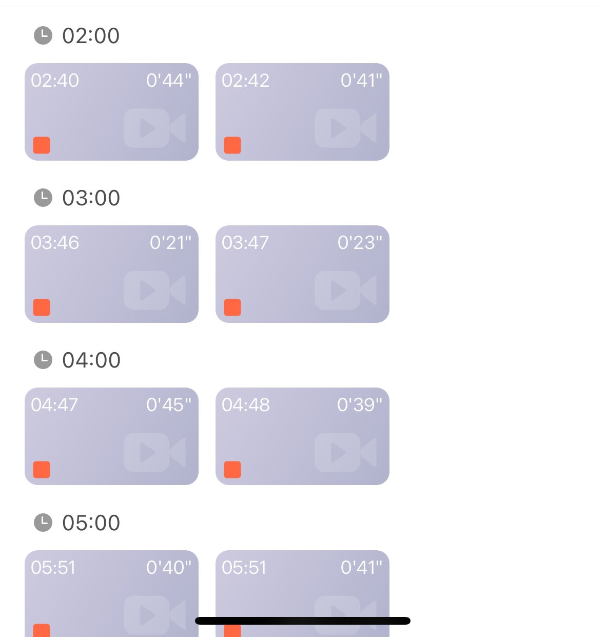

Recently, I installed an owl box at the back of my garden.
This phenomenon has been happening since i put the owl box. According to the recordings, it occurs once every hour.
