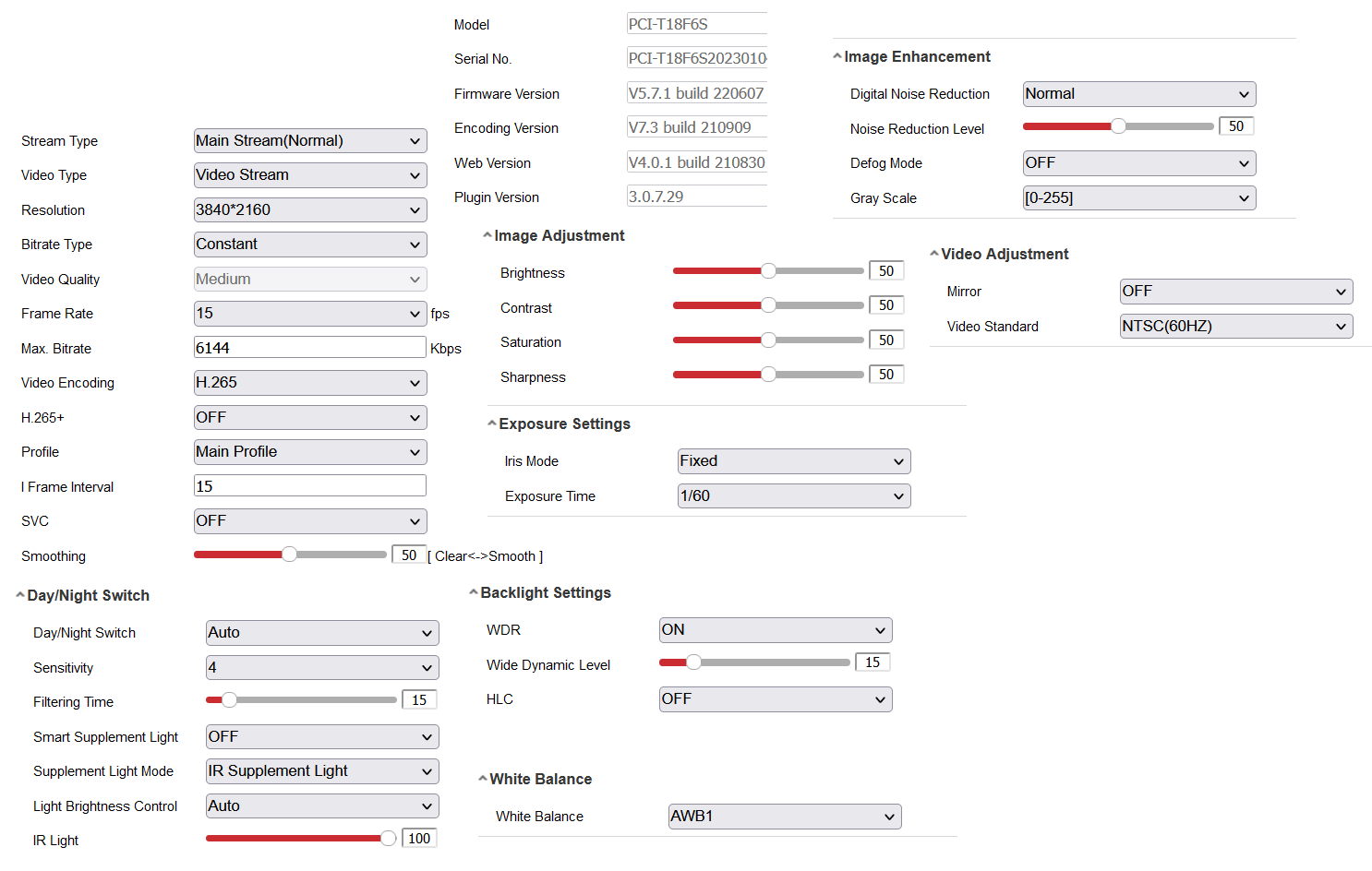

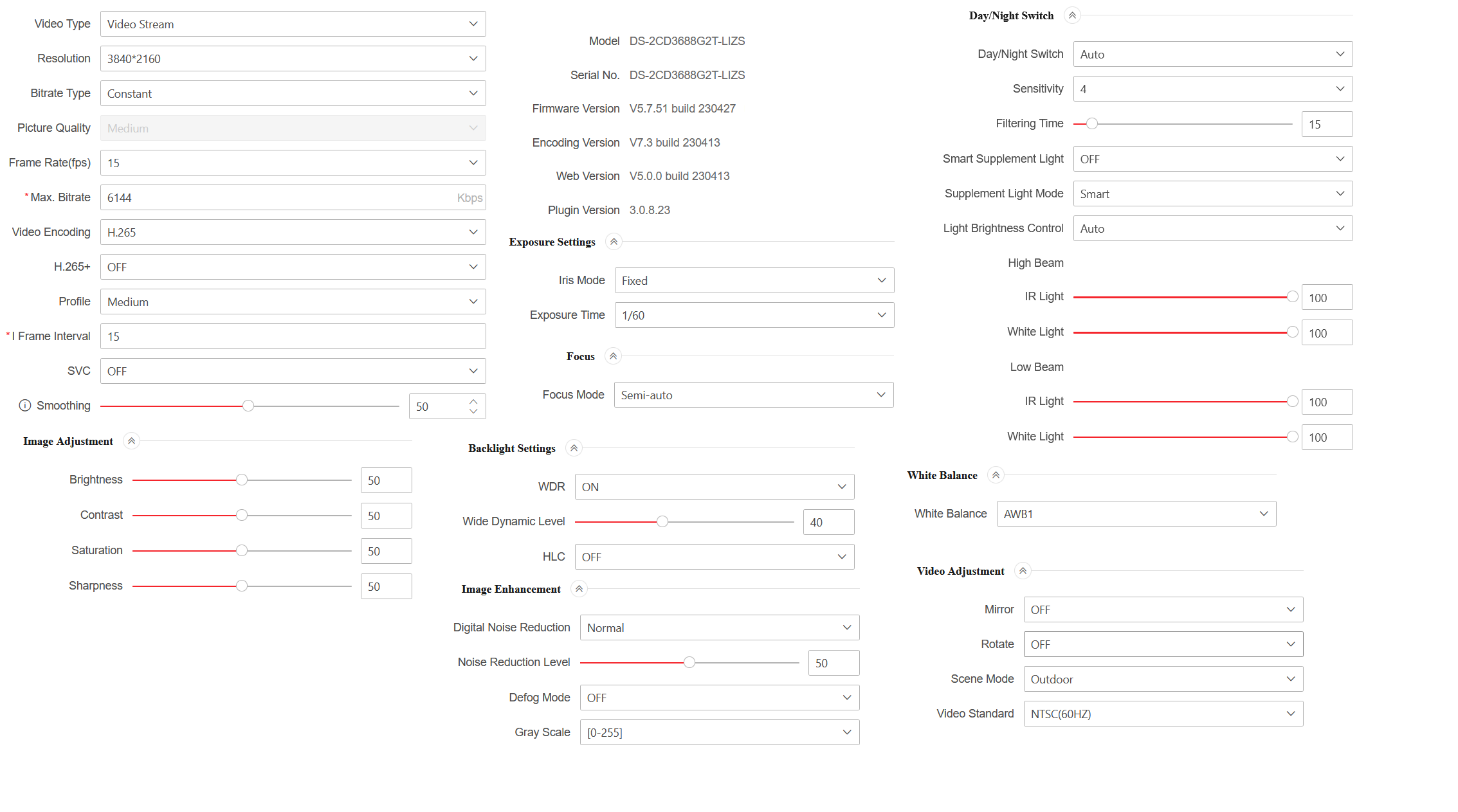

just posting a night video of PCI-T18F6S and DS-2CD3688G2T-LIZS (not sure what would be the equivalent around you)
first half is PCI-T18F6S
second half is DS-2CD3688G2T-LIZS
4k recording, 15 fps
keep in mind that to cut the video i did post processing and youtube did it own post processing, it's not the original video
there is two layer of video quality downgrade

The second one (3688G2T) we don’t have here in UK. When we first started talking about the Hybrid light models, it was that model - 3xx8G2T-LIZS that was seen in the firmware release notes indicating its imminent arrival, but it was confirmed we won’t get that model. Being a 3 line camera, that’s considered an ‘ultra’ as opposed to the 2 line ‘pro’ series. The nearest we have will be the model mentioned (2387G2H-LIU), I’ll have to cop a look at the data sheet for yours to compare specs.

if interested, here is the settings for both
