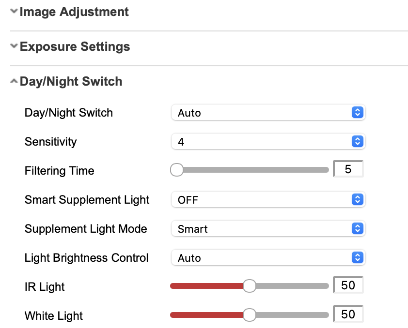

I set Exposure time to 1/50sec to help avoid motion blur. I switched to H265, Video Quality 'Higher', Max Bitrate 16,384 (it doesn't need to be so high but the M series NVR will do that for all of my cameras without issue)

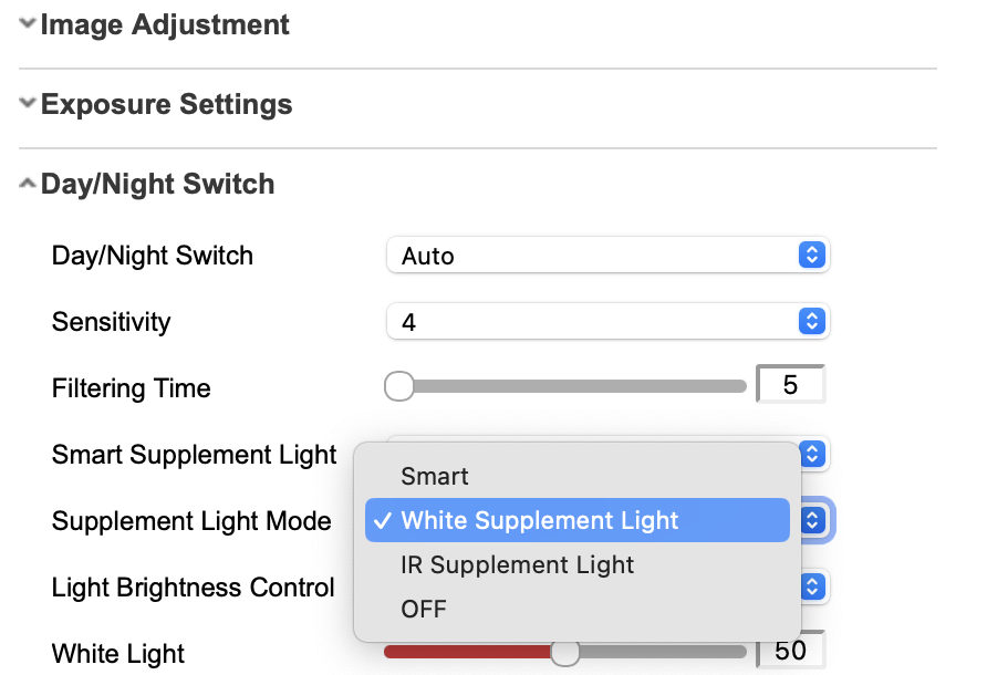

The images below show the additional options in the menu for the modes. As shown, you can alter the levels of the infra red and white LED illuminator separately:

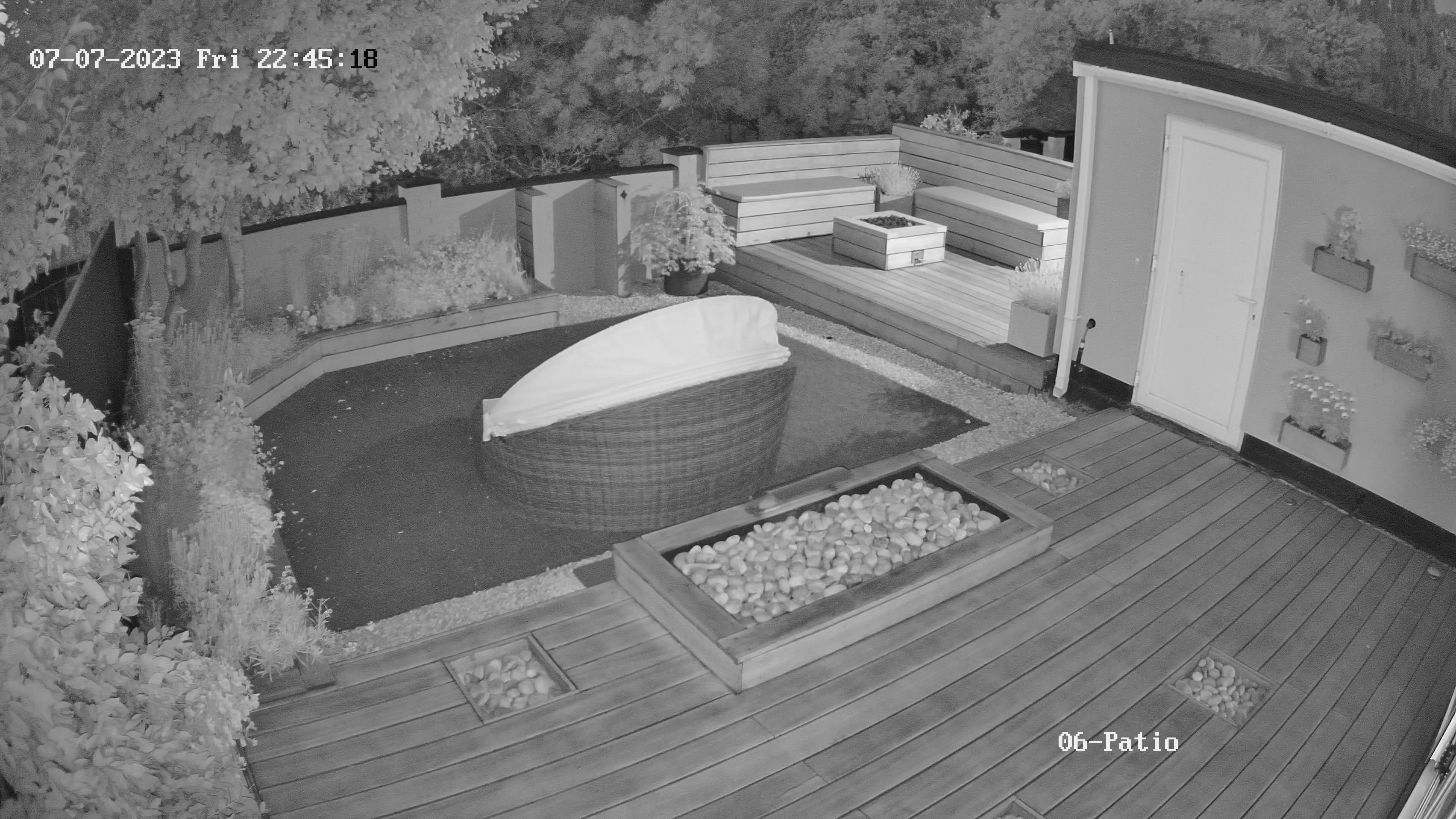

The image below was taken with my iPhone 12 Pro (exposure 1/15 sec) and shows the scene, one hour after sunset from the perspective of the camera. It's fair to say there's not much ambient light:
Without an event active, with the camera using Infra Red. The camera provides a well exposed image with no obvious darker corners/vignetting. Surprisingly the illumination is better than the previous Ultra series camera. I say surprisingly, as the Ultra camera had dual high and low level infra red LED's:
After triggering a motion event, the camera switches into Colour Mode and uses the white LED illuminator. As well as facilitating the exposure, the activation of the white LED is a good visual deterrent:
Again the image is well exposed edge to edge, with no obvious darkening in the periphery of the image.
The switching from infra red to colour is almost instantaneous following the event trigger - around a second. I have a security light (disabled for this test) that usually provides illumination if someone were to come into the garden. It's important to note, that while the security light provides great illumination and would switch a standard camera back into colour; that switchover takes 5 seconds as the filtering time cannot be reduced below that on any Hikvision camera. When I had an intruder in the garden a few years ago, they triggered the security light after climbing over the fence on the left of the image. However the camera didn't switch to colour until they'd walked across the field of view and were on the deck behind the garage. This Hybrid light model would've switched immediately, providing useful colour detail.

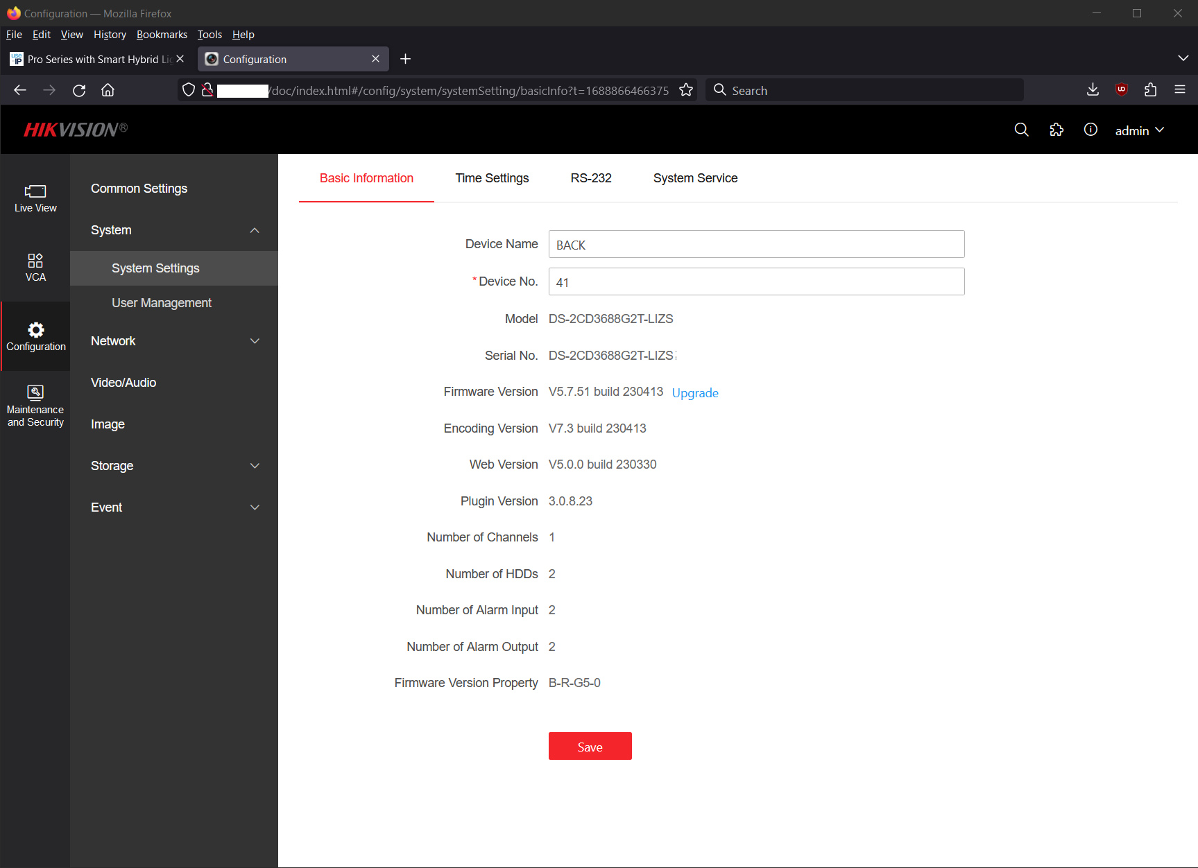

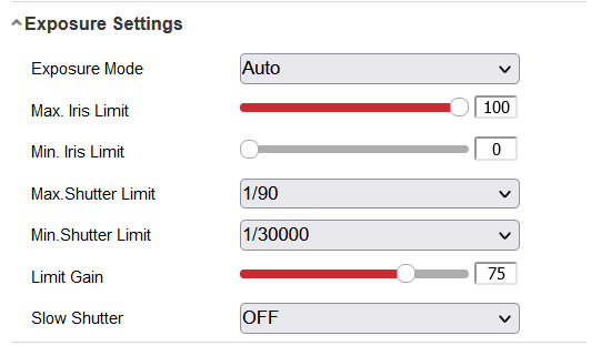

on my side I got a DS-2CD3688G2T-LIZS, pretty much the same thing except varifocal and a bullet form
firmware is different, current one seem to be ipce_h_g5_en_std_5.7.51_230413, the major difference is a completely different web interface and it use HEOP 2.0 (i will take some screenshot for the curious)

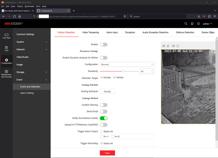

2 issues that seem to be affecting me (and it look like the issue is also present on colorvu g3) is;
upload to ftp will upload one lower resolution picture on top of the configured one (1080p instead of 4k)
WDR, for me the "real" maximum value is 40, putting it to 41 look like 100, auto mode also put it to 100
so I kind of have 3 mode; off, 1 to 40 or 41+ = 100 (auto mode included)
going to include screenshot / picture when i can :-)

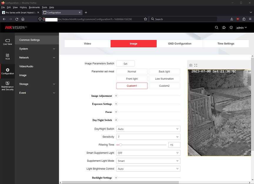

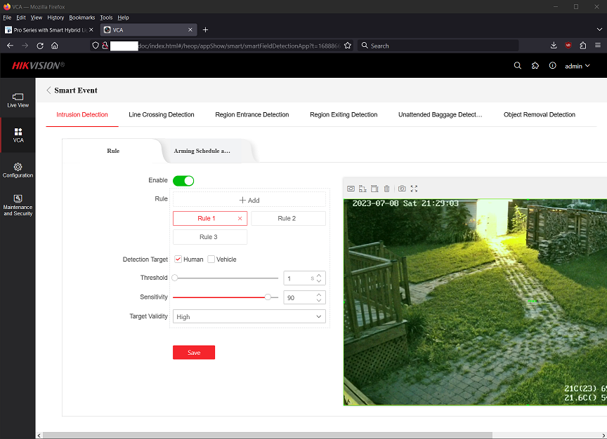

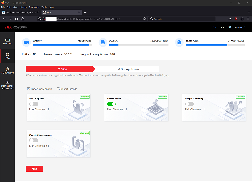

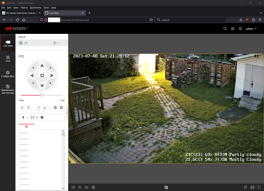

here the web view, i will put picture later
if you want specific screen, let me know

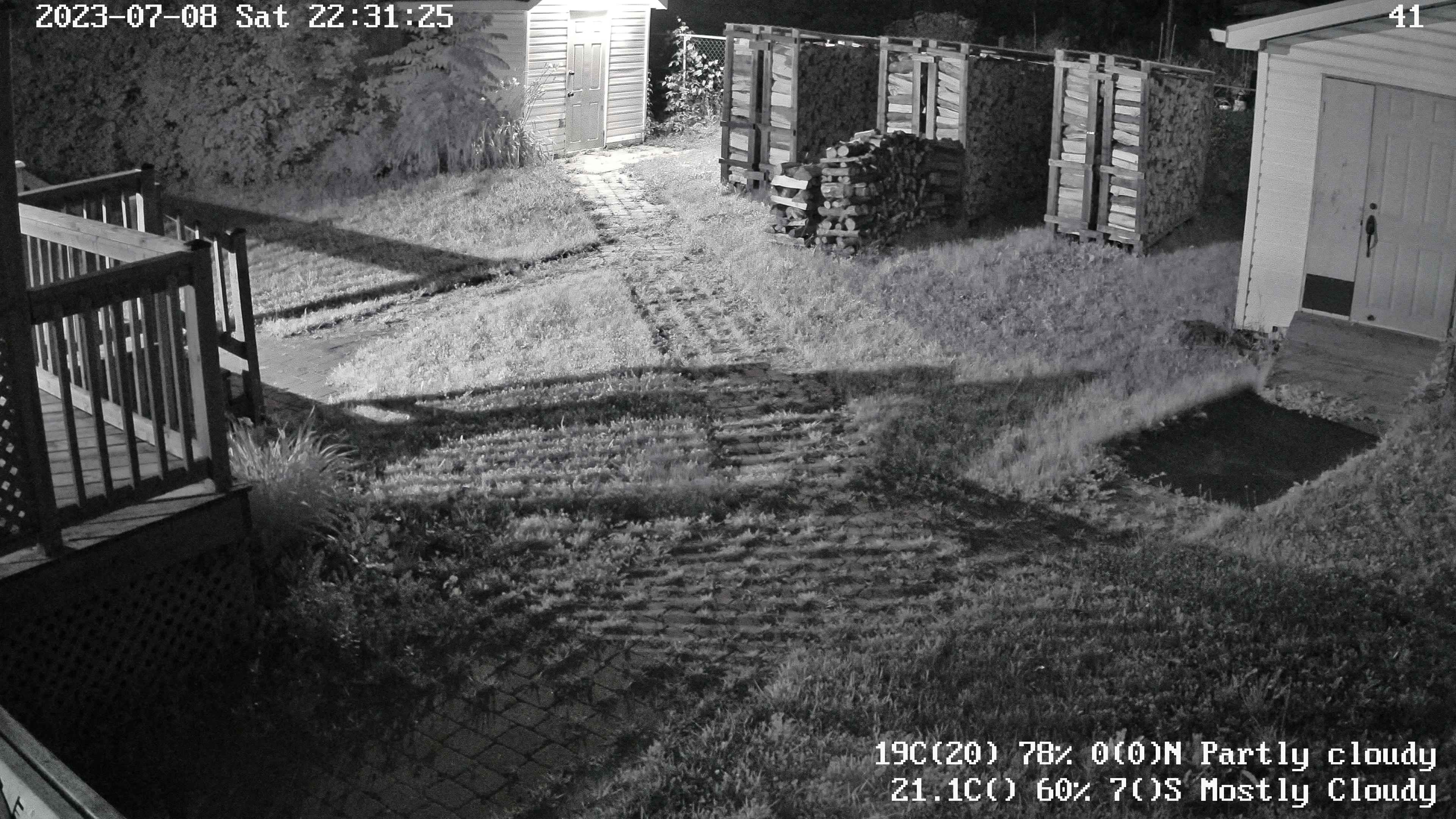

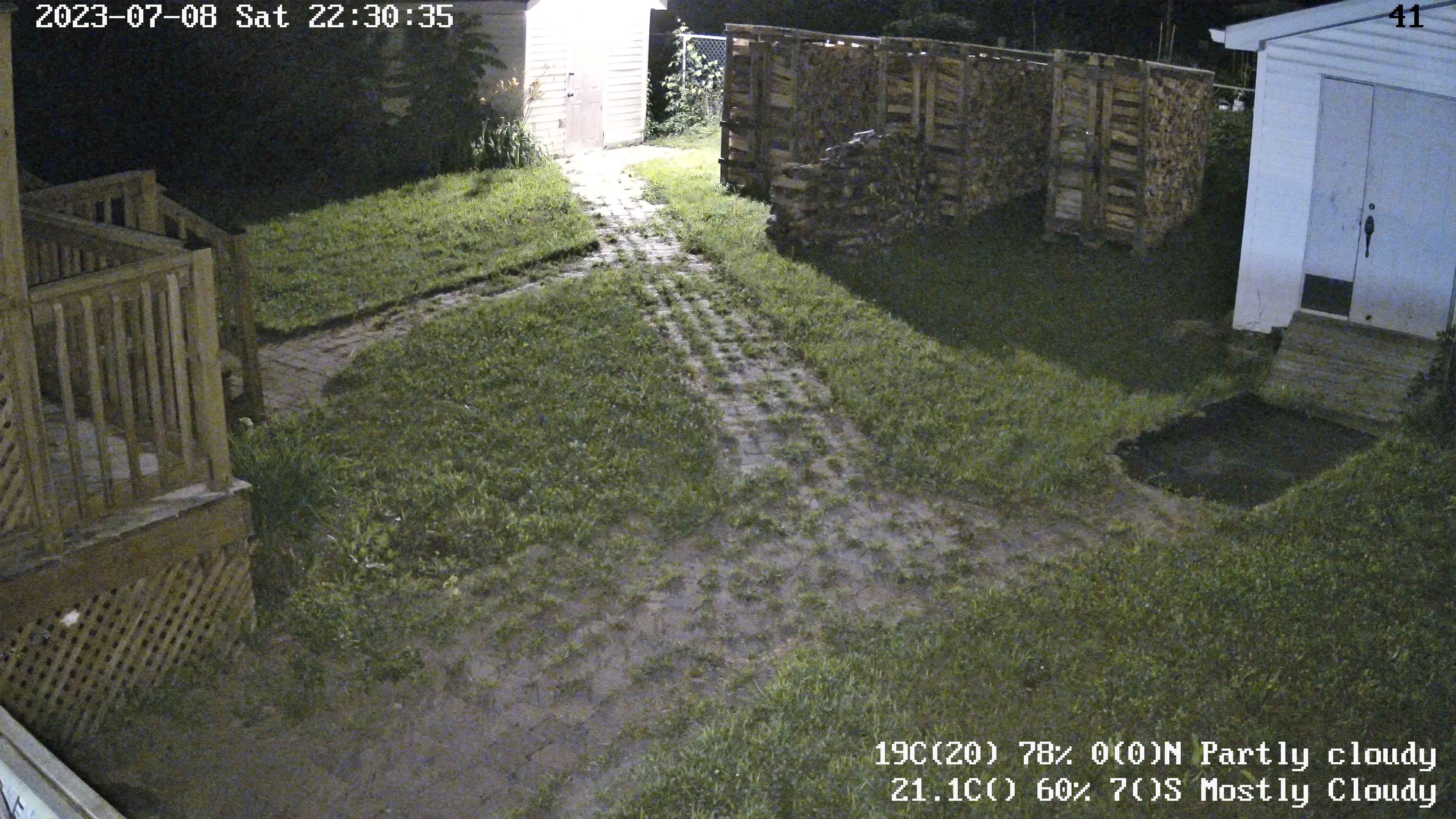

the door at the end of the walkway is about 17 meters / 55 foot from the camera, this is not close
look at the filename for light context
this is 1/60

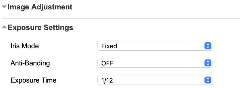

i didnt know about the gain bug, i will play around on mine and see if it's the case
It’s not a bug. Auto Day/Night has always worked that way. During darkness manually switch camera to ‘Night’, then manually drop gain to a low level so that it darkens the exposure. As soon as you switch back to Auto, the camera will remain in Night but ramp the gain back to 100.
The WDR thing you mentioned I’ve noticed before. Auto WDR regardless of level switches on WDR at a higher level. Again it’s not something specific to these models.
Yours is a 3 line (ultra series) camera and is not yet available in the UK.
oops your right about the ultra model, I live in Canada, your model isnt available for me, how weird is this? I would gladly get that turret for another spot but I cant
I do have a camera with gain control with auto mode, look at the filename for the model, this is showing up while night/day switch is under auto
I can change the value at night and it get properly applied

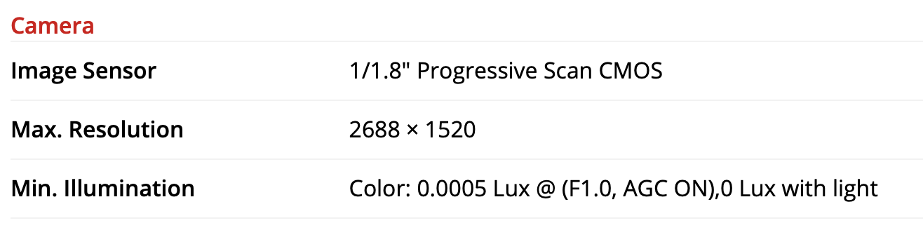

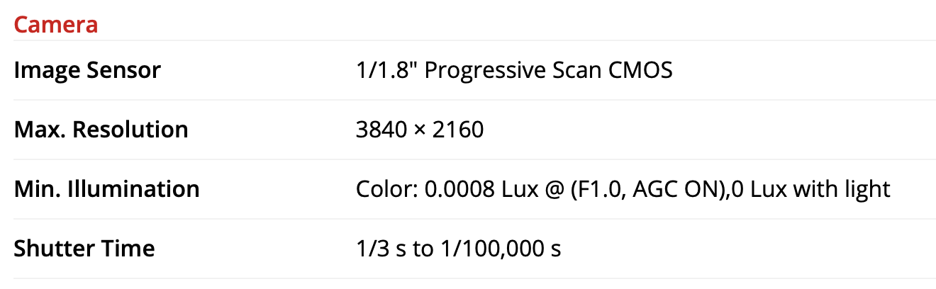

One thing I have just noticed in the specs is that while the 8MP Hybrid model uses the F1.0 aperture lens from the 8MP ColorVu it does not share the same 1/1.2" sensor; it's using the 1/1.8" sensor from the 8MP Darkfighter and so is less sensitive in ColorVu mode than the standard model. That seems a little unusual as the data sheets show that both 4 and 8MP versions use that same smaller sensor at 1/1.8"....
DS-2CD2347G2H-LIU - 4 megapixel
DS-2CD2387G2H-LIU - 8 megapixel

One thing I have just noticed in the specs is that while the 8MP Hybrid model uses the F1.0 aperture lens from the 8MP ColorVu it does not share the same 1/1.2" sensor; it's using the 1/1.8" sensor from the 8MP Darkfighter and so is less sensitive in ColorVu mode.
for my camera it's the first thing i noticed and mine is a little bit worst with an aperture of 1.2 instead of 1.0
for my use case, i needed at least 6mm and unless i missed one, my only choice was a varifocal one and i didnt want a dome
