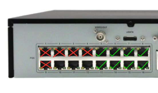

This new NVR was set up using the same settings as my previous model although I now only have 9 cameras connected. (A combination of Hikvision Turret and Cube models) The 9 cameras are connected to the PoE ports D1 to D9. Within a few minutes of getting the system up and running I started to notice certain cameras were pausing intermittently on the live view display. This pause would last anywhere from half a second up to 5 seconds and then the view would catch up again. Also, after leaving the system running for several hours I was seeing some of the cameras dropping out altogether for a few seconds before resuming their picture. These picture drop outs seemed to be occurring completely randomly. After a few days I looked at the reporting log files under Maintenance / Log Info / Exception and several instances of 'IP Camera Disconnected' were showing in the list. Again these disconnects all seemed to be occurring at random times. One day I got 32 camera disconnects and the following day just 2. An average seems to be around 16 to 20 camera disconnects in a 24 hour period.
I left the system running for about a week and the same pattern was repeating with constant camera disconnects being reported. However, after further investigation I noticed that only the cameras on D1, D2, D3, D4 and D9 were suffering from these disconnects. Cameras on D5, D6 D7 and D8 never reported any disconnects at all. The same cameras which were disconnecting are also the ones suffering from the live view pauses. D5,D6,D7 and D8 never pause during live view.
D1 has a 4K camera connected and so does D6 and D7.
Today, while trying once again to solve this problem I decided to swap cameras between D1 and D7. Both are 4K cameras, one of which is suffering disconnects (D1) and the other which isn't (D7). A short time later I observed the camera now connected to D1 to be suffering the live view pauses but the camera now on D7 was working fine. This pointed to a problem with D1 PoE port and not the camera.
The next step in my investigation was to remove the camera from D1 and plug it into the D16 PoE port. That was about 4 hours ago now and since doing that I haven't seen a pause from any of the 9 cameras in live view or any camera disconnects reported. I know it's only 4 hours but I can tell that the system is running much more smoothly now since removing the camera from the D1 port.
