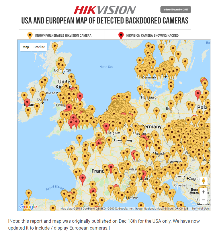

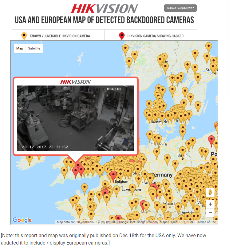

IPVM.com created a clever little program that scans the internet, finds hacked HikVision cameras, and grabs an image from them.
There are a LOT of compromised cameras!
Snapshots below.
You can read more here.
So, please, please, please - check your firmware and update your cameras and NVRs to the latest firmware version available.

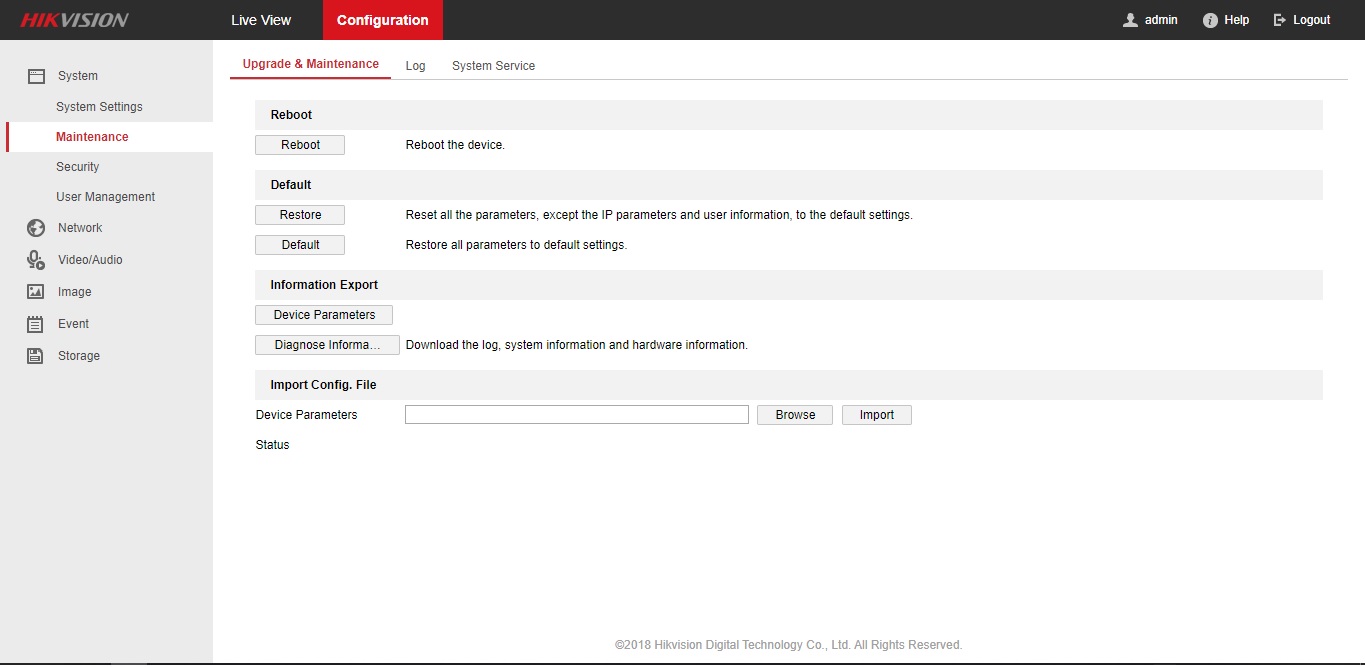

Hi, may I seek some advice as to how to update my firmware please as I'm having a few issues. I've recently bought/installed my camera and can log onto it via the web interface, but can't see an upgrade firmware option in the Maintenance tab. My camera is a DS-2CD2343G0-I and is currently running firmware V5.5.53 build 180622 and I'm trying to update it to V5.6.3 build 190923. I can see the camera video output via my android phone via Hik Connect and can also see the video output via my Synology DIskstation but can't see the live view via the web interface. I have a second camera (same model) which I installed a few weeks ago and have successfully updated the firmware on that one a few weeks ago, so I have done the process before, I just can't see how to get this one to upgrade?
Ah ha! Solved my own problem. I was using Google Chrome web browser and have just tried Internet Explorer and I have the upgrade button! Cam in now upgraded and is showing properly in google Chrome, including the live view bit.

Thanks for letting us know that you solved it issue, always more satisfying when you do so yourself too!
