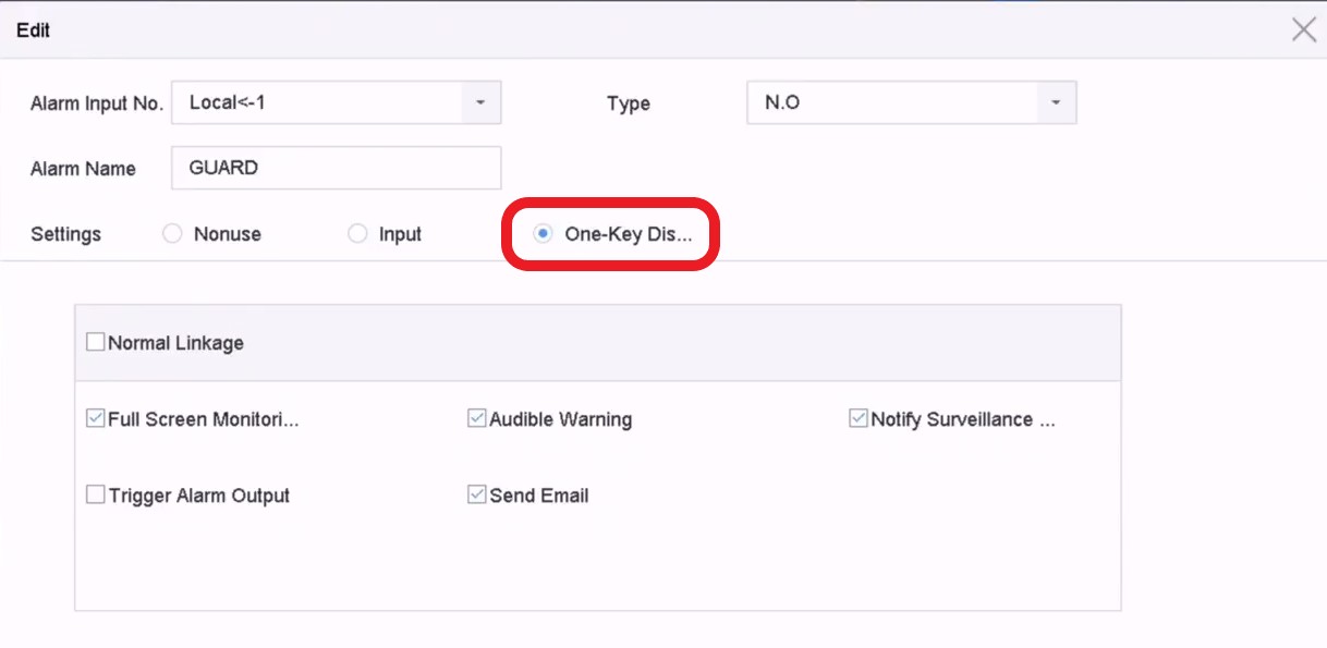

I know this thread is a bit "mature", but one-key to disarm the entire CCTV system is a great idea. As I read this, you use one of the NO I/O contacts on the back of the NVR and run a pair of wires to perhaps a keyswitch located at the front door. So you can disarm during the day. Well, why not purchase one of those wifi 13amp plug tops and plonk it in a box alongside a relay and voila! remote control. As in "ooops in my rush to get home after a hard days work I forgot to arm the system"?I've recently had to ask Hikvision's technical team about this to advise a customer with a similar query. There seems to be very little online about One-Key Disarming compatibility among the different NVRs.
Hikvision have told me that the feature is unique to NVRs running the GUI V4, so only the I-Series at current. They did not comment on whether it will be available on K-Series NVRS when/if they release V4 for them.
From my understanding, you can only access the feature through an NVRs local GUI and not through browser/iVMS-4200. To turn one-key disarming on, you'll need to go to:
System > Event > Normal Event > Alarm Input
Set up the desired alarm input, here's our guide on how to set up alarms on Hikvision NVRs.
Once done, check the One-Key Disarm box, as shown below, and then Save.
