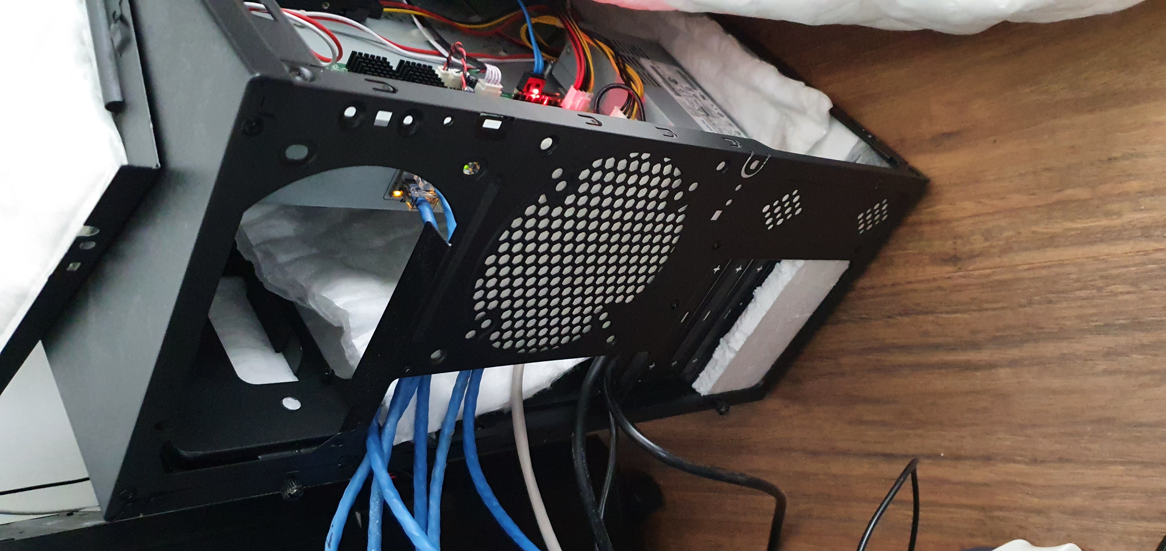

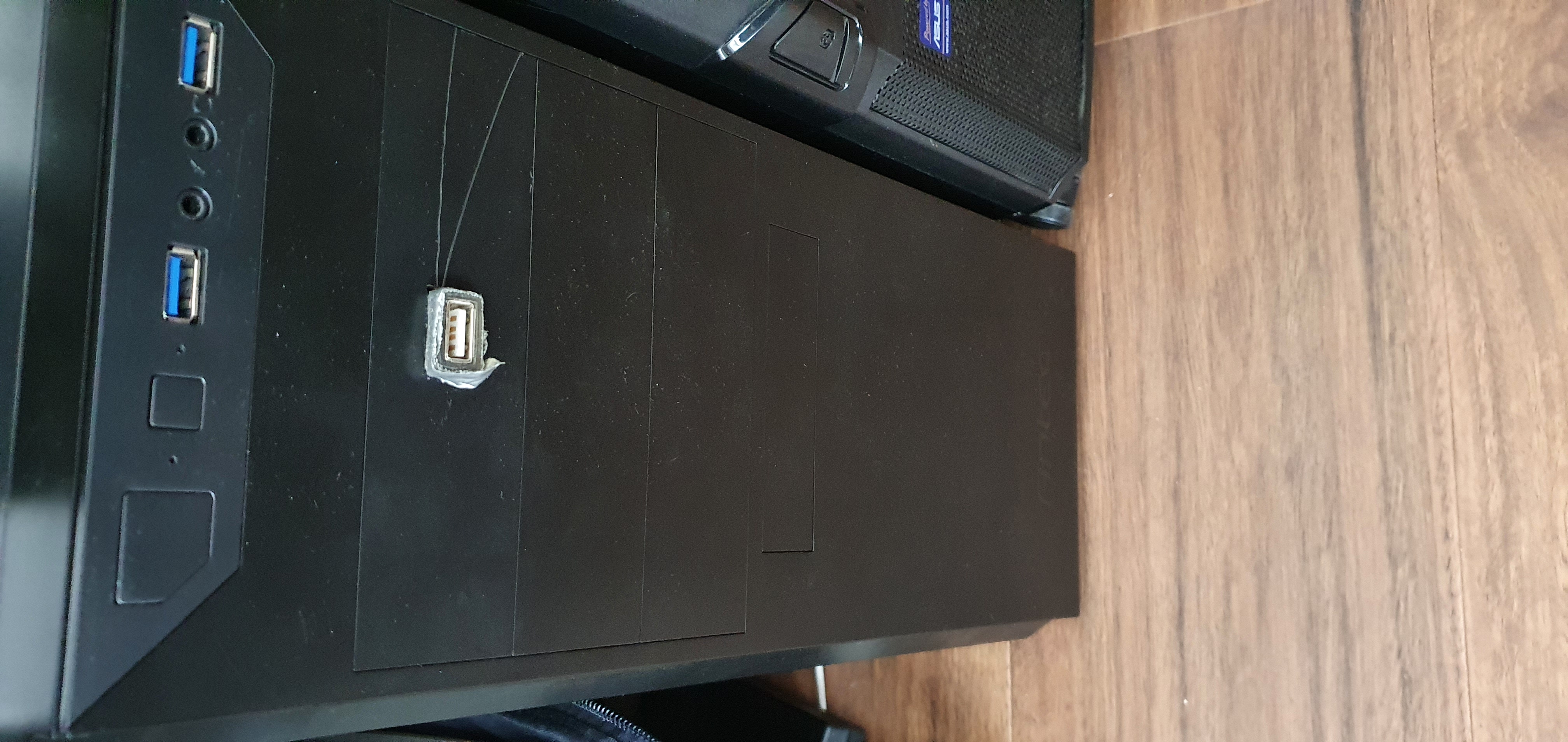

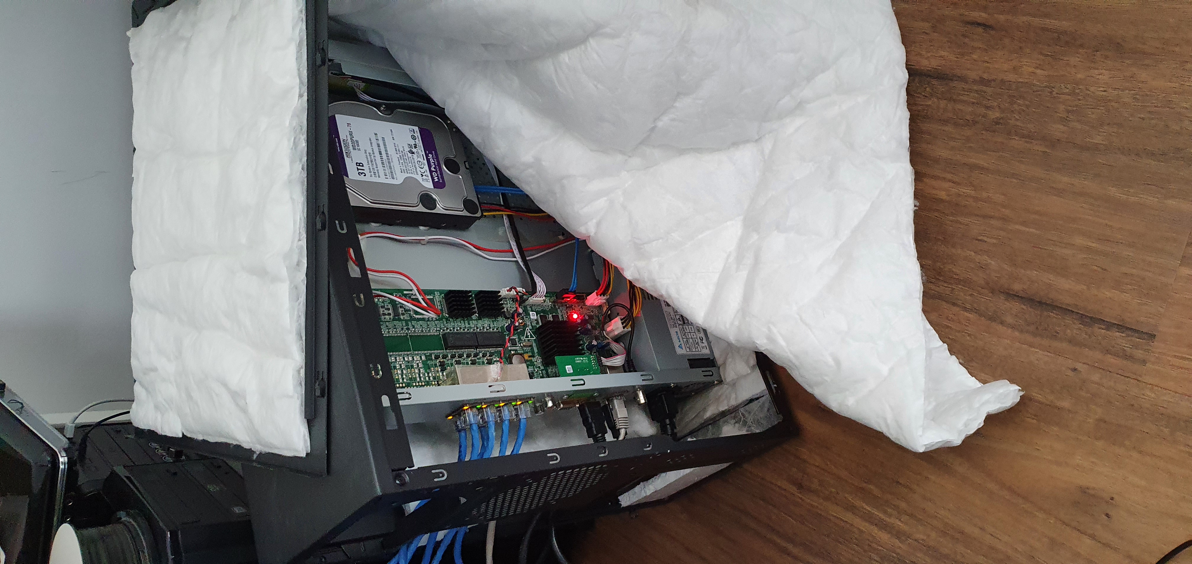

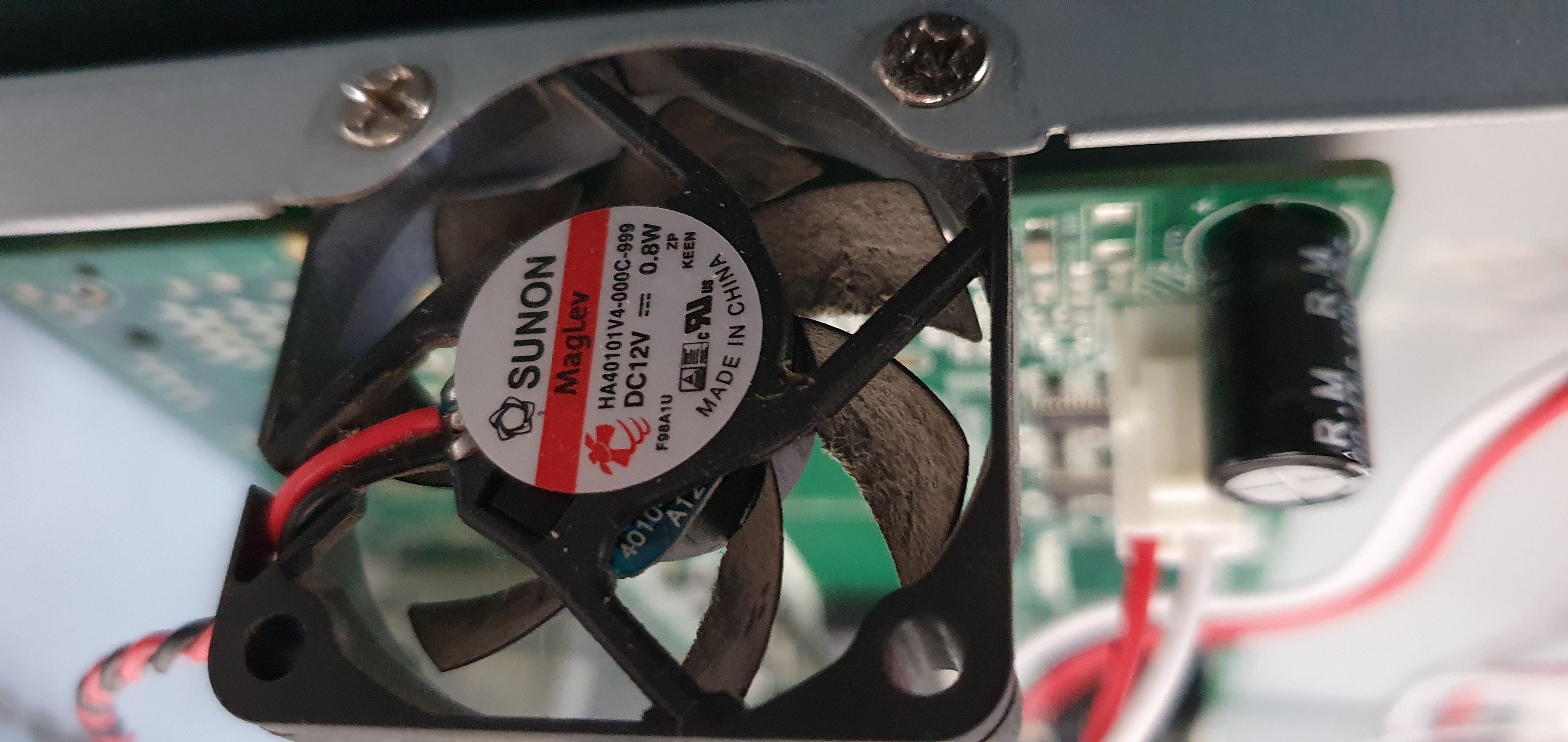

for whats its worth I have the following setup (see pics) and much much quieter for me, very tolerable. Taking the NVR housing off works straight away, the side fan is a Sunon and not bad to be honest. The power supply fan is the noisiest.
I then bought a $50 PC case, gutted it, bought some insulation (one side self adhesive) and placed it all around inside and that has helped more. Much much quieter and still getting airflow.
But taking the casing off helps a lot which explains a small enclosure creating pressure and pushing air through the tiny holes etc etc.
I have a usb hub hanging out the back and another one connected to the front but gotta tidy the mount up ;-]
Just another idea that is easy and wont void your warranty!

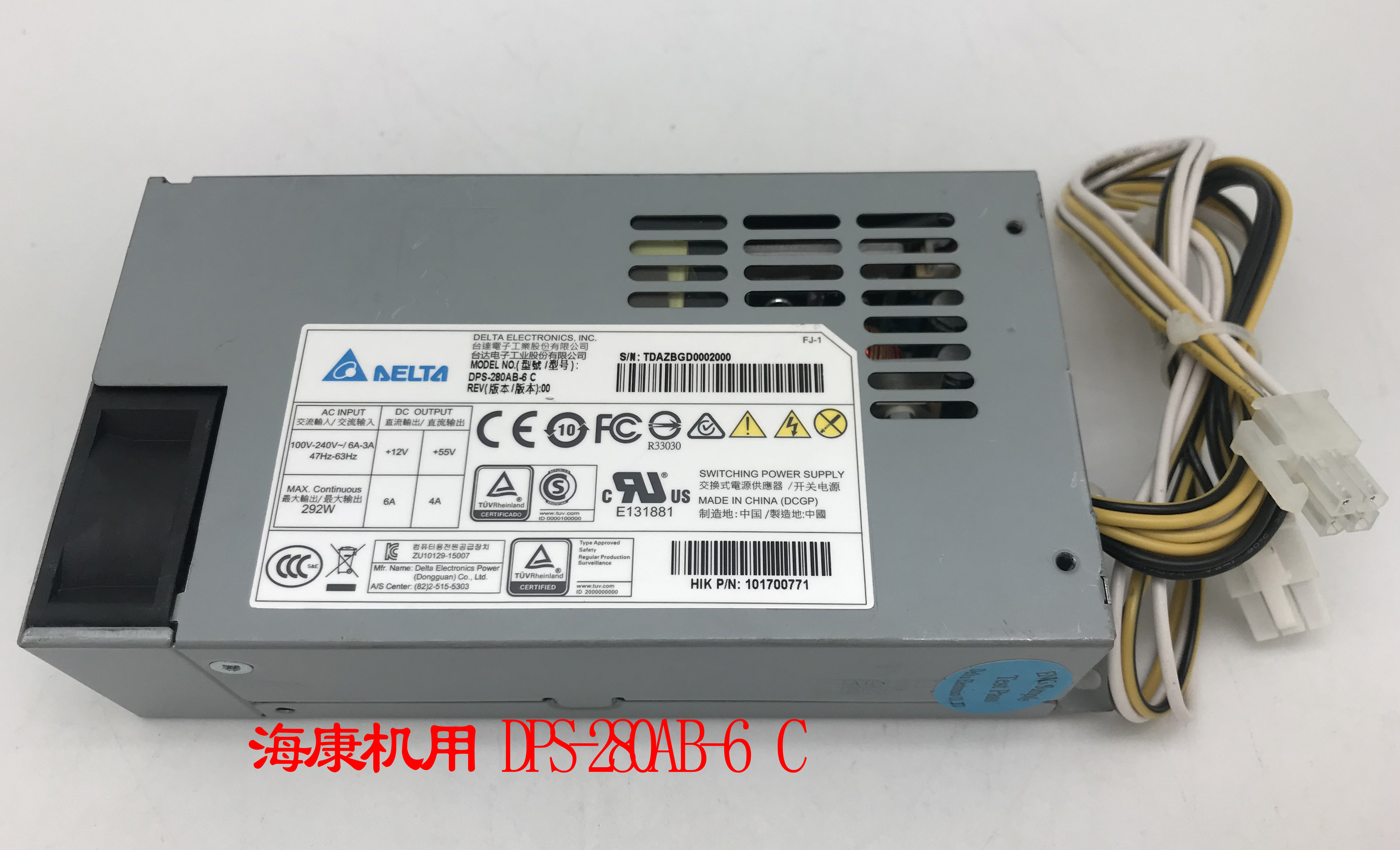

I have a DS-7616NI-K2/16P with a dead power supply. With an ATX PSU I've tested the non-PoE 12v part of the board and it's working fine. Now I'd like to test the PoE with a 52v power brick I have but I don't know which is the positive on the 4 pins connector. There are 4 cables: 2 yellow/black and 2 white. Does anyone know what color is the positive?
Thanks.
Can you make couple of pictures with the plug and the wires coming from the defective PSU? I always thought there are only yellow and black wires there, where yellow is +48...52V and black is GND, but let's see your pics first.
I may check my DS-7608NI-E2/8P in the coming days, but I'm pretty sure I only have yellow and black wires there (three yellow wires in parallel, three black wires in parallel too). However, I will get back here when I'll have more info.
The PSU is a Delta DPS-280AB-4A.
The 4 pin connector is different from the one on the DS-7608NI-K2/8P.
I've found a YouTube video where the PoE board gets repaired:
He tests with the multimeter the connector and the positive is on the yellow+black cable and GND on the white one.
Now that I know I'll test it today.

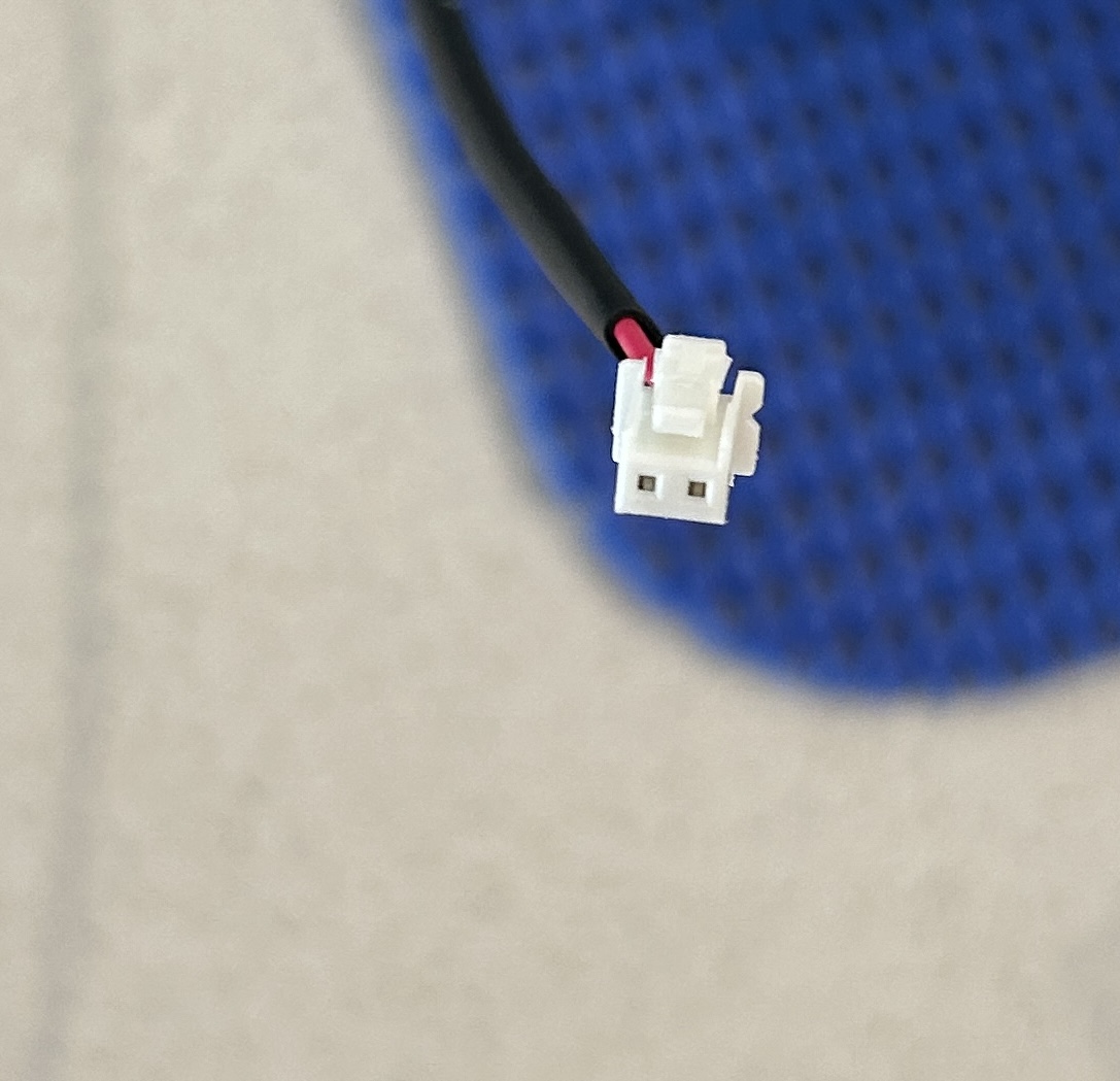

Re the connectors in the DS-7608NI-I2-8P, I used the following.
For the 2mm pitch connector inside the PSU you need Micro JST PH 2.0mm 2 Pin.
For the 2.5mm pitch connector on the main board for the case side fan you need JST-XH 2 Pin 2.5mm.
The above allowed me to use the Noctua OmniJoin connectors without damaging any of the original parts.
Note that the polarity needs to be reversed with the above connectors, connect black wires to red wires with the OmniJoin connectors.
As noted already, there is still a huge increase in noise when you put the top of the case back on, but I think the Noctua fans have possibly got it down to a tolerable level for where I'll have the NVR.
I provided links to a source for these connectors in my previous post, but I'm guessing it's not permitted to post those links and that is why the post hasn't been approved. So unfortunately, all I can provide is the descriptions above and I can't guarantee they will work, or that the wires will need connecting like I said, if they are obtained from a different source. Hopefully those descriptions are standard and connectors of that description from any source will work. It took me many hours of research to identify them.

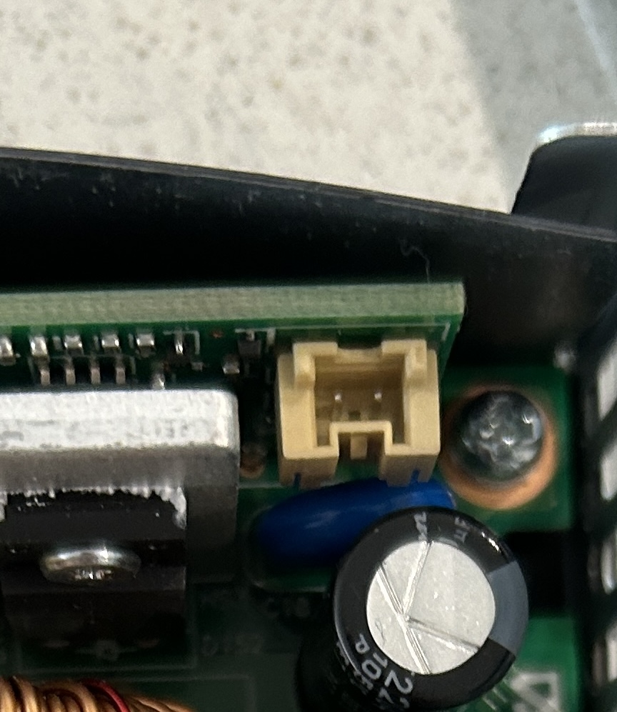

Hi - thanks for documenting the above. I've changed the case fan and it has definitely made it quieter and now looking change the PSU fan also.

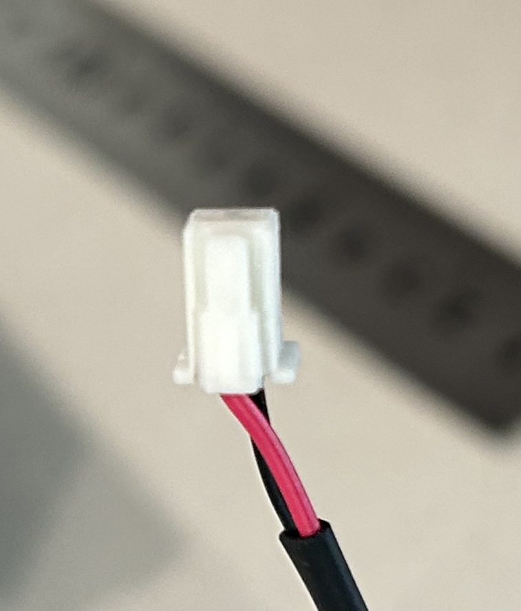

For the PSU fan, I found a Micro JST PH 2.0mm 2-Pin connector doesn't fit the socket (because of socket shape) on the PSU. See attached for photos of the existing PSU fan socket and existing fan connector. The PSU is a Delta Electronics DPS-280AB-4A and the NVR is model DS-7616NI-M2-16P.
You wouldn't by any chance happen to know what connector this PSU is using? The pins seem to have a 2.0mm spacing. Like you, I'd like to avoid cutting the wire to the existing fan so I don't have any potential warranty issues down the track.
Thanks for any advice you might have here.

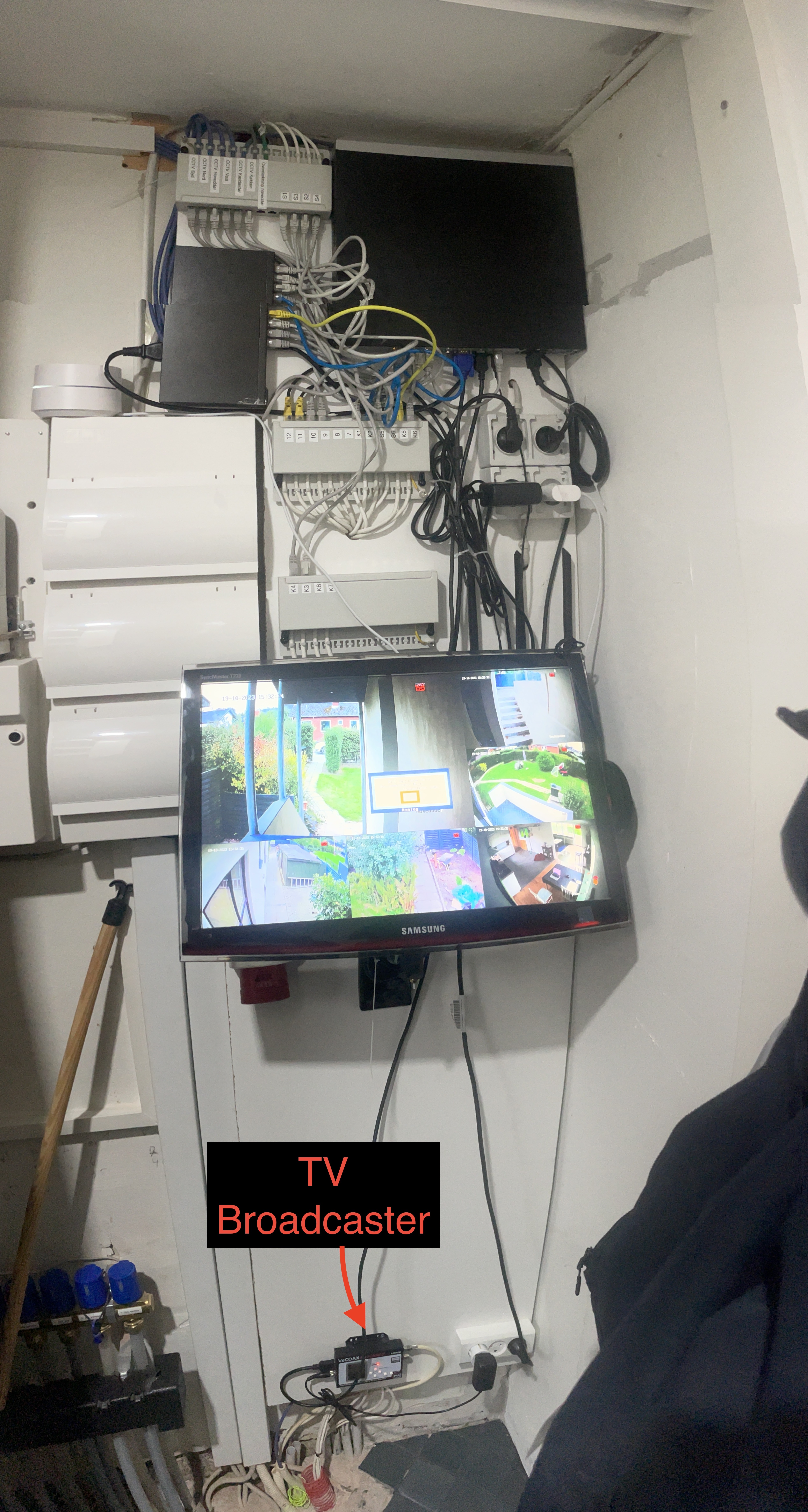

Just wanted to post a picture of my setup to show you how I monitor live. I connected a TV broadcaster between the NVR and my antenna wiring in the house. This allows me to switch to channel 9 at any TV in the house to monitor live surveillance.View attachment IMG_4072.jpeg

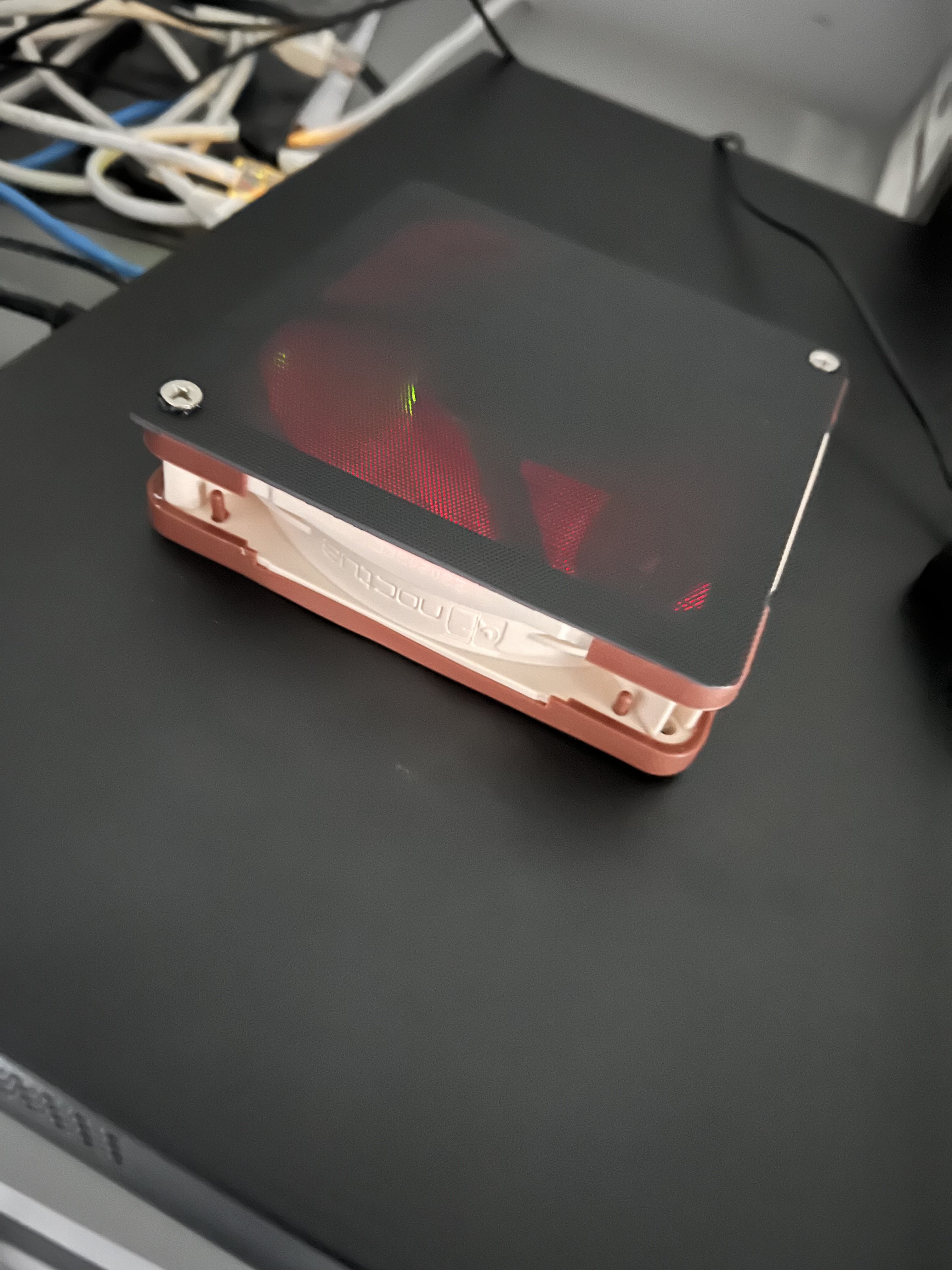

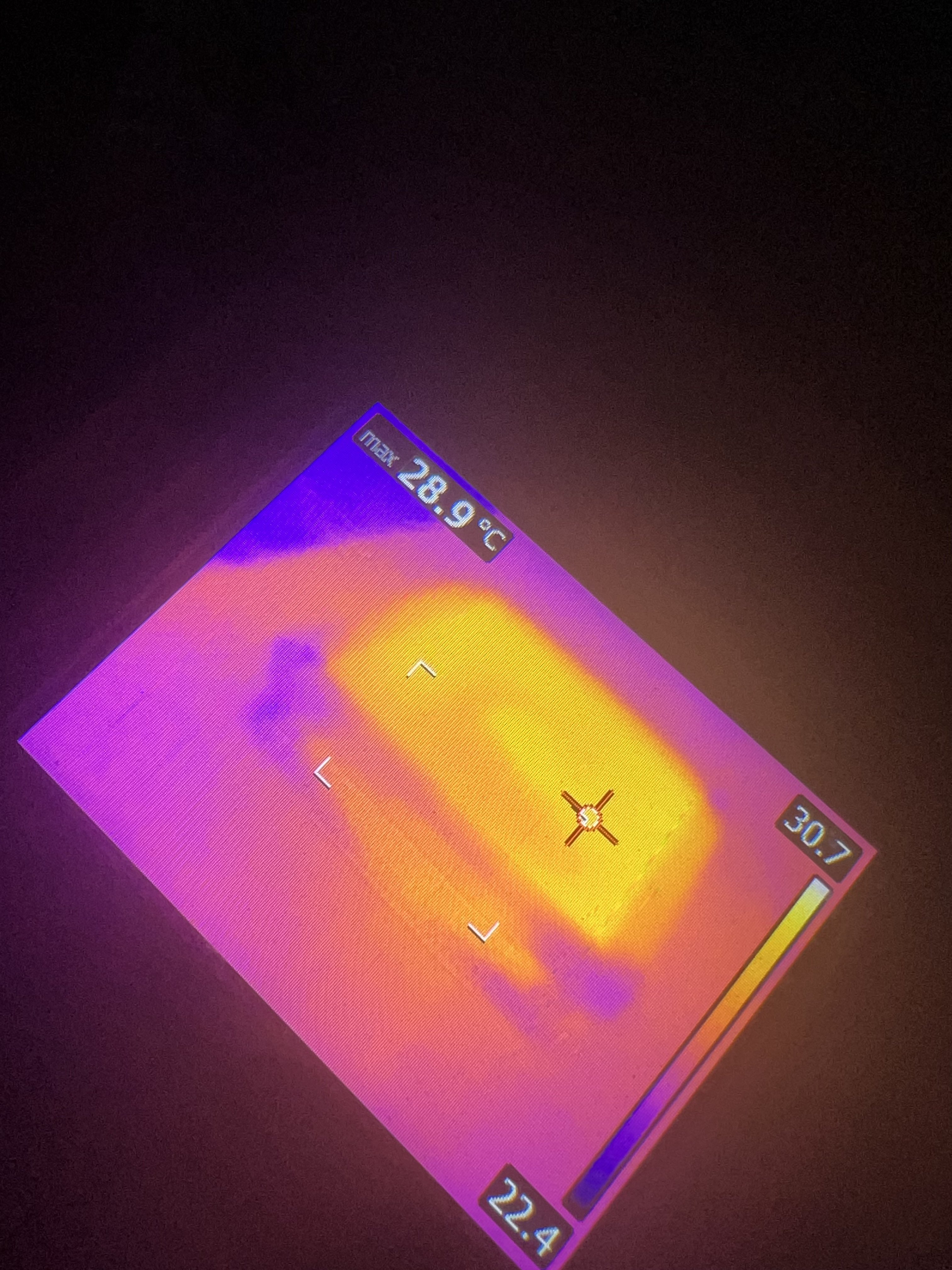

Was surprised at how loud it was which led me to this forum & replaced both fans with the noctua ones as recommended by the group. Although it was a lot quieter there was still an annoying noise so I cut the holes leading to both fans to try and eliminate all noise but there was still an annoying buzzing sound which wasn’t as noticeable from the other side of the room but it was still there.

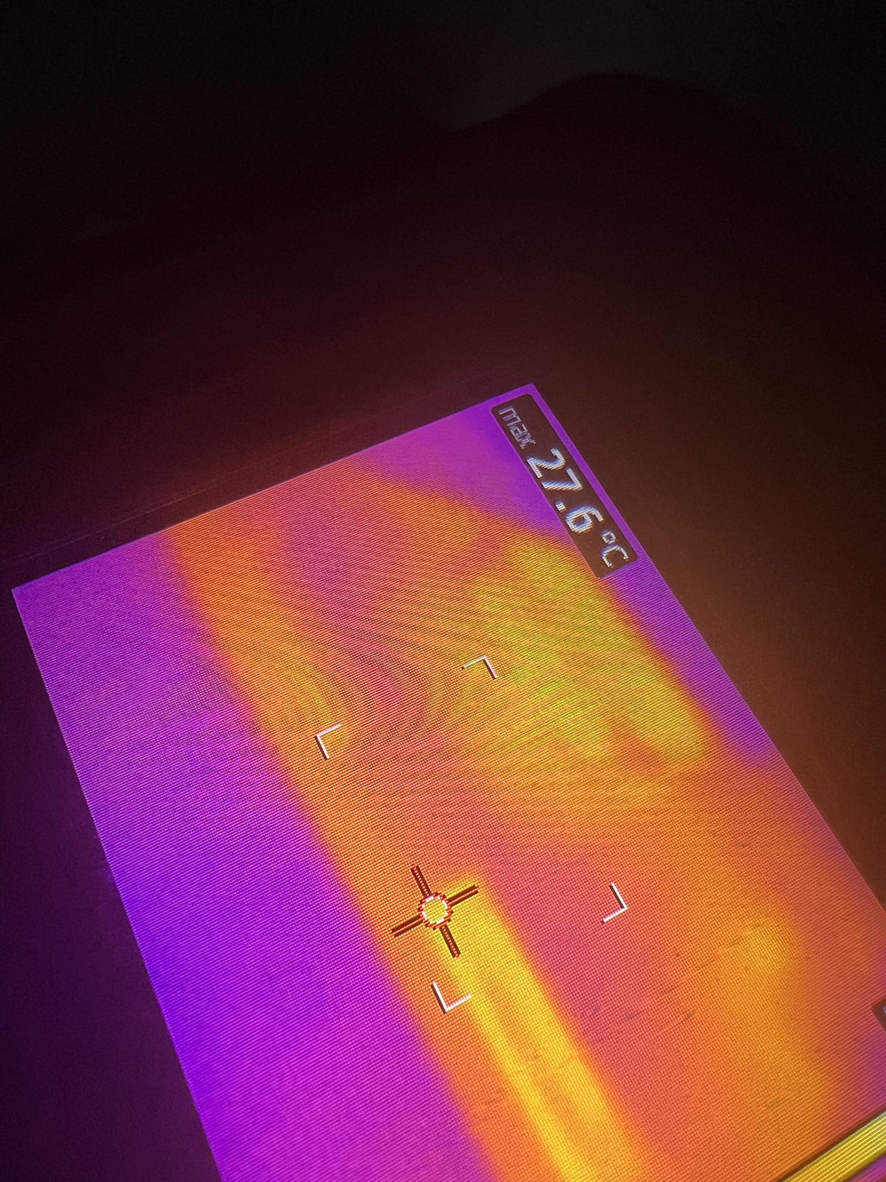

I ended up sending these fans back and decided to use another users method where he cut a hole on top. I purchased the lowest noise noctua 25mm x 120mm fans available which is rated at around 12.5DB, didn’t think about it before I purchased this but these didn’t fit inside the DVR as it was too thick and the lid didn’t close so cut a circle hole on top and mounted it on top of the dvr instead, I also attached the low noise adaptor and a temp control speed sensor. Put the original fans back in and left them disconnected, the metal top housing for the power adapter was removed so the air could also be vented out for its circuit board. Now it’s so quite that the hard drive noise is louder then the actual fan when your close to it, when your a few meters away you can hardly hear anything.
I have 2 4TB hard drives so it’s pretty packed in there with the speed sensor. I think mounting the fan on top give it a lot more room to vent all the air out compared to having it inside. It looks very bad but you can’t see it from so high up.

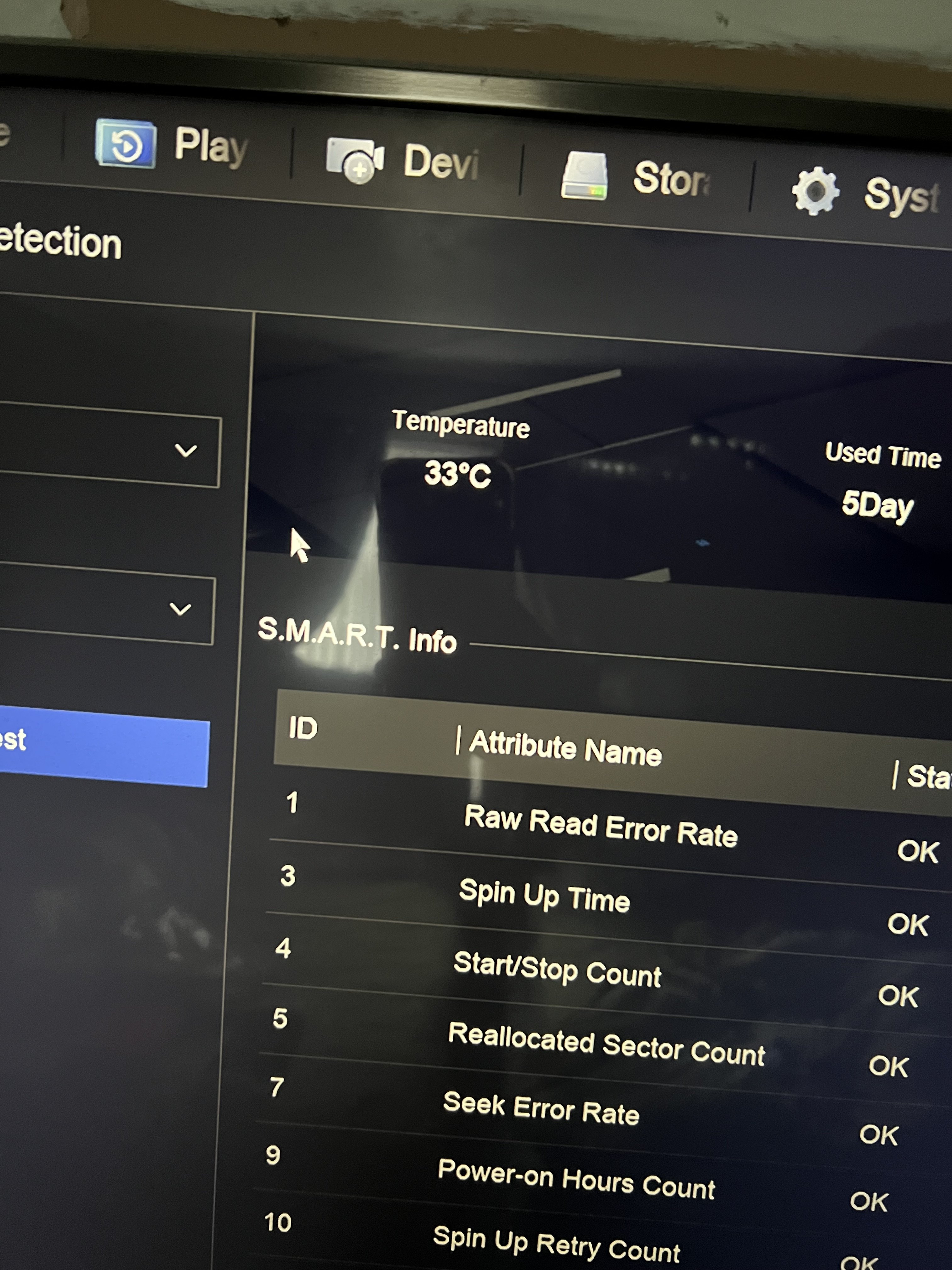

Before Temps were around 38 degrees and around 33DB with the 2 small noctua fans, hard drive temp was 36 degrees. Felt hot at the bottom when you touched it
Now It’s hovering around 30-33 degrees, noise is around 28DB, both hard drive temps are 33 degrees, feels warmish when I touch it from bottom and the power adapter isn’t getting hot Also so the fan is doing its job.
