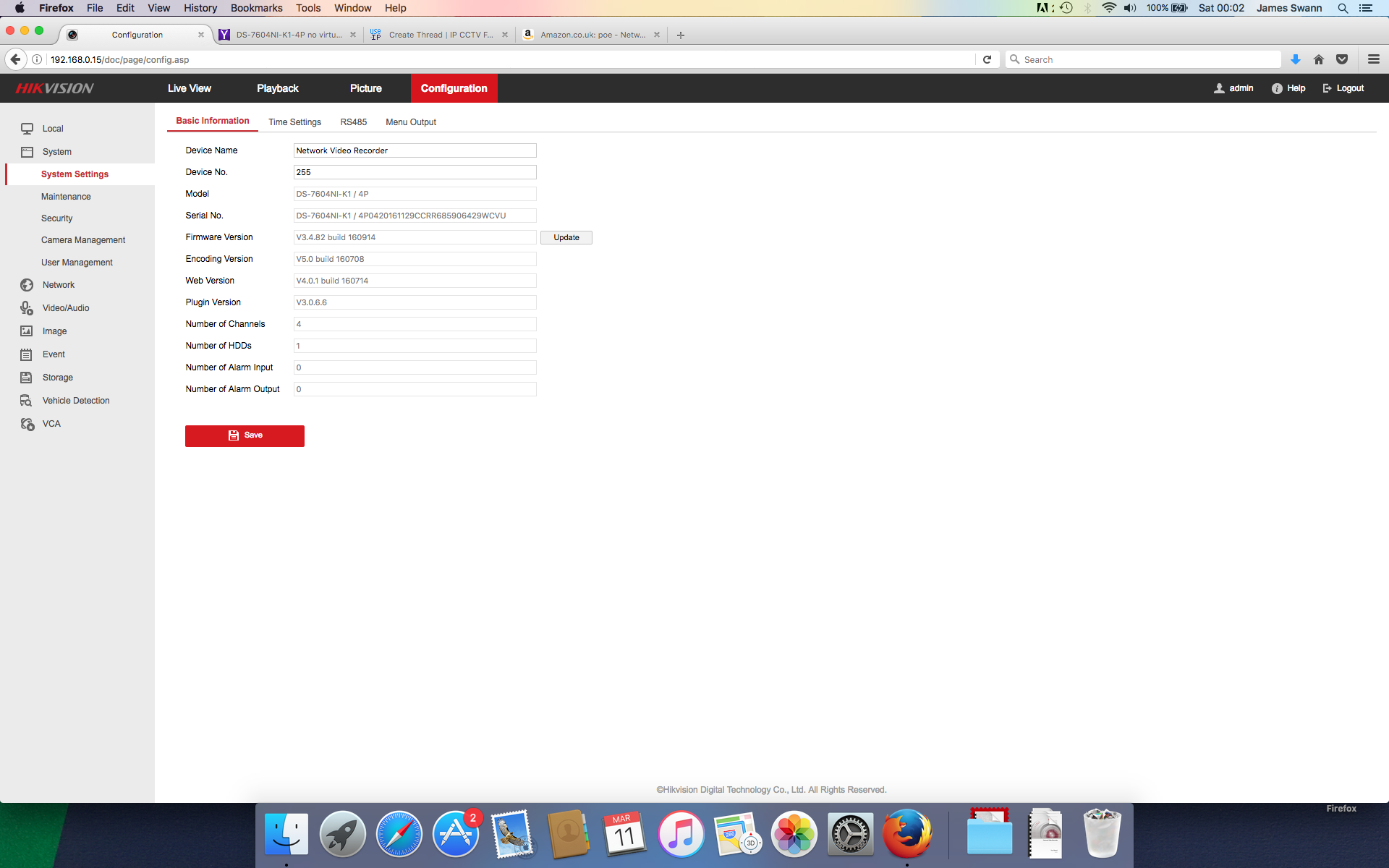

Good evening,
I have just purchased a new NVR and mini bullet camera.
- DS-7604NI-K1-4P
- DS-2CD2042WS-I 4MM

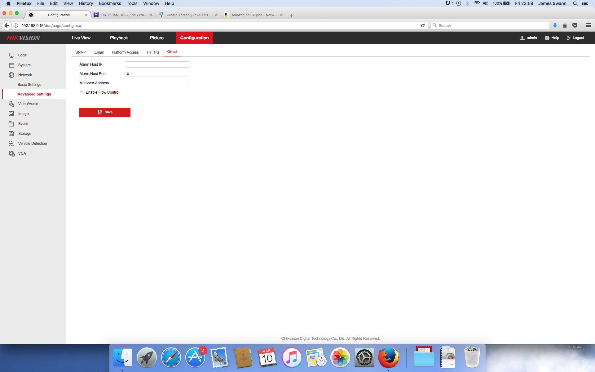

I'm aware of the virtual host option as the best way to access the camera directly for the extra settings however to my dismay, I am left with nothing to select from and there is no sign of the virtual host function.
Has this been removed from the firmware?
Any advice would be great. I'm just about the purchase a POE injector to allow the camera to plug into my router so hopefully that will work but would I loose any settings when I plug it back into the NVR?
Any advice would be most welcome.

To my understanding, the DS-7604NI-K1-4P and indeed other members of the -K series of NVRs do not support Virtual Host on any of their firmware versions currently.
I'm not certain as to why this is - both the E and I series NVRs support the feature.
On the plus side, the NVR shouldn't change any of the settings on the camera that are currently inaccessible (shutter speed etc) that you'd need virtual host for. Other, more basic settings (such as framerate etc.) should be configured on the NVR directly, as the NVRs settings are pushed to the camera and take priority.
We do now have firmware versions that enable the Virtual Host feature for the HikVision DS-7604NI-K1 and DS-7608NI-K2.
