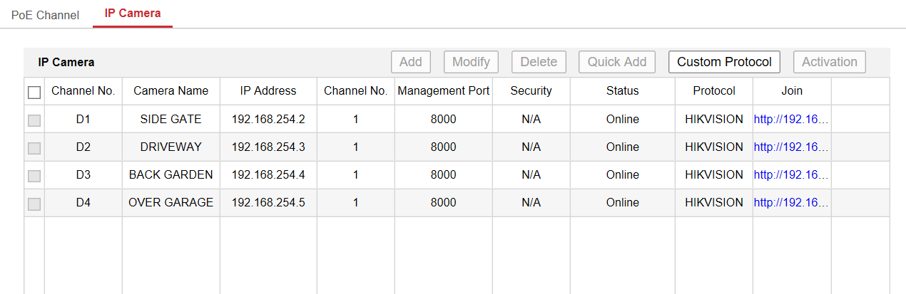

Virtual Host: I've enabled Virtual Host in the NVR and have attempted to access the cams using the provided web addresses. Image attached.

The final firmware on that list fixed the issue in the sense a login page now appears using the virtual host URLs.
Next issue is the NVR user/pass is not being accepted when attempting to login to those cameras directly. I tried setting a custom password via Cam Management by unticking Plug&Play and entering the pass but this just made the camera go offline.

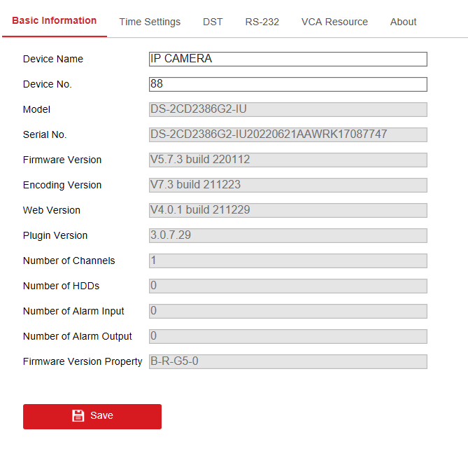

Attached the cam model.
I was able to get in using the original password set by the engineer when he installed the system.
Thing is, I changed the NVR pass once I took ownership so it's odd that the cams never got that update and still using the old pass.
If need be, I can continue using the old pass for the cams. But any idea how to sync the pass? Now that I have cam access, is it a case of going to User Management and updating the 'admin' pass for each camera to the same as the NVR?
