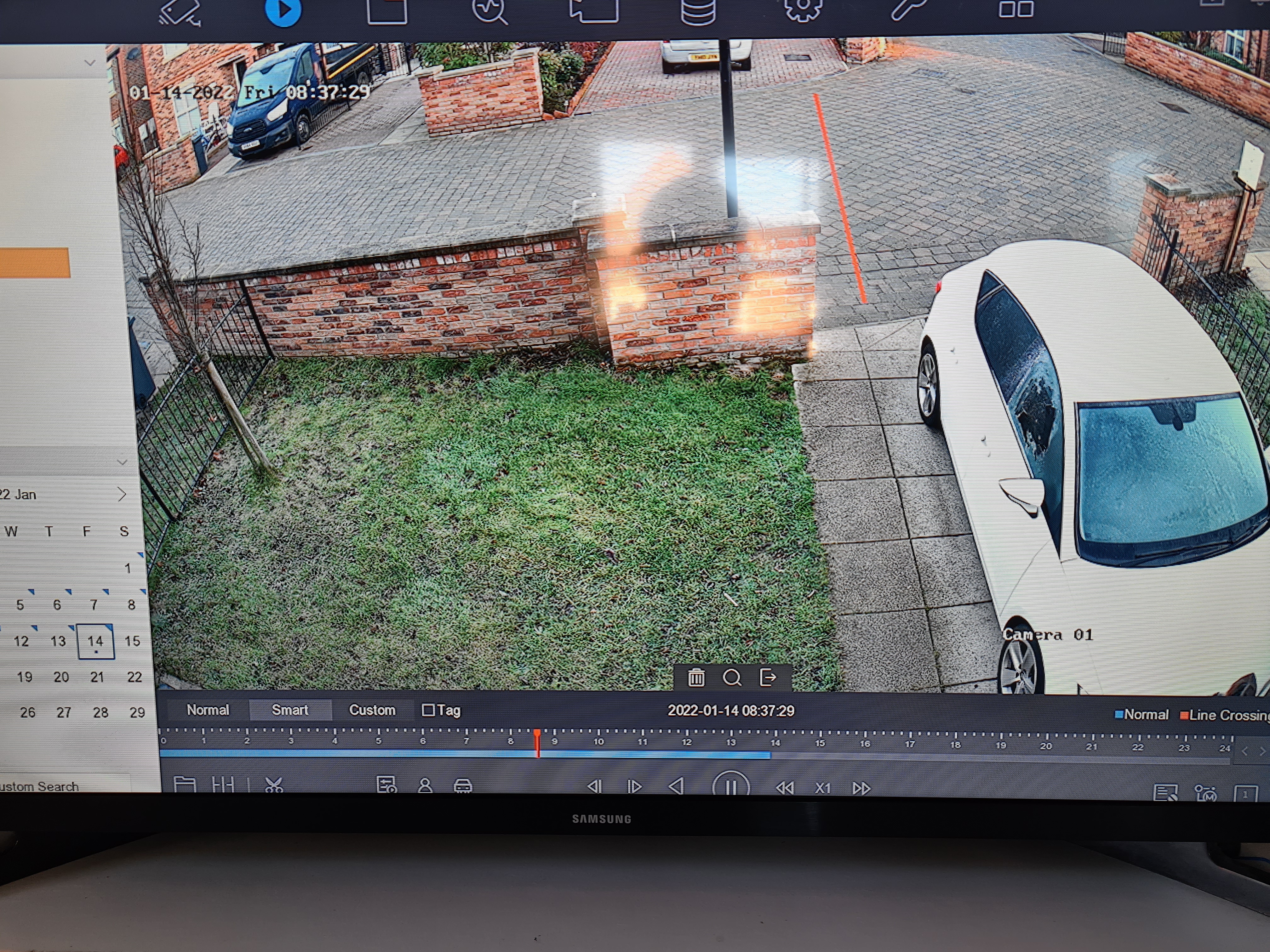

Can you help me with my issue. Drawing a line on screen on smart playback but and getting no markers ( on any camera) do these Settings look OK to you? Dual vca is enabled.
I get markers for intrusion but not when I draw the line. Any cameras shows no markers and the screen is static.

That's what I'm saying though. The line crossing is enabled as I use it to alert me when anyone entries my garden. It sends me an alert in my app and also sets the nvr buzzer off. Dual vca is also enabled.
If I go to smart playback then the markers are there. If I draw a line and search it all markers vanish and there is nothing to play back.
It used to work. A week ago before the step back. I used it when neighbours asked to to check if suspicious people were seen around. And yes it caught cats, foxes, cars people Etc.

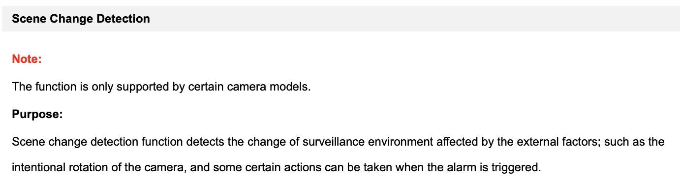

You're probably better off without Scene Change Detection as well. That's something you enable to detect someone pulling a bullet around to point out of the way or hooding a camera.
