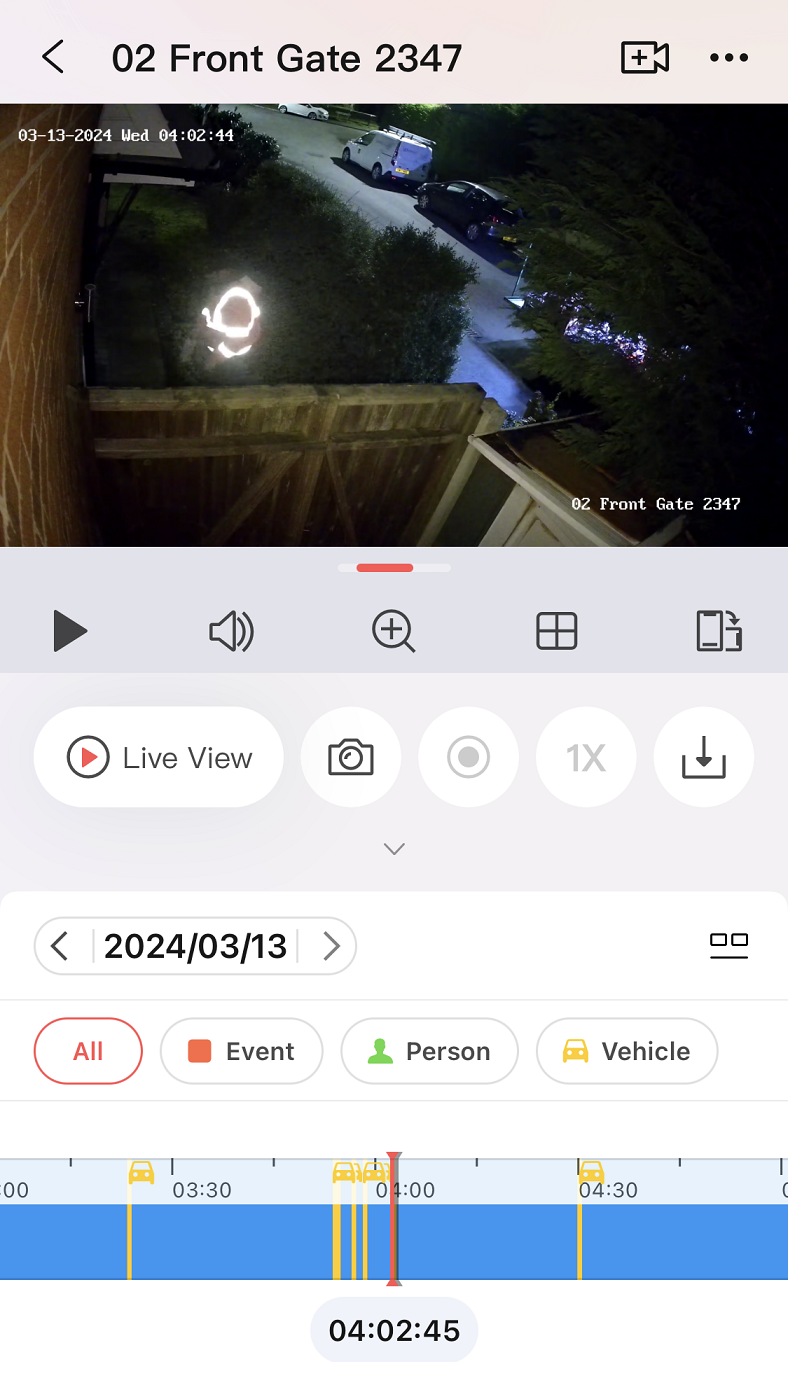

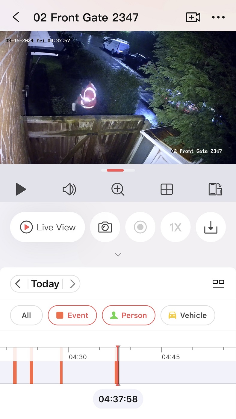

Wednesday morning I happened to be awake to hear the milkman driving around. I was waiting for the notification but didn’t get one.
Checking playback in the app for the time the milkman came shows him walking up the path and into the detection area.

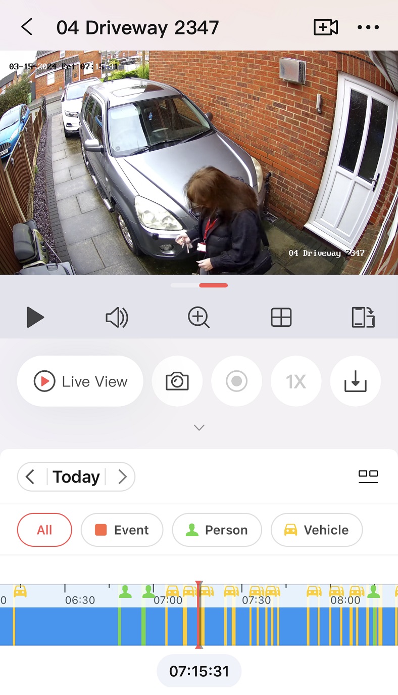

The same happened again this morning, milk on front step and no event notification. Plus my wife walked out the back door, down the drive and drove the car off, again with no notifications?

I have checked the logs for Wednesday and Today and between the hours of 1 and 8am on Wednesday there is only one event trigger for intrusion and none for line crossing when my wife left by the back door at 07.14 and nothing at all for the milkman at the front Door at 04.02
For today between 1 and 8am there were no event triggers in the logs at all despite the milkman at 04.37 and wife leaving at 07.15

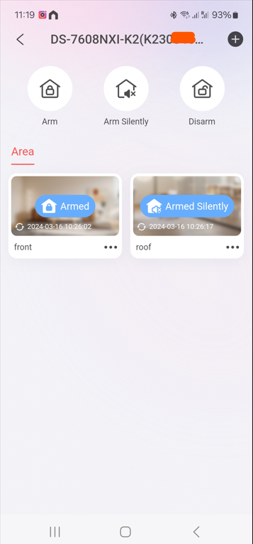

What I've found with the NVRs that support the individual arming of cameras in Hik-Connect, is that by default they show armed when the NVR is set up for the first time, but notifications don't come through. Disarming then rearming them using that right hand of the three icons on the app Home Screen gets things working normally. I usually create areas using the + button in order to zone the cameras in groups. The 4.82 firmware for the 4 channel NXI-K does not give that individual arming option in Hik-Connect; the icons are missing.
Have not added any camera to an area, but it seems to receive notifications for all of them.
It works for my NXI-K2
Created two areas for three cameras. Home Screen middle button(shield with cross) arms Arms silently and disarms all cameras(all NXI-K2). Home screen Right button(beacon strobe), opens Area, there are two icons for two areas and arms, arms silently, disarms areas individually
Yes, unusual it’s missing on the different model using the same platform. For reference’Arm Silently’ only affects Siren/Strobe models (it doesn’t allow the notification while muting the phones alert tone). Areas are very handy for grouping and the ability to switch on/off specific camera sets
