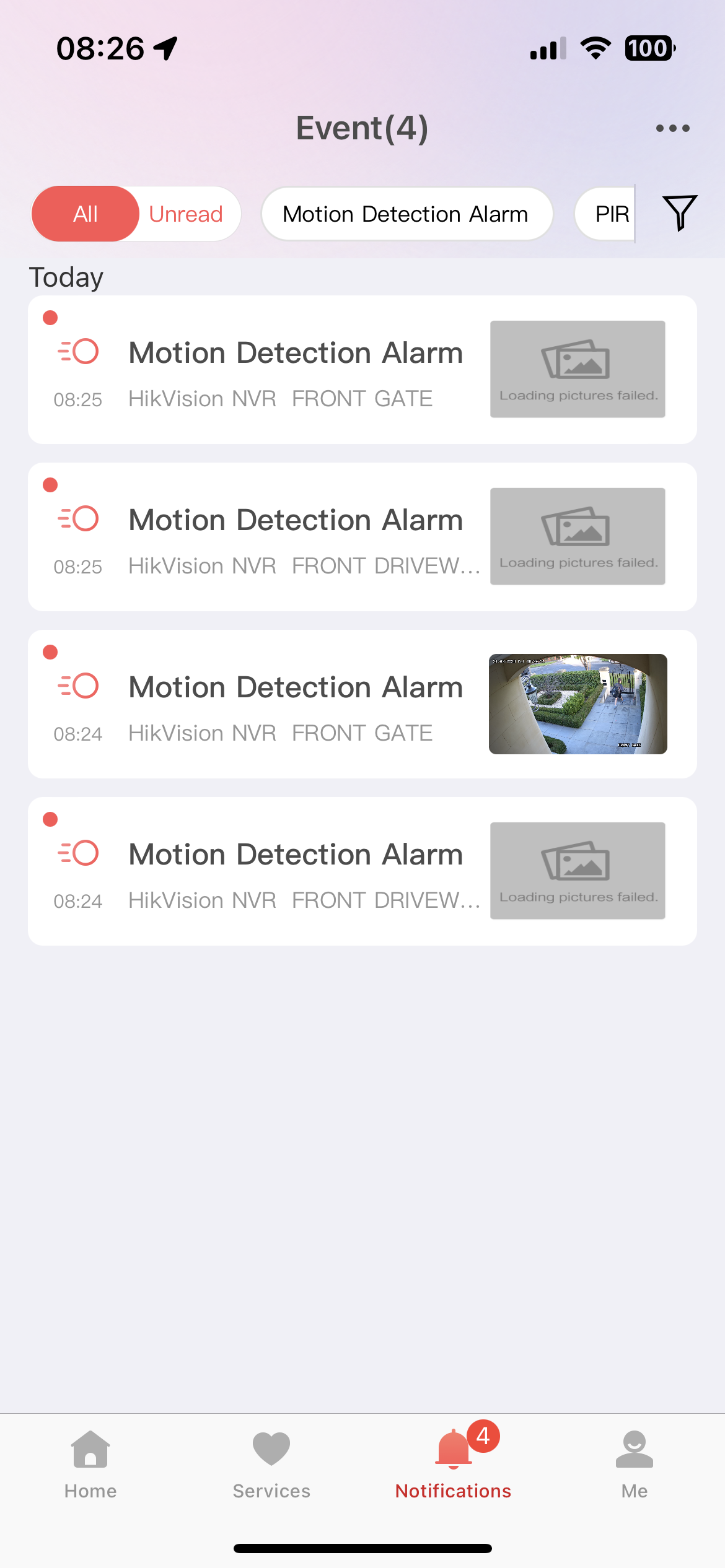

Sorry I'm late, but the broken thumbnails you're seeing aren't just affecting you - it's due to some kind of compatibility issue between the G5 camera and M-Series firmware, which I've been discussing with Hikvision (throughout several M-Series firmware releases).
I'm consistently seeing exactly the same thing as you after a customer reported it to me - the first thumbnail seems to work, and then every other is broken.
I tested other cameras (using G3 and G1 firmware) on the same M-Series NVR, and G5 cameras on an I-Series, and there were correct images on all of the thumbnails.

Whether my iPhone is connected to the same network as the NVR (with WIFI) or is connected to a different network (with 5G), I get the same result. Interestingly, sometimes 1 image appears but the others don’t per attached photo. I’ve got the latest firmware installed on my M series NVR and all G5 cameras.

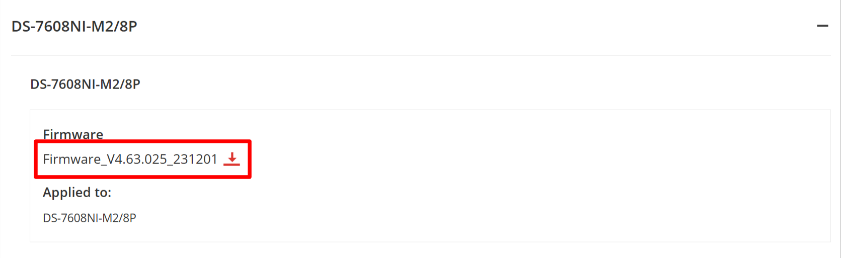

UPDATE - This issue has now been fixed in the latest V4.63.025 build 231201 firmware, which we have tested.
The new firmware can be downloaded here by searching for your M-Series NVR model:

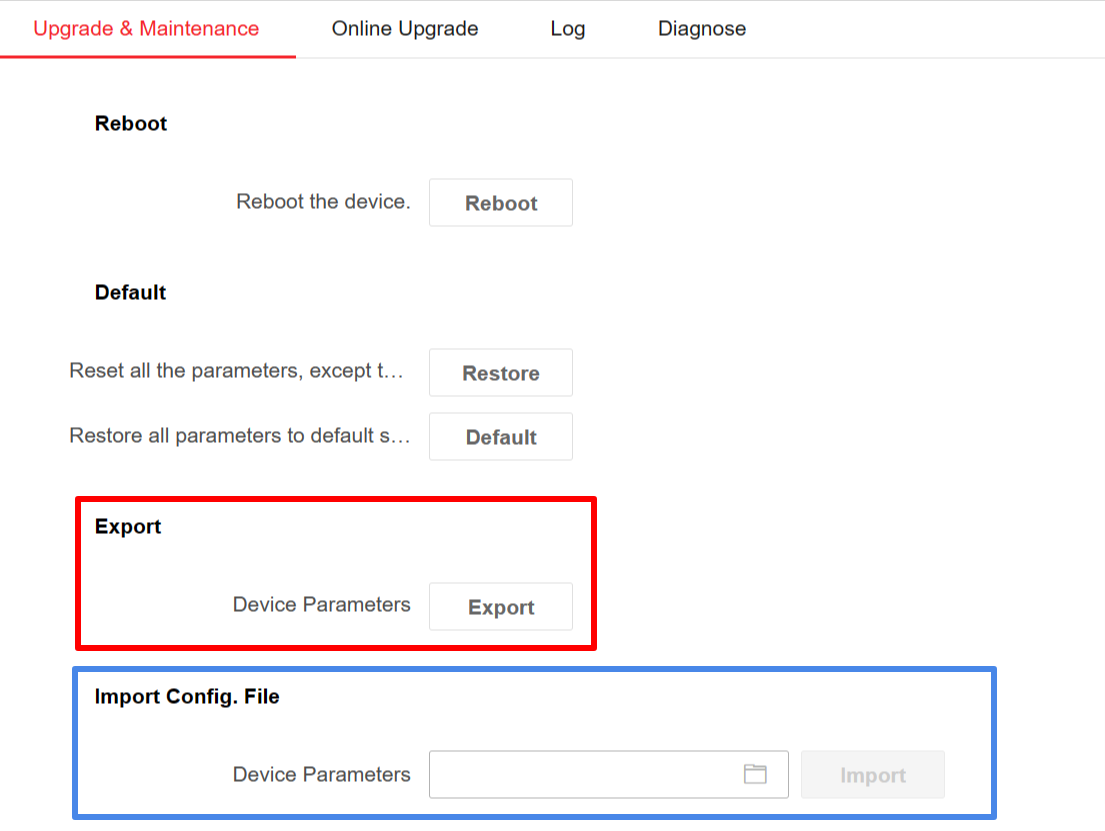

We were also able to roll back to an earlier version from this one, but doing so hard-reset the NVR.
So, I would recommend backing up any important footage and exporting the configuration file with your NVR settings in Configuration→System→Maintenance→Upgrade & Maintenance→Export Device Parameters - you can then load this back onto the NVR to retrieve all of the previous settings if they are lost:
