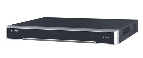

The M-series range physically looks no different to the K/I-series models, the biggest changes appear to be in the hardware & software. Below are some of the things we have picked up on from the information Hikvision has provided:
Support for More Incoming Bandwidth - The 8ch M-series NVR supports 128Mbps which is an increase of 48Mbps on the old K/I-series models, it is still not quite enough for 8 x 8MP AcuSense cameras at full settings but it should be enough bandwidth for 6 x full setting cameras or 8 x with some settings reduced (e.g. frame rate, H.265+, etc...)
Features 8K HDMI Output - All the M-series NVRs support 8K HDMI 2.1 output for displaying the image from specialist ultra HD (24/32MP) cameras, on larger M-series models (7700/9600) that support 2 x HDMI outputs only one of the outputs supports 8K output.
Support for "Ultra HD Resolution mode" - Currently the details of this feature are unclear but it would appear to allow the NVR to support more ultra HD (24/32MP) cameras, but the limitations when this feature is enabled are not clear and we also think there would be bandwidth issue running 8 x 32MP cameras on an 8ch NVR (we await clarification from Hikvision).
Features Dual-4K HDMI Output - The larger 7700/9600 M-series models that support 2 x HDMI outputs can display 4K images from both these outputs.

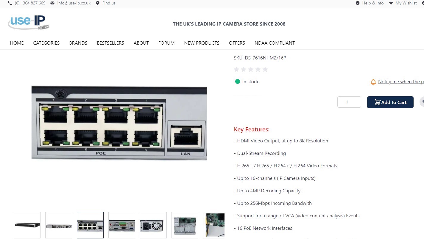

The DS-7616NI-M2/16P is only showing 8 ports on the display image Dan. Reported to have 16 ports, can you confirm.
@busterboy apologies, this was a mistake on our side.
I meant to ask our web team to add these photos to just the 8ch model but accidentally just said M-series to them so they added them to all the models.
The 16ch model does have 16 PoE ports, we will remove these incorrect product photos shortly.

Thanks for the speedy response Dan.
Dan The m series product pages show the 8 channel nvr having "Up to 8MP Decoding Capacity"
But all other m series NVRs having "Up to 4MP Decoding Capacity".
Why only 4mp.
Hi @gp116126
Again this is something that has not been made very clear on the product page, when it says 'Up to 4MP Decoding Capacity' this actually means 'Up to 16-ch@4 MP decoding capacity'
The models are not limited to 4MP, this is just the maximum resolution that you can decode (live view/playback) all 16ch simultaneously.

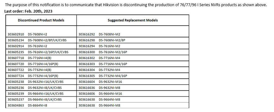

Over the weekend we have received notification from Hikvision that their I-series of NVRs will go End of Life (EoL) in February next year.
Hikvision are recommending the M-series NVRs as replacements:
