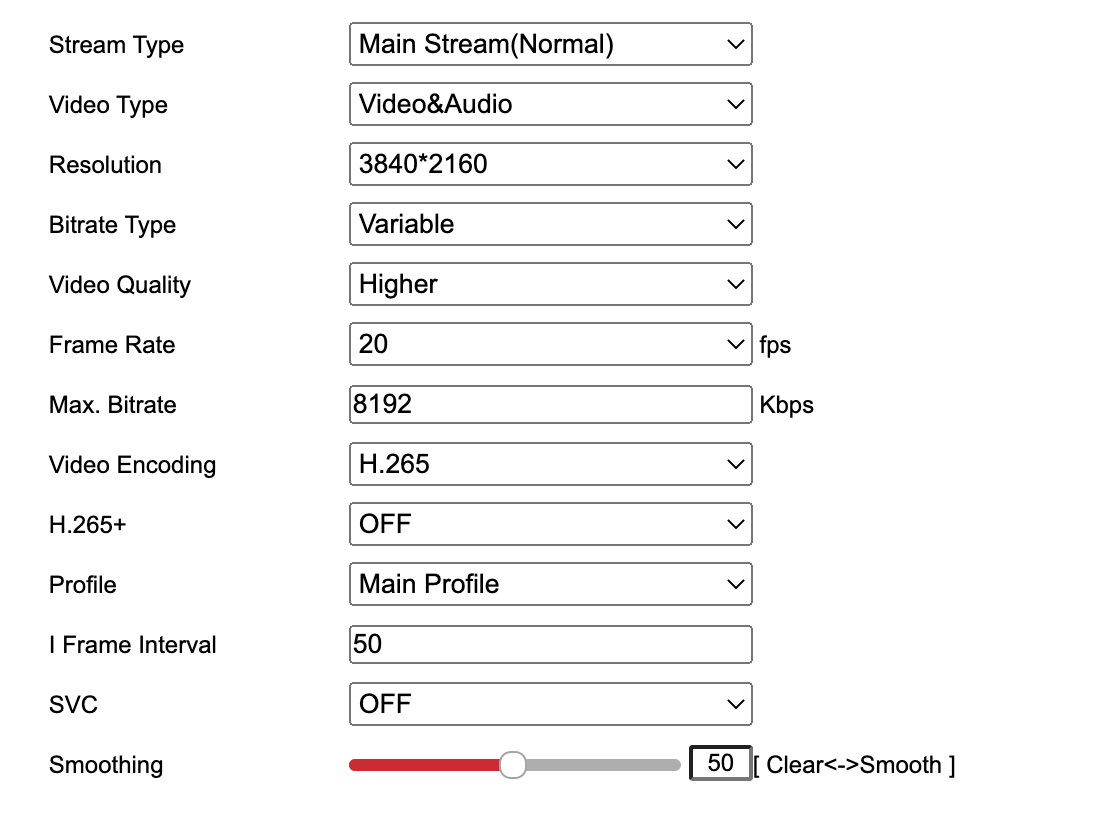

I not sure if I have some issue with my setup or something else but it is quite frustrating. When trying to view the playback on my iPhone I can see certain parts of the day and some parts (Quite often is it when there is some movement I would like to see) i get the message network unstable trying to reconnect but never does. If I move the timeline back a few minutes it will be okay.
My setup is as follows:
NVR - DS-7608NI-I2 / 8P running this firmware - V4.51.025 build 210927 (I did update to latest a while ago but when viewing on my phone I saw green blocks over the view. Unless that is fixed I will stay on this version)
Cameras - 5 X DS-2CD2387G2-LU running firmware - V5.7.3 build 211222. Video spec is the picture uploaded
My broadband is 100Mbps download and 14.7Mbps upload

The green box issue has been resolved with the latest firmware updates / app version update, so I'd update to V4.61.025 before adjusting the video settings.
Just to warn you, however, a small number of the 7608NI-I2 NVRs built in 2015 do suffer from a manufacturing issue that sends them into a boot loop when they're updated to V4.61 (or later), so double-check when yours was purchased - most NVRs are absolutely fine. Hikvision will repair any affected NVRs if this does happen free of charge (see post #25 in the below thread), but you'll of course be without one for a couple of weeks or so, so maybe hold off upgrading until you've spoken to your supplier if it was bought in 2015/2016:

Hi Kyle I have updated the NVR. I have tried to reproduce my issue but not seen it yet. I wonder if a reboot would have helped. Will keep an eye on it and see if it happens again
