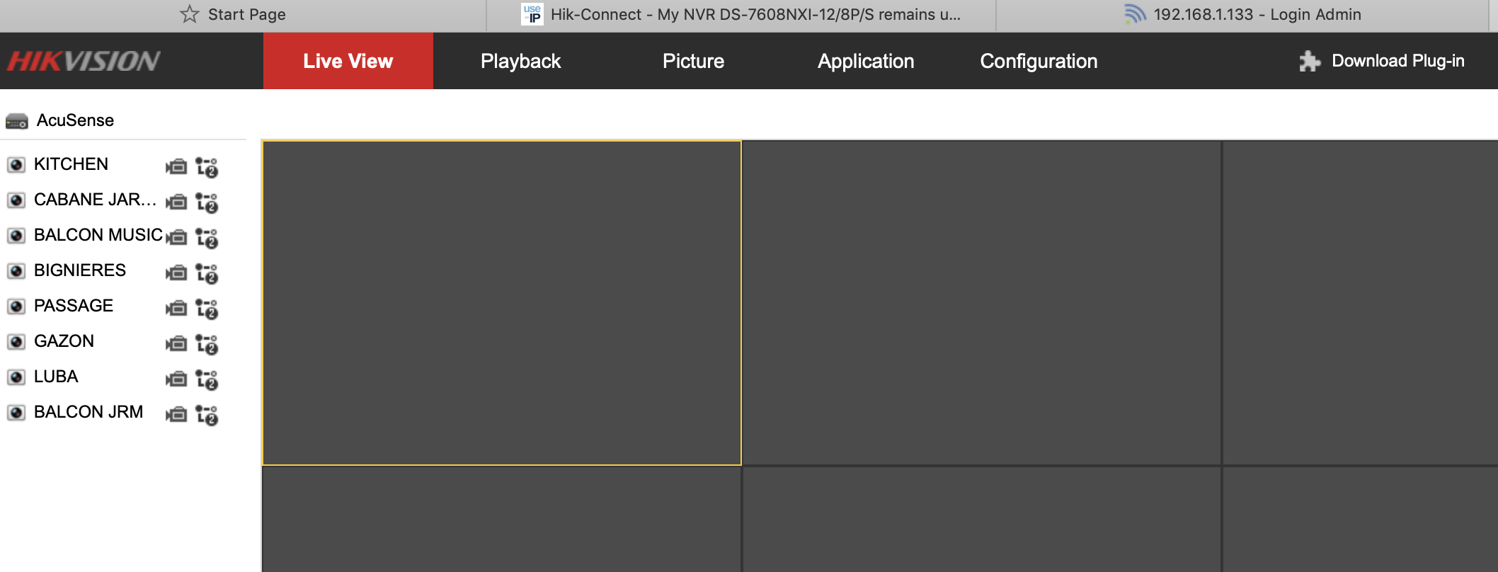

If you can, try connecting a different Cat 5 or Cat 6 lead to see if that makes any difference. On your screen the grey boxes shouldn’t be present if there’s a signal.
It looks as if your cameras are setup via the second stream not main. Right click on the 2 which is at the right of each camera icon, you should be able to switch to the main stream then. Sorry but I can’t remember much more as once I set mine up I hid my NVR away in case we are burgled. It isn’t easily accessible now, sorry.
