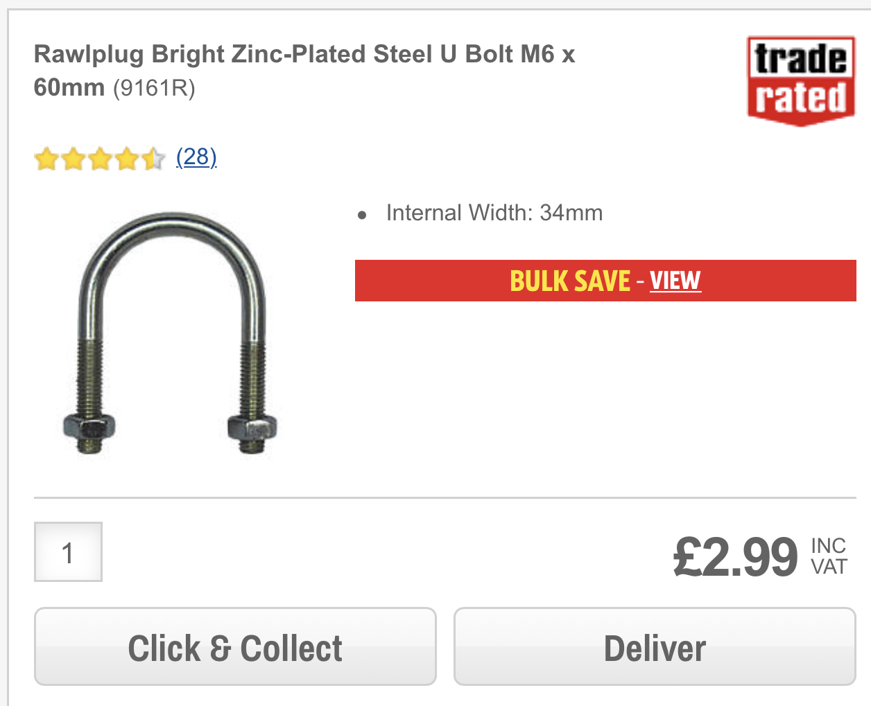

You'd have to have a look of them. You could chop them down a bit with a junior hacksaw. Just wind them nuts all the way on, chop a bit off the length to suit, then wind the nuts back off to clean the threads - easy enough.It’s a good solution
Ive found one matching closer to my internal width size but not sure about the length - 60mm? Will that not be too long if it’s coming through the junction box?
