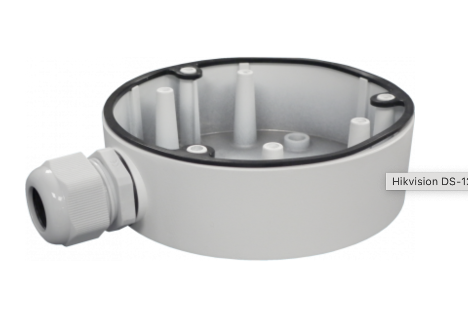

No problem. You may be able to find a generic clamp bracket that you mount the camera to. For a neater installation use the appropriate Hikvision power intake box - DS-1280ZJ-DM21, mount saddles on the rear of that and seal any unused holes.
Hi
I did actually buy this base box with the camera so are you saying I could actually mount the saddles directly at the rear of this junction box - if so that would make it easier as I don’t have to find a pvc type of board to avoid corrosion.
the pole diameter is roughly 30-35mm so will see if I can get the saddle clamps of this size.
Thanks for your ideas.
Sorry another question - would you recommend the saddles with a clunky or slim base as shown in the attached image
Yes that's what I'd recommend - then you can keep the termination inside it without an additional enclosure. The box is only aluminium so very easy to drill and bolt to. I recommend the bulky saddle on the left as the two machine screws go deeper into the tapped block and can be tightened better. You'll preferably want a couple of M5 countersunk machine screws and nylock nuts to secure them to the Hikvision box.

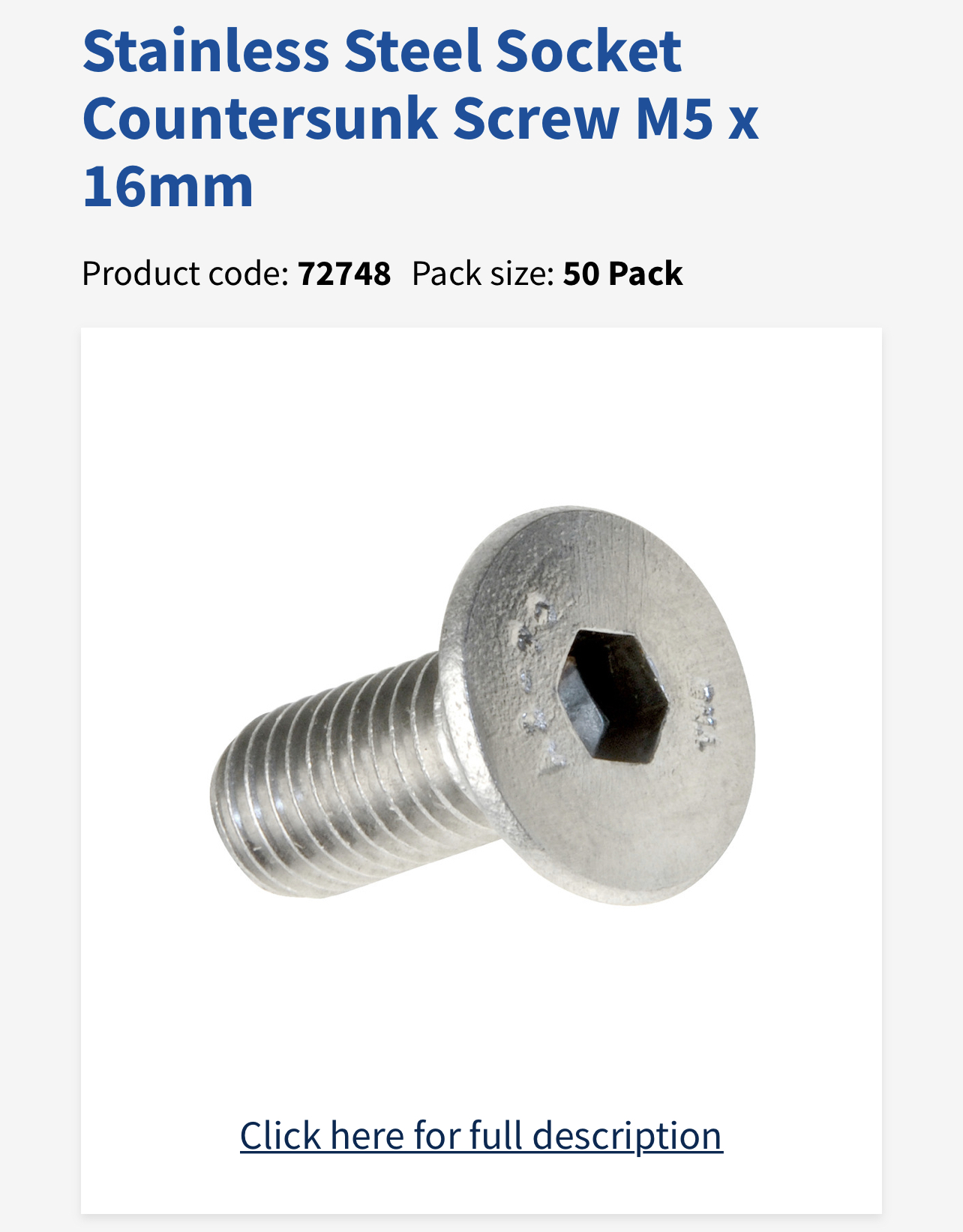

Is the M5 screw and nut for securing the actual bracket to the camera junction box?
What type/length of the two screws do I need to fix the the actual top plate of the saddle as shown in the image of the saddle I sent you.
No. The saddle bases would bolt to the back of the camera junction box using the M5 countersunk with M5 nuts inside the box. The correct fixings are supplied with the back box to mount the camera to it.
