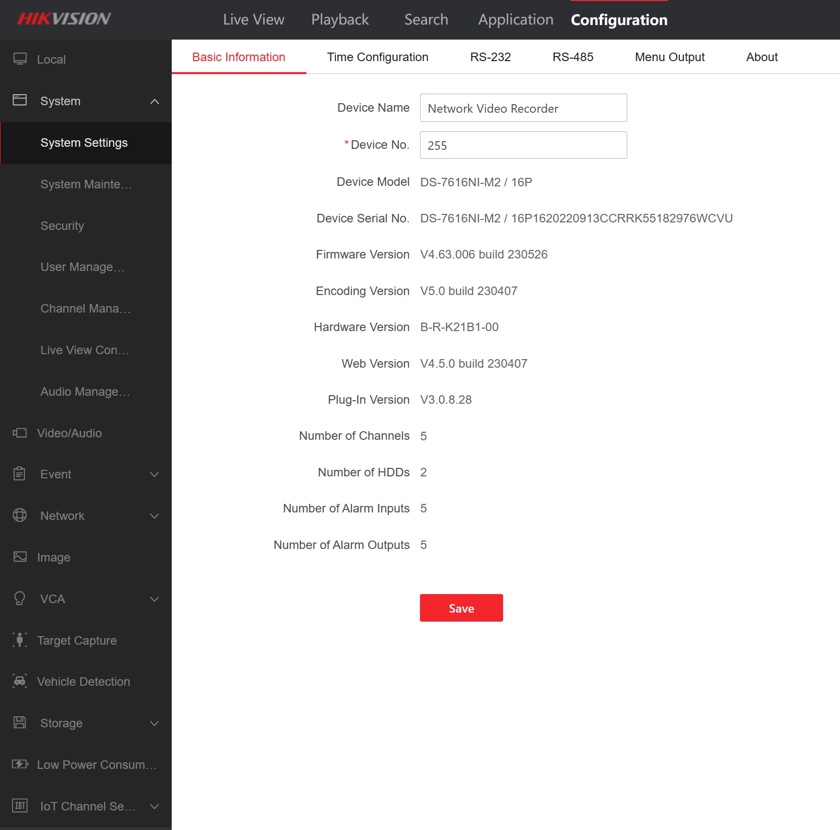

I've been testing and email images seem to be working for me now on V4.63.006 build230526.
Only one image is sent, but the NVRs do successfully send a picture on both motion detection and smart events, both when AI is on and when it's off.
I'm using a Gmail address to send the notifications - is everybody else seeing an improvement please?

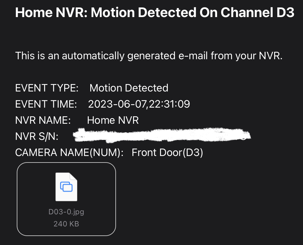

Unfortunately even with v4.63.006 I am still getting corrupt image attachments for emailed event notifications. My NVR is a 7716NI-M4/16P, and the camera is a DS-2CD2186G2-ISU on firmware V5.7.13 build 230504.
Thanks for checking, are the images corrupted in every email?
What type of email address are you using to send/receive the notifications?
Do you still get working images from the non-Acusense cameras?

I still get fully working email notifications with three images attached from non-acusense cameras.
On my acusense camera, most of the email images are corrupt, but maybe 1 in 10 comes through with a picture that can be displayed, only with one image though not three like before.
I use gmail addresses to send and receive the images, and that has previously worked fine for the previous 8 or so years.
It’s a bit ironic that I updated to an acusense camera and the NVR to a new M-series one that could deal with the acusense notifications in order to reduce false positives on motion detection but v4.63 firmware quickly making the notifications effectively more useless than before I upgraded the kit…
That's odd, I'm using the same camera and NVR firmware and all of the images work when I use a Gmail address too, both in the Gmail app and from a PC browser.
Just to confirm - will the images not open at all if you touch/click on the broken thumbnail?
The reason I ask is that I have a couple of broken thumbnail images, but the image does actually open.

UPDATE - I've been playing around and it looks like this is still a bug, but only affects motion detection when the AI (human/vehicle filter) is in use.
As soon as I untick "human" and "vehicle" for the target types in the event setup, the images begin to work.
I'll feed back to Hikvision, but I do have consistent working pictures when I use intrusion detection in Gmail and Outlook, so I can only recommend using that or push notifications in Hik-Connect until they fix the attached images for motion detection emails.
