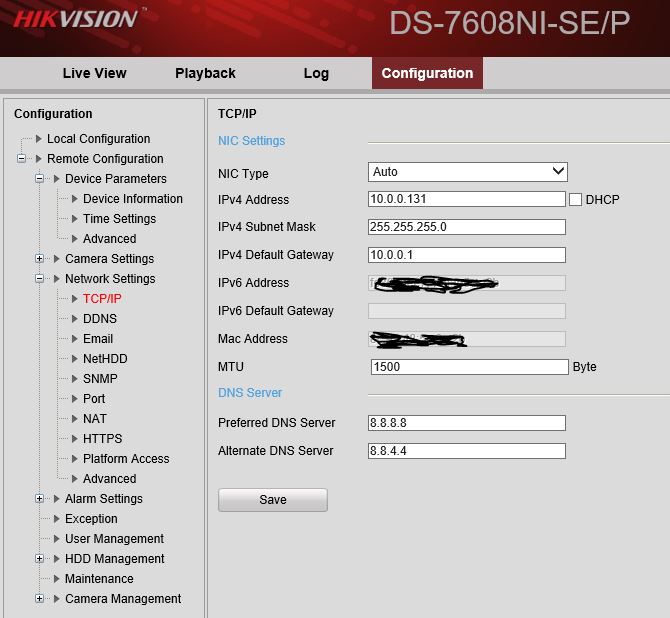

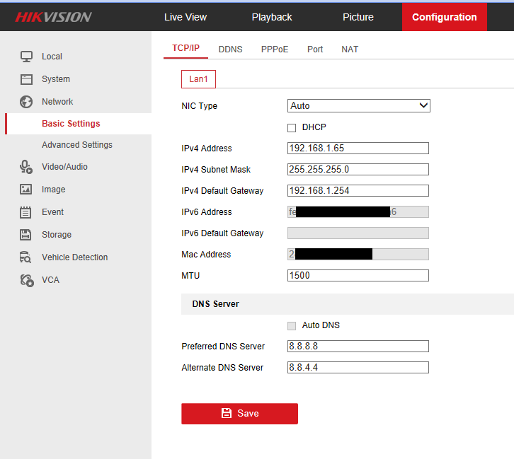

Have you fully set up your NVR's network settings?

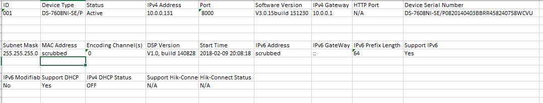

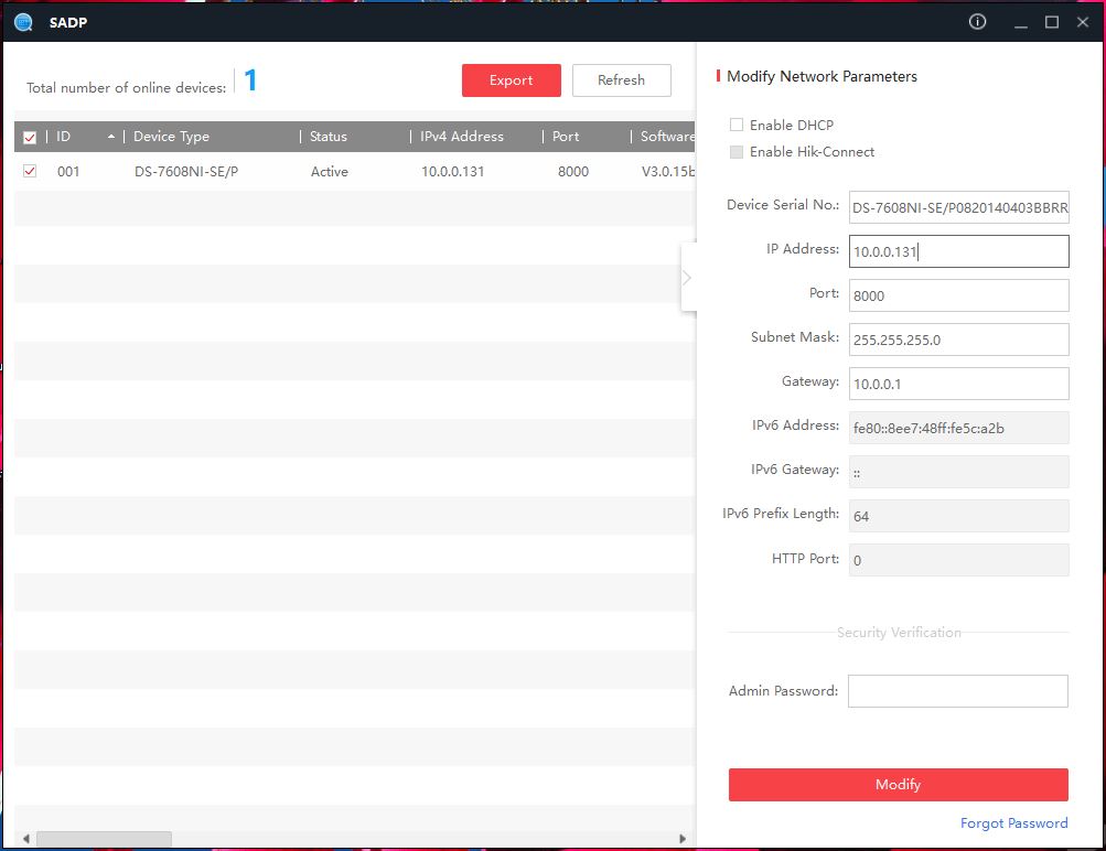

Hi Dave, Can you please run SADP when the NVR is online and send me a screenshot of the results?
(full-screen, with the right-hand side fly-out closed please, so I can see as much info as possible)

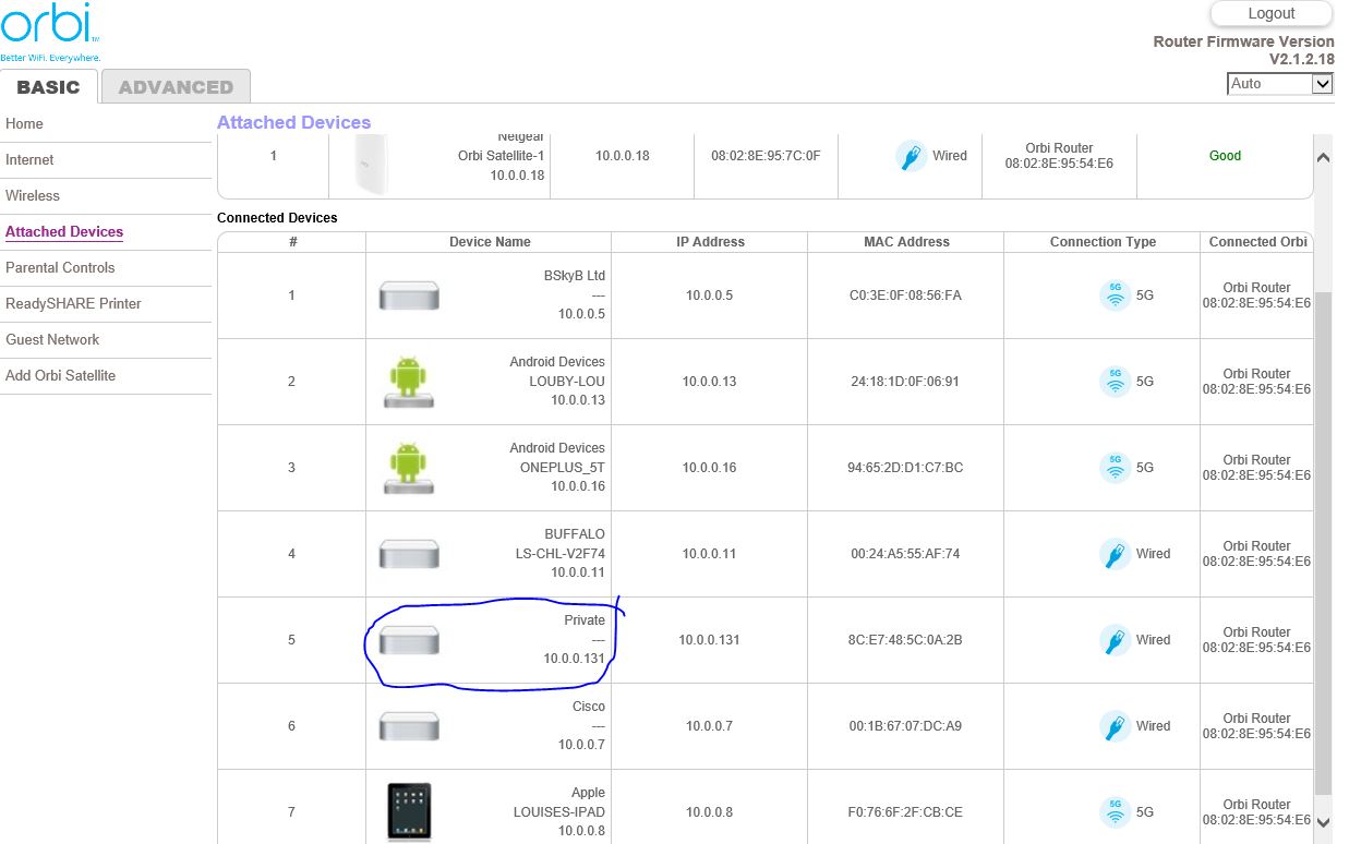

Hi Phil, see attached. Just back from working away. NVR been off 3days. Just went turned it on / off and straight back visible on SADP and browser/ivms. When I went to it, whilst power LED was on, I did not notice tx/rx LED flashing .. it did/is once I turned it on/off.

Hmm, I can't see anything wrong with those settings.
Can you reset the NVR and set it up afresh? It might eliminate a bug in there.
When you can't reach it, have you tried pinging the address of the NVR?
What does your network set up look like?
Do you manually allocate all the IPs?

IP's are manually defined for NVR and for camera downstream of that (different IP address range 192.168.x.x from the 10.0.0.x of LAN).

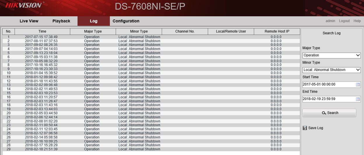

Hi Phil and Magic919. I have rebuilt ORBI and Router. No IP clashes on addresses. 7608 NVR set at static IP address. Interesting when I look at NVR log the 'disappearance' of the NVR certainly in Dec/Jan/Feb links to rough timing of 'abnormal shutdown' appearing in log (see attached). Most recently last night. All recording stops. SADP not able to see NVR. Reboot only obvious way around. A reminder NVR is on V3.0.15 build 151230. I cant see (or remember) when I applied that update but I recall Dec17.
Reading through various web-blogs, I have today tuned down the 6x cameras I have attached on mainstream from 1920x1080p to 1280x720P. Other variables staying as-is ie FR:25fps / bitrate=4096kbps / quality = higher / type = variable. This on basis of some blogs indicating that the NVR cant handle the volume/performance and CPU/memory in the NVR leads to abnormal shutdown. (I do recall having a memory leak error in Compaq servers back in my youth and until patch was released only way round was regular reboot).
Any more thoughts or does this change make sense?

No idea why you are seeing all those abnormal shutdowns.
Do you think it is actually powering down?
Have you ever caught it off/rebooting?
