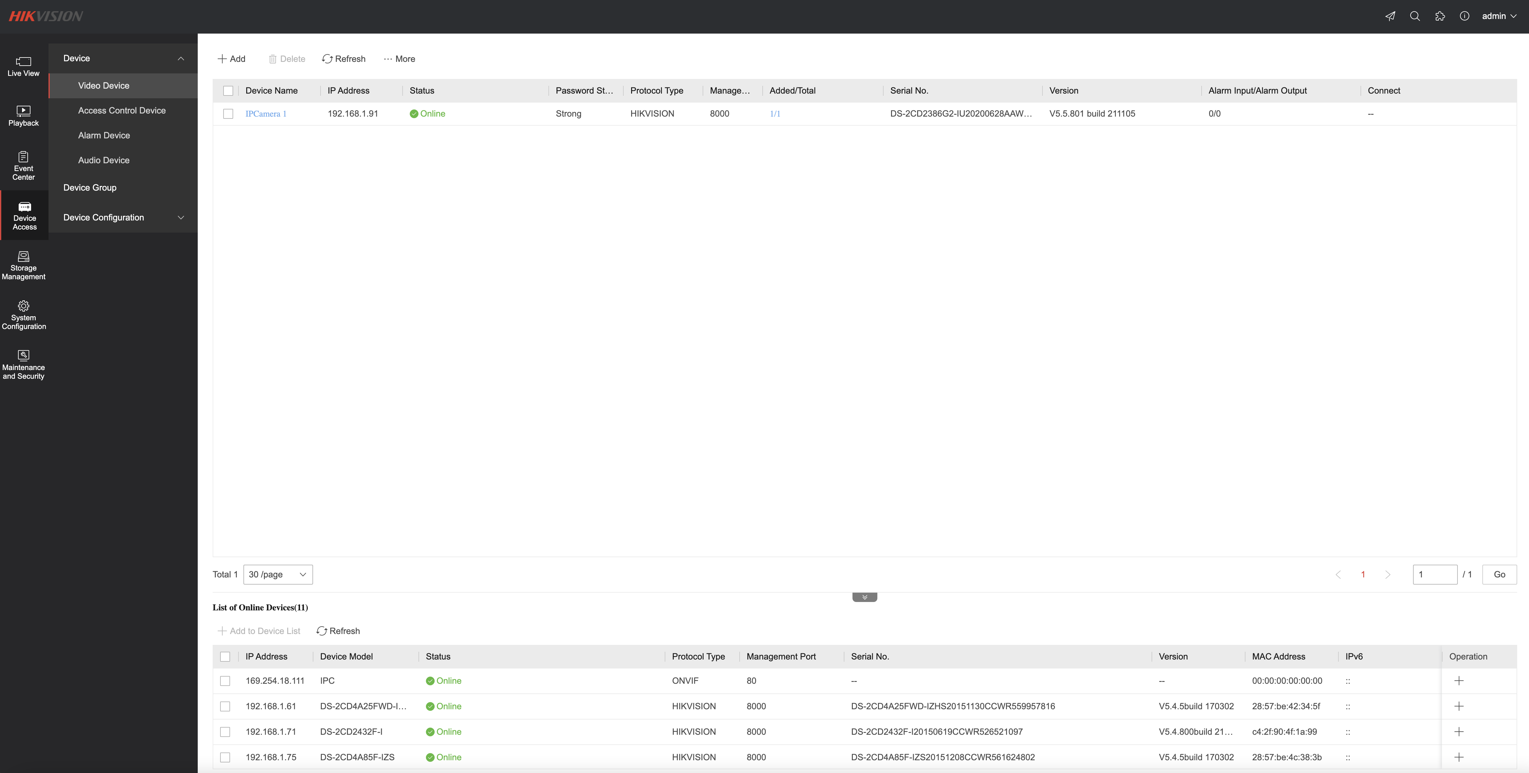

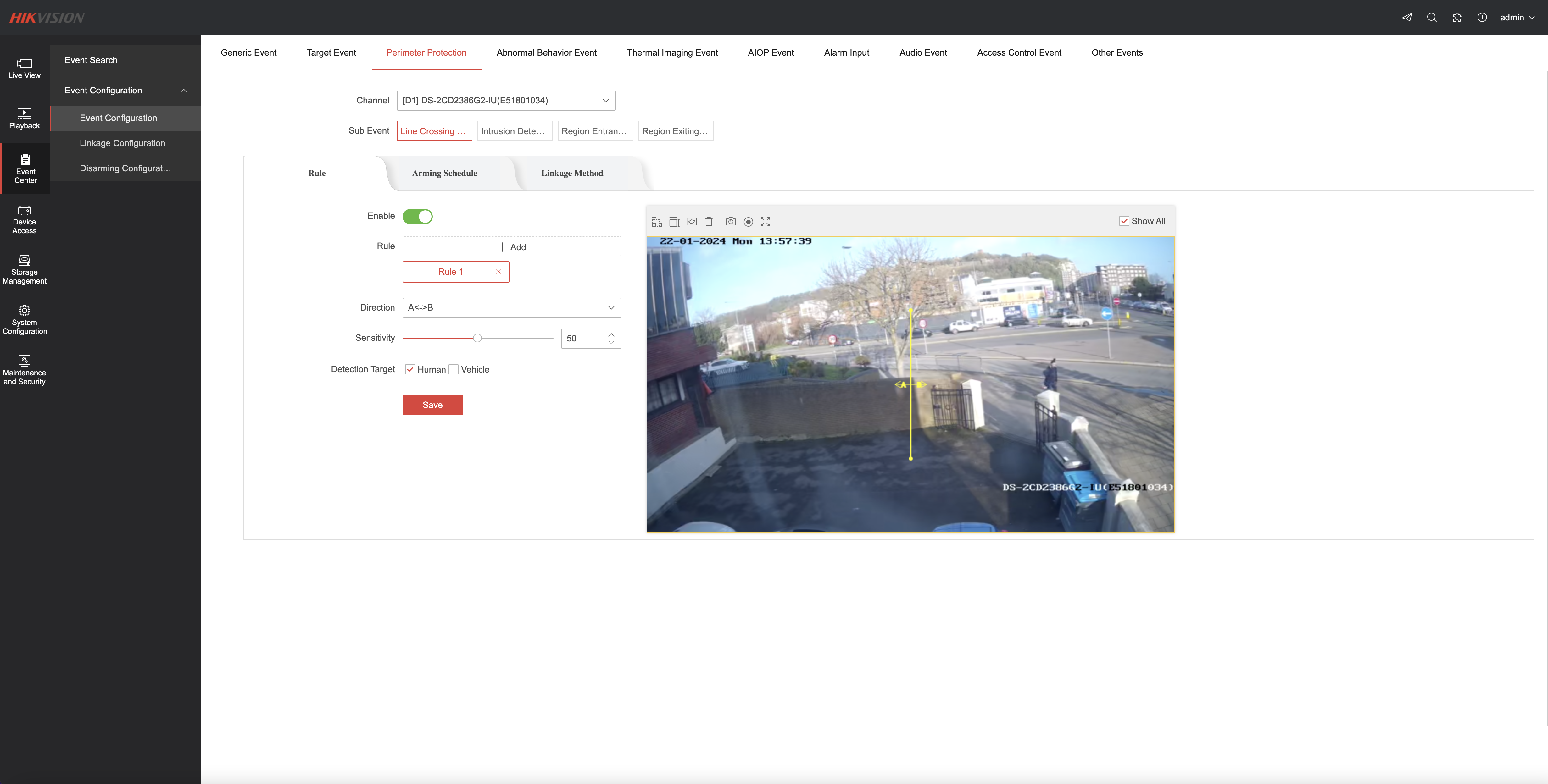

UPDATE - We've managed to update our DS-7608NI-M2/8P NVR to this new firmware and so far the new 5.0 GUI looks good.
Stylistically it looks like a mix of the existing 4.0 GUI and the Windows iVMS-4200 GUI.
The menu layout has changed quite a bit so we might be digging around for a bit trying to find certain settings.
If after updating there are any features/settings from earlier firmware that were broken and are now fixed or were fixed and now broken by this new firmware, please let us know so we can inform Hikvision support.
