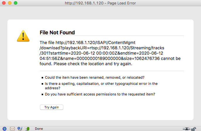

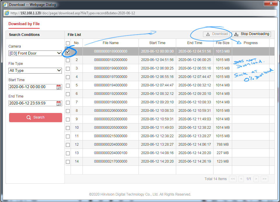

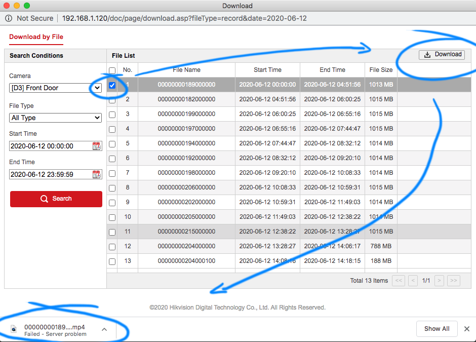

Not sure if its to do with the latest firmware (ive installed it on my DS-7604NI-K1 / 4P(B)), but I've now discovered that I am unable to download any playback video. Ive tried on Mac & PC, IVMS-4200, chrome, safari, SeaMonkey (Mac), Firefox, and IE (on PC). It says File not found.
I've uploaded 3 screen snapshots showing the errors received in 3 different browsers.
I have not re-set the NVR to factory settings since upgrading to V3.4.110 build 200212 as I need to download footage from last night of an attempted break in and do not want to lose the footage.
The playback files are there as I am able to view the footage, but at the moment, I am unable to download any files.
