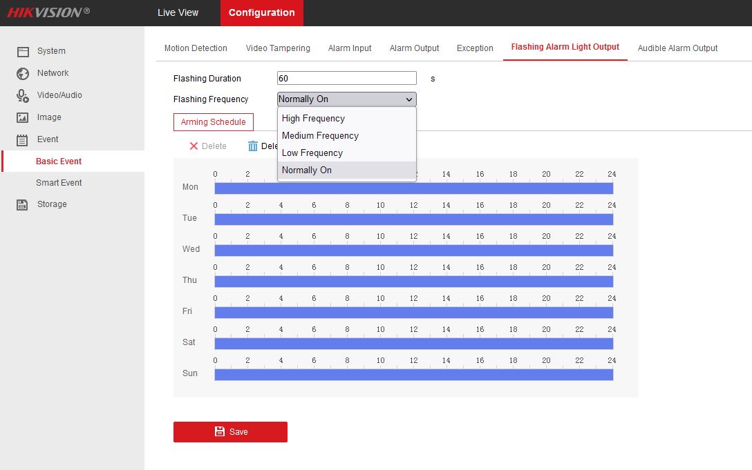

1 - If you want the static white light on event, then yes you need to get the models ending LU (2347/2387) but as stated above they're not an old model. They are current.
The LSU/SL liveguard model can also do the static white light on event (normally on) or flash with different are varying speeds
I hadn't noticed the 'normally on' setting for the strobe. That's enabling a different LED as opposed to the LED's used for illumination/exposure assistance. I'm not sure whether the output and spread of the single strobe light LED is similar to the illuminators but as there's only one, it'll probably only provide half the illumination for the image and it's not the same white. For those who are using the White Light on event to provide a usable image while leaving teh LED disabled otherwise, it won't produce the same effect.

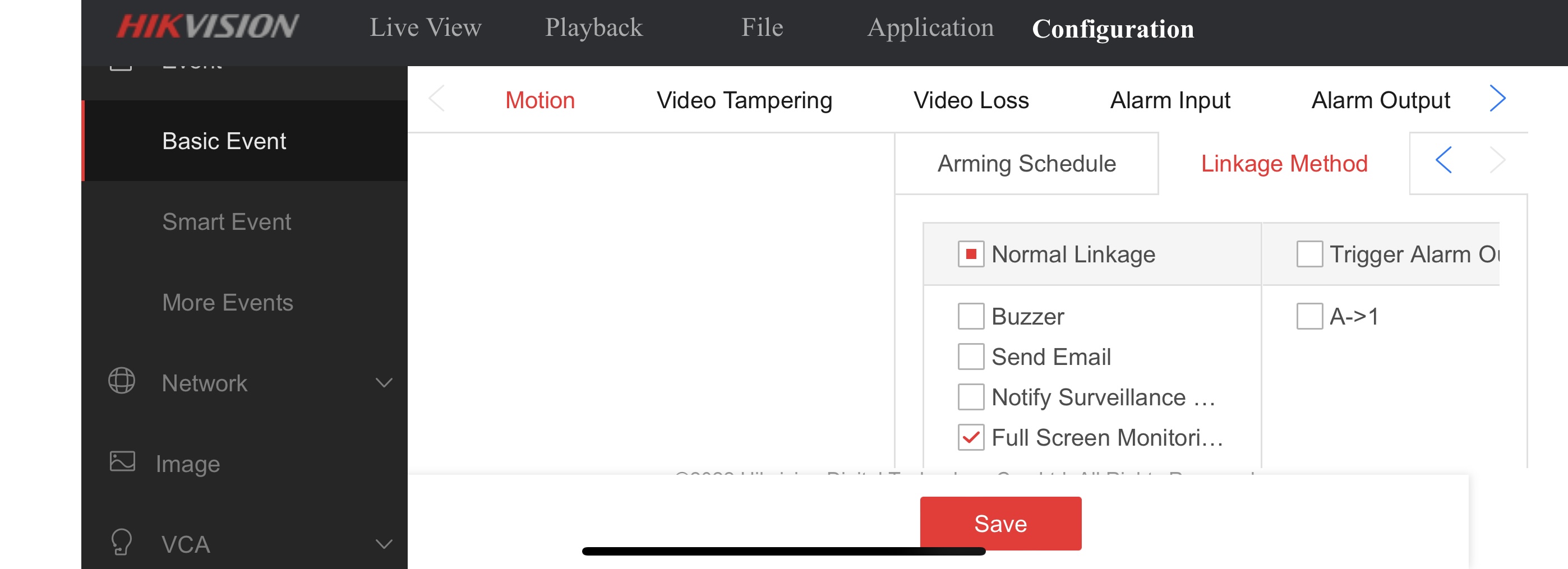

I updated to the latest firmware 5.7.13 and the light linkage on motion stopped working. To get it working again I had to enable full screen monitoring in the NVR. I am currently using the 2387 cameras with the 7608 NVR

Check what your build date of 5.7.13 you're on and update again if necessary. The original version was 5.7.13_230403 and a newer build of _230504 has been released to fix a few bugs.
Thankyou for this. Having just checked it was the one released in May that I installed
They're often released some time after the build date (_YYMMDD) so always be sure it's the newest build date from the product page on the Hikvision website (rather than looking at date added)
