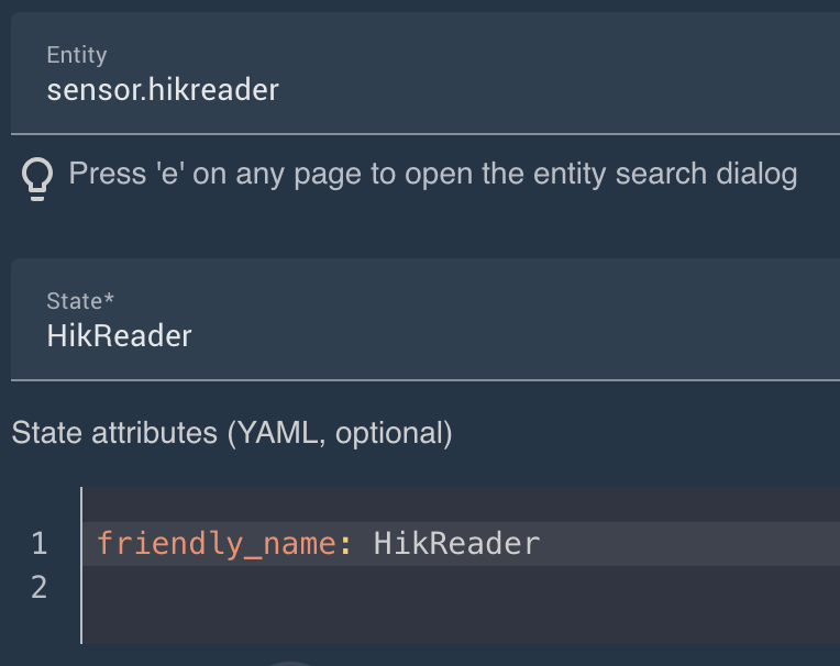

There is not any connectivity problem with the device. Actually, everytime I reload the REST ENTITIES, data is displayed fine. However, after the 10 seconds scan_interval is reached, sensor attributes dissapear. No issues if I reload manually in postman several times:
BEFORE
AFTER
Any clue of what it is happening? If not, next step will be to try to build this with a cURL command instead and parse response accordingly, but I thought this REST route would be "cleaner", as I would have all data as attributes in a single sensor.
