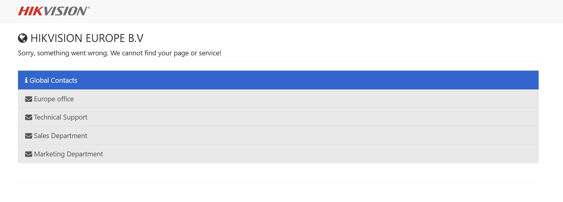

For me, non of these links work. Perhaps the site has been taken down?
Those links all seem fine this morning - checked from the UK.
Hi @warpy
We right-clicked the hyperlink and copied the URL, below is the URL we get:
-----http://www.hikvisioneurope.com/uk/portal/?dir=portal%2FProduct%20Firmware%2FHikvision%2F03%20Front%20Ends%2FSpeed%20Dome%20%28PTZ%29%2FG3%20Platform%28DS-2DExxxx%28S5%29%2CDS-2SE7Cxxxx%28S5%29%29%2FDS-2DExxxx%28S5%29%2FDS-2DE3Axxxx%28S5%29%28B%29----
For some reason, your link is adding "V5.5.802_210629%20%28Replace%205.5.41%29" to the end of the URL (this text is the text that comes after the last URL link in the original post)
Another forum user reported another very similar issue and they resolved it by disabling Ad Blocking software, disabling all browser extensions, and trying a different browser. See below:
Hi @warpy
Thanks Dan.
I managed to manually navigate to the location using the folder names in the link. :)

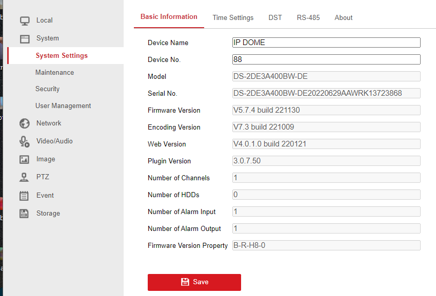

Hello,
why the latest firmware (Firmware_V5.5.803_211112) is a smaller number than mine: V5.7.4 build 221130
What is wrong?
Hi @poznai
v5.7.4 is actually the latest version available for this model and can be downloaded from the Hikvision product page.
Unfortunately, Hikvision doesn't always update the firmware portal so you have to check both the portal and website for the latest firmware.
I have noticed that because I have a pro series, I can't download value series firmware for this model. (The type of upgrade file mismatches)
