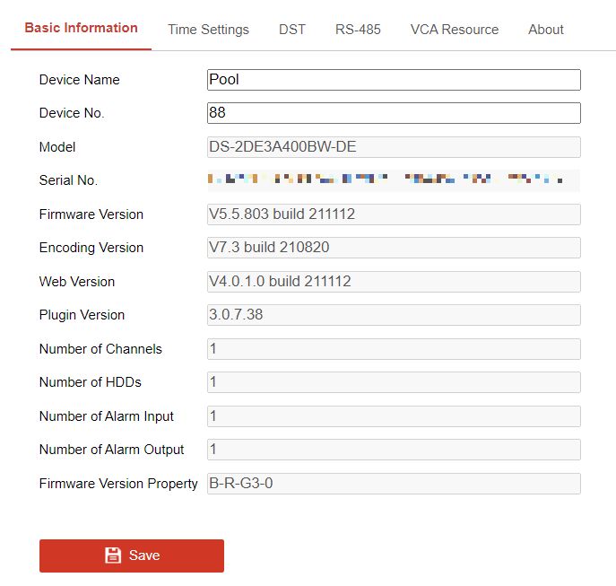

Can you please log in to the camera, go to Configuration > System > Basic Information, and confirm what the "Firmware Version Property" is for this camera? (should be the last box at the bottom of the Basic Information menu)

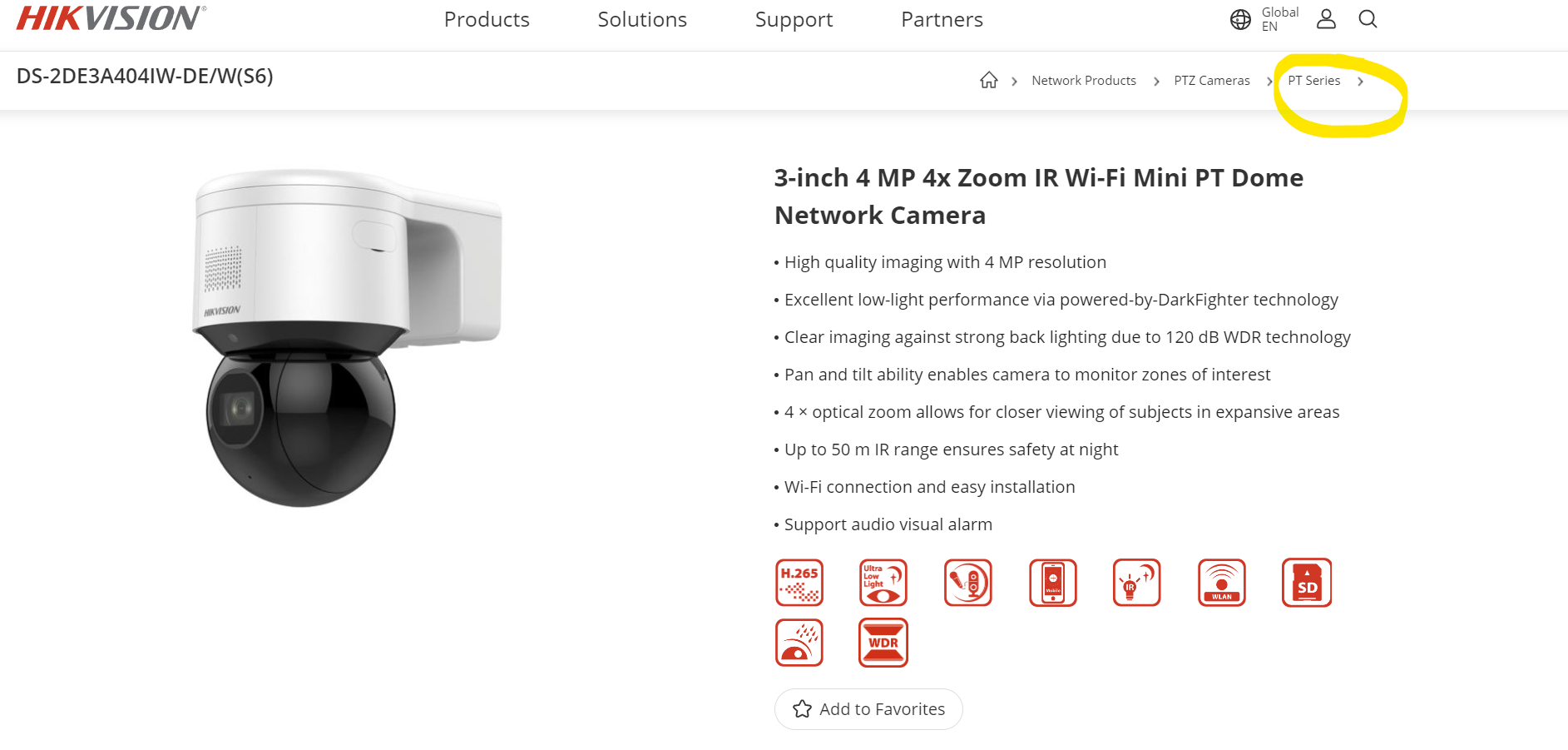

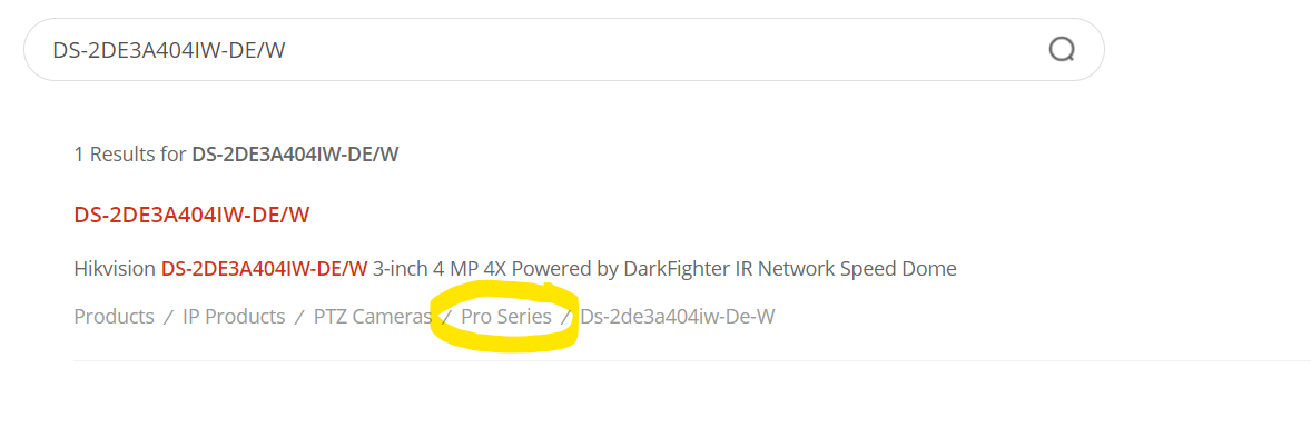

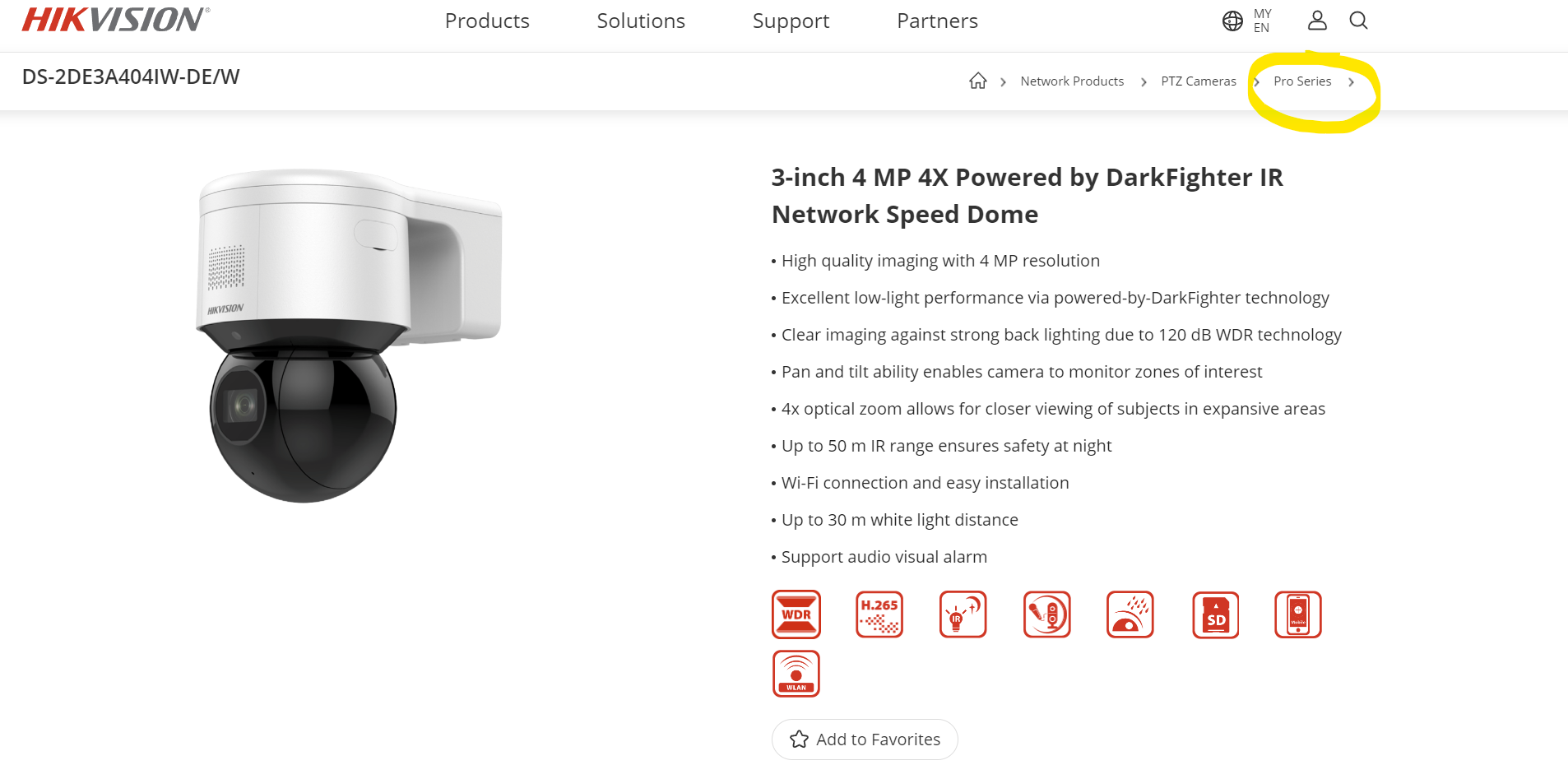

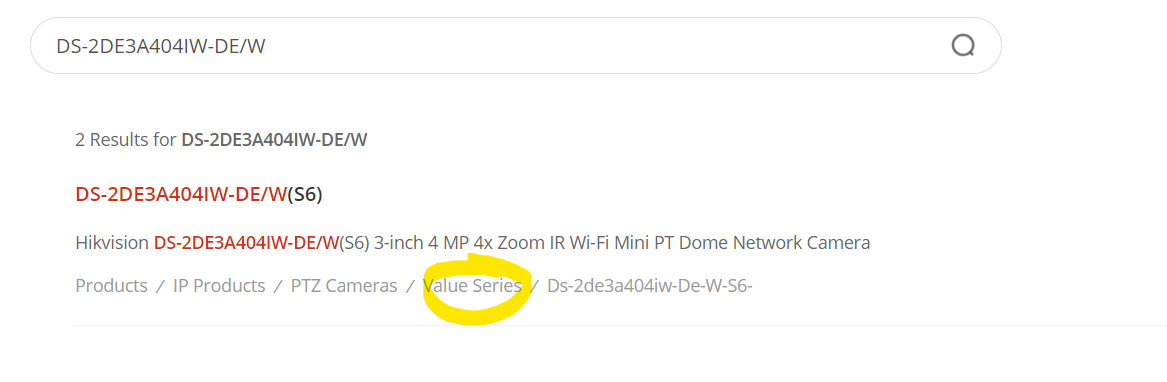

Hi Dan, sure here is a screenshot. I have attempted to download every single firmware from value series and it fails. Only pro works from the American site around 6 months ago, which has now been removed, please take note of the directory structures here:
Note: The region showing the pro series version doesnt have the option for a firmware to download: DS-2DE3A404IW-DE

Thanks @warpy
As I expected this Pro version of this model is clearly region-specific (either US or Malaysia - that Pro webpage is from the MY/Malaysia Hikvision website) and you probably won't be able to use any firmware from our usual UK/EU firmware sources.
If the Pro model has been removed from the US site then that might suggest this model is going EOL and there won't be any new firmware for it.
As it is an obscure model that has never been for sale in our region there isn't much help we can offer, we can only recommend that you try getting confirmation (via your original seller or Hikvision directly) as to whether or not there is newer firmware available for this model.

One final thing that I just noticed, the product pages you've screenshotted above are not actually for your camera model.
They are all 3A404IW models but your model is a 3A400BW and might use different firmware to those models you've been looking at.
Have you tried updating to the V5.8.0_231109 firmware that is on the Australian Hikvision product page for the DS-2DE3A400BW-DE(T5)?

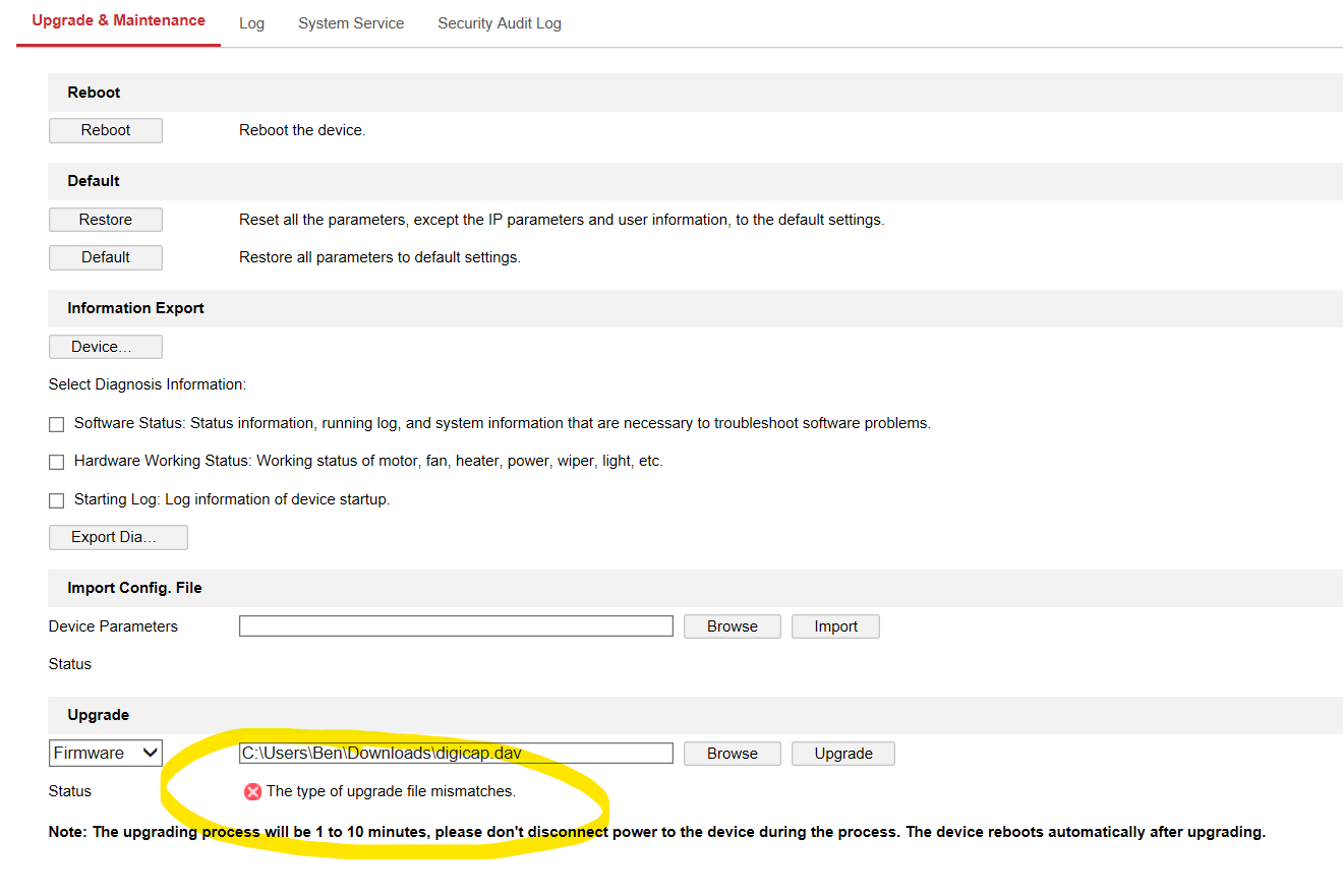

Thanks Dan, I sure have it is just shows the progress bar when updating and goes from 0-1 and then back to 0 again and then the progress bat disappears with the following:
