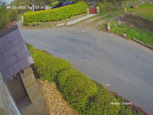

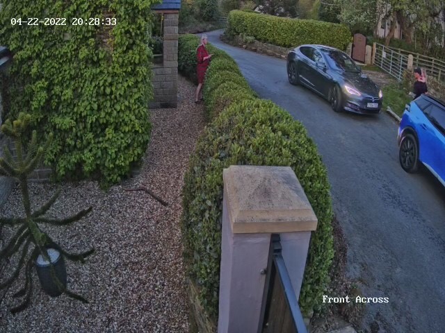

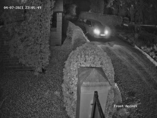

Thanks Phil really helpful. It’s made me think I may be as well now looking at anpr as one of the main needs is capturing vehicles on road day/night and getting reg numbers. Currently have two HIK cameras as highlighted in attached pic. Both G2 / 8mp and whilst spotting vehicles, they aren’t getting the registrations. My initial thought was raytec under the alarm box on front covering across the road.
vehicles max speed around 30mph.
if anpr then would you replace the higher (front of house) or lower (on pole in hedge) camera. I’m thinking higher as that would also give more ir helping other camera.
thanks in advance.

Hi @Dave Howard
ANPR is a tricky thing, numberplates are very reflective and bounce IR light back into the camera sensor (as you show in your above screenshot). To get around this reflection ANPR cameras have their sensors configured in a very specific way so they are less sensitive to bright reflection, the low sensitivity removes the reflection but also makes the surrounding image much darker to the point where you won't be able to make out much useful detail other than the plate. (see this demo video for a rough example of the kind of night image an ANPR camera will produce)
If you want to use ANPR you would probably be best off using it in conjunction with a standard IR camera like the one you already have installed because that will capture more of the scene detail (shape/make of car and maybe even driver if close enough), while the ANPR will clearly capture the plate information.
Just so you are aware, the camera in the demo video is the slightly older version of this model which is a top-spec ANPR model. This is why you can see advanced features like car brand and colour, but not all ANPR models will support this feature. Also, this demo is filmed on an urban street with some strong street lighting and so in your more rural scenario, the image would likely be darker than the demo video.
