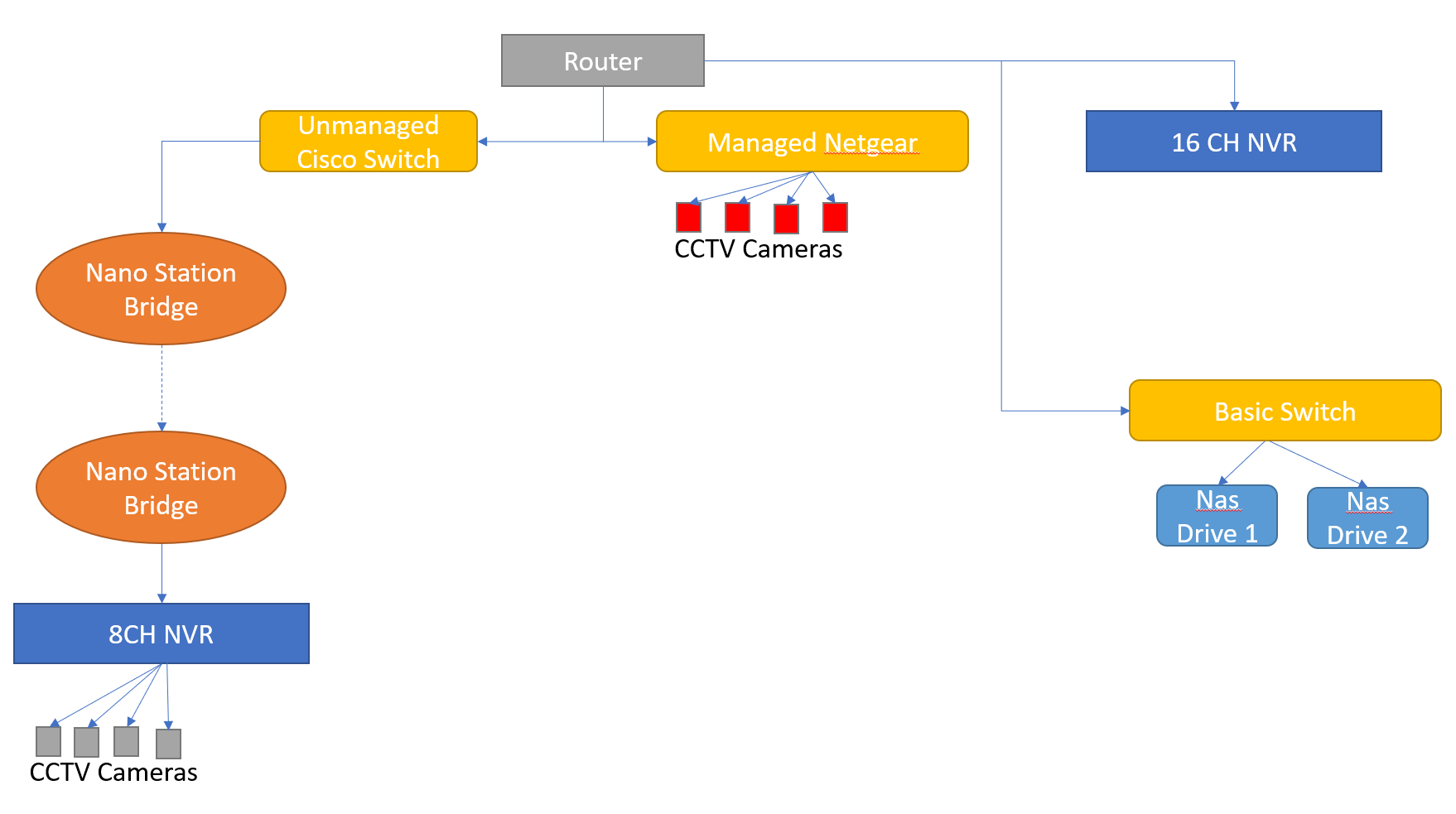

Hi David,
Could you sketch a diagram out and let us know the device model numbers?

Please see the attached sketch - I hope this helps.
The Cameras shaded Red are the ones that have failed.

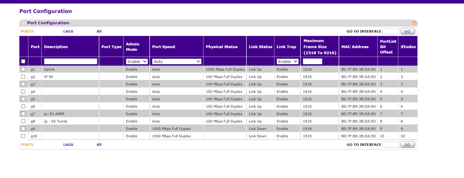

I can ping the Netgear Router - but not the cameras connected to it. THe Netgear seems to suggest that they are ok.
See Pic below

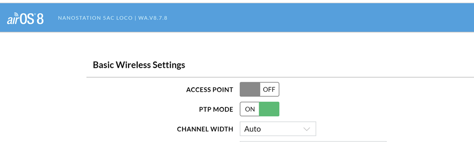

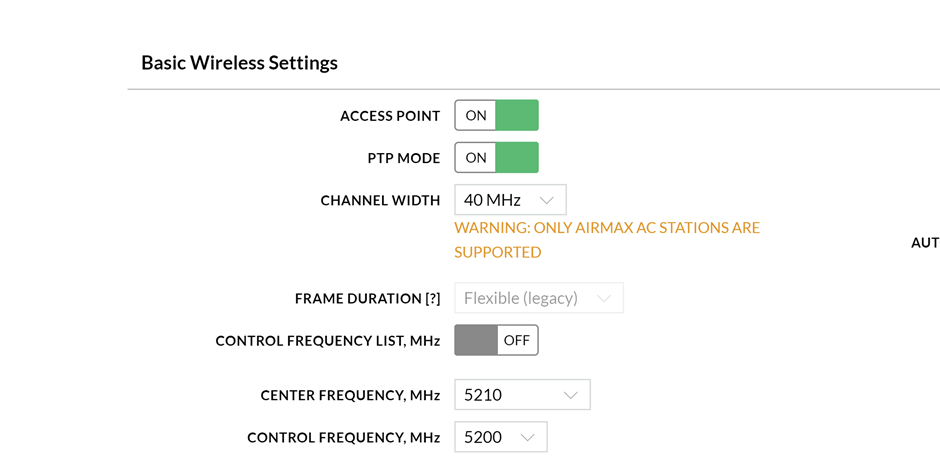

As for the Nanostation Bridges
This is Router Side
This is the “far” side
