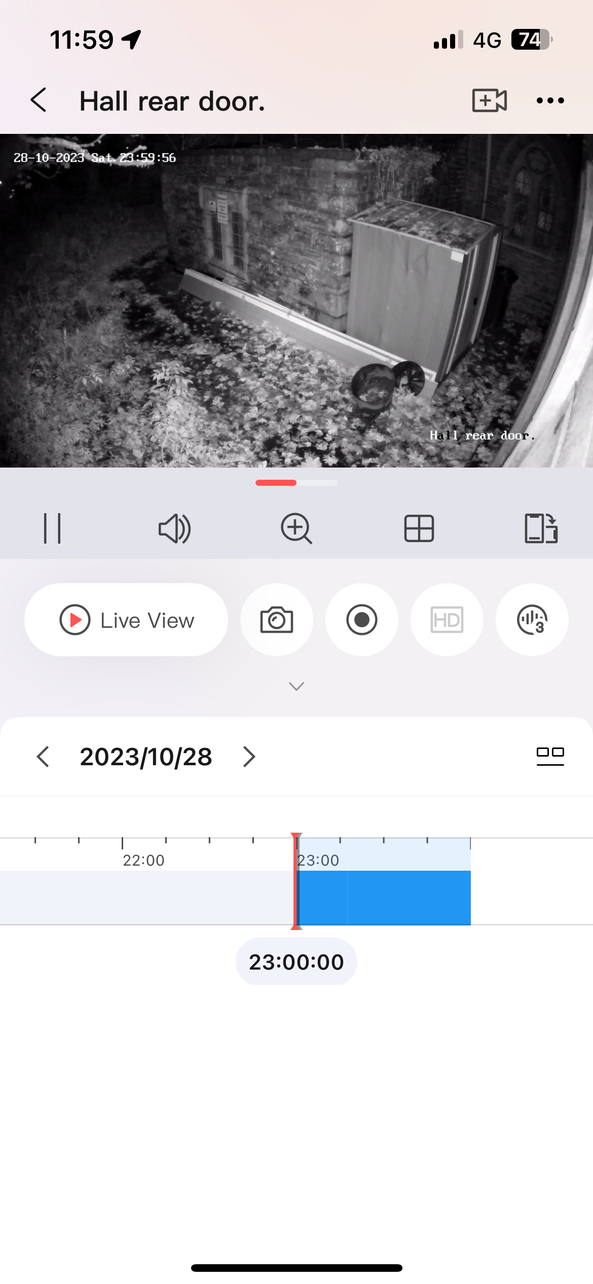

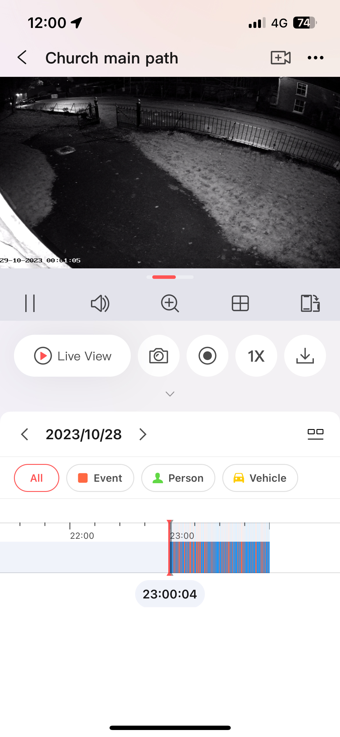

Mine's the same - don't think Hik-connect has ever handled daylight saving very well - but seems this year they've really broken it. Can't see anything but 1 hour for every day of recorded history on any camera, any NVR, anywhere across my installs. These are all different sites and different NVRs:

I should add that the recordings on the NVR's themselves are all ok - it's just the Hik app.

No I just checked. Even if you connect to your NVR using its local IP address while on the same network, there’s only 1 hour available (11PM til midnight).
As it affects connections using IP/Domain as well as cloud (Hik-Connect service) I imagine a new version of the app will be required.

The recordings since have resumed - but the previous days still show only the one hour. It wasn’t just one day, but the entire recorded history, and the problem is still there. Hasn’t been fixed yet. If you look at any day prior to it being spotted in the app, will only give you one hour recording access. You can access on the NVR directly - but not through your iPhone.
Upvote 0
Historically on daylight savings time change day hik connect (in my memory) never worked properly - but at least it still showed an entire day for every day prior. It was only the time change day that was affected. This year it seems to have done something that’s affected every other day before it as well. So instead of just being mucked about for one day twice a year - it seems like we’ve lost phone access to historical data- that’s never happened before.
