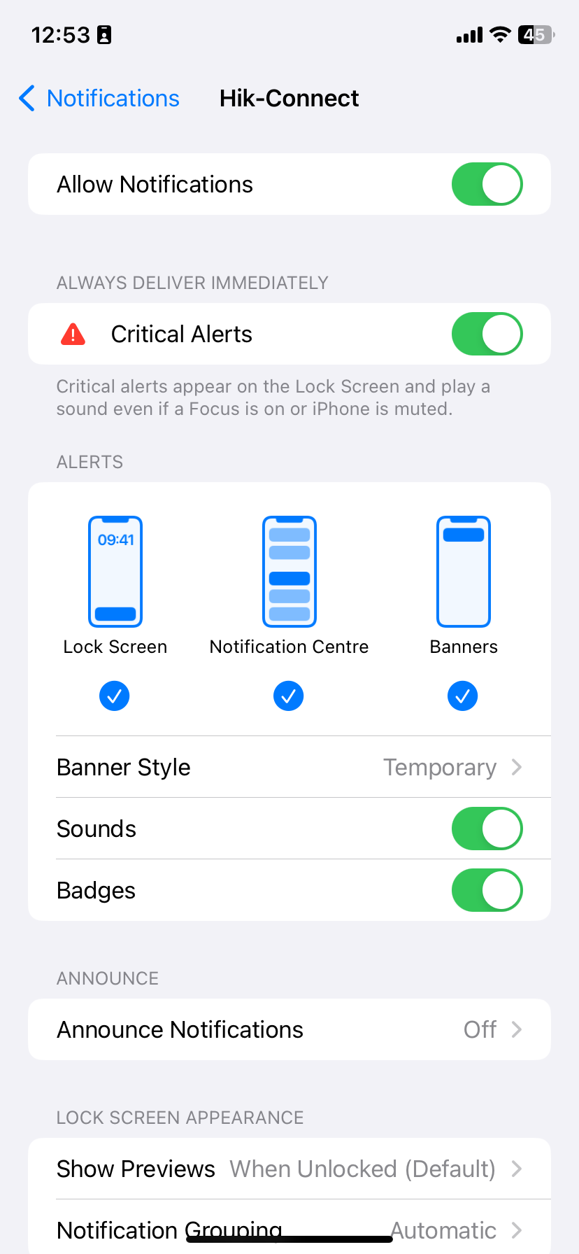

I also recommend checking that you have not got one of the focus modes enabled on the iOS devices, and that notifications for Hik-Connect are turned on both in the iPhone/iPad notification settings - try enabling "Critical Alerts" too, which will override the focus modes:

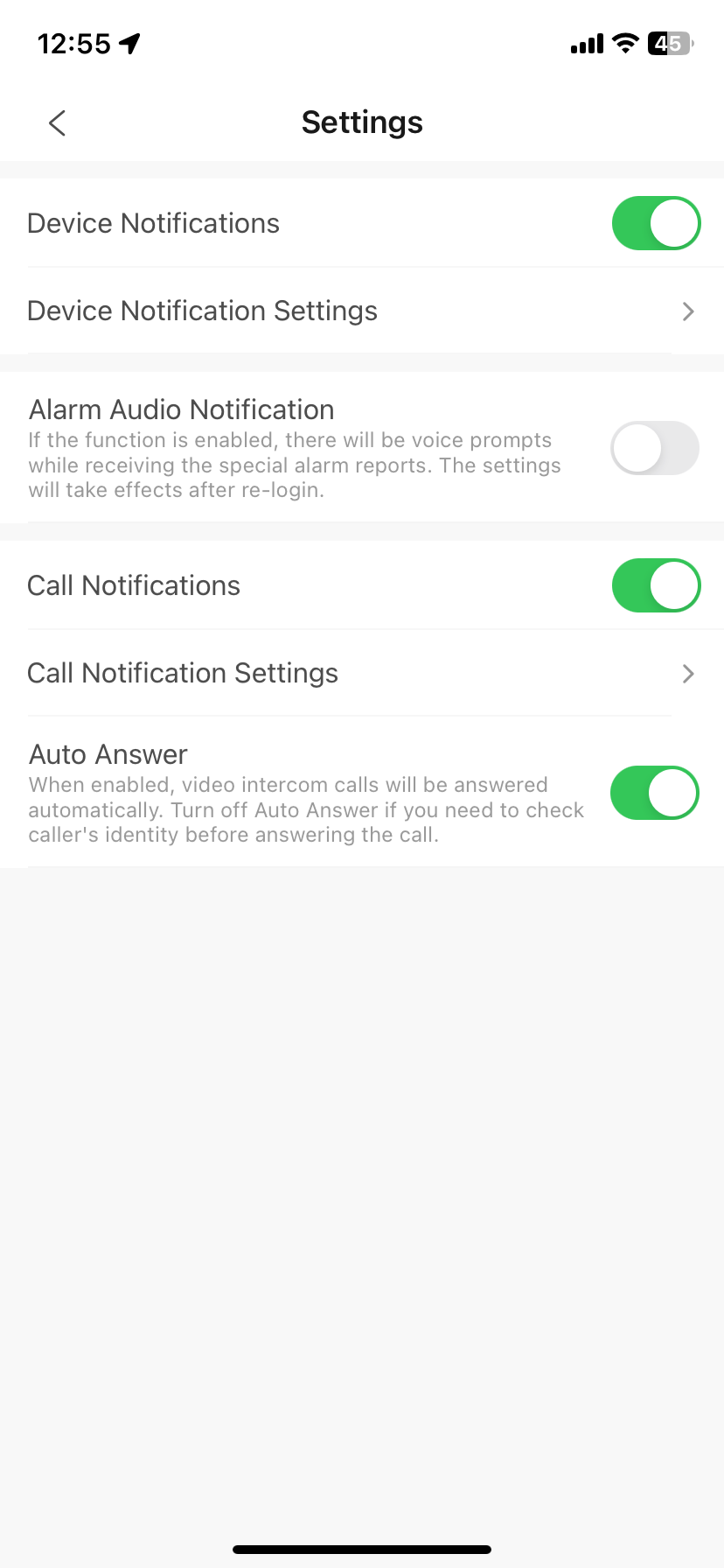

Check you have notifications enabled in in Hik-Connect itself, by going to Me>Settings>Notification Settings:

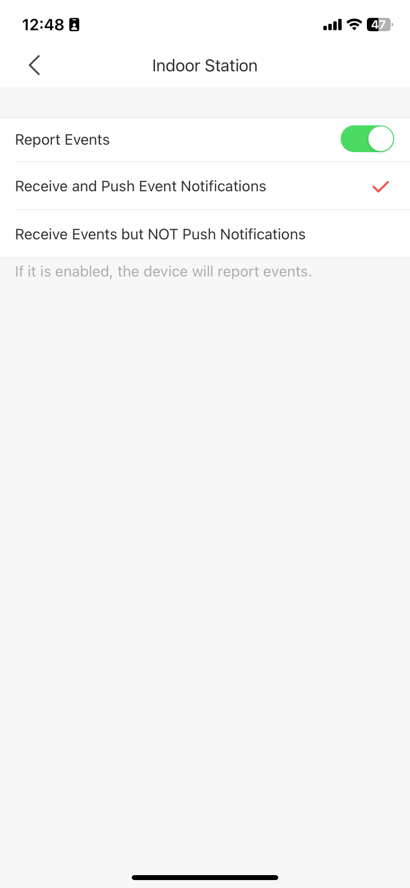

Also, Device Notification Settings, check that push notifications are not disabled for the indoor station - it should look like this:

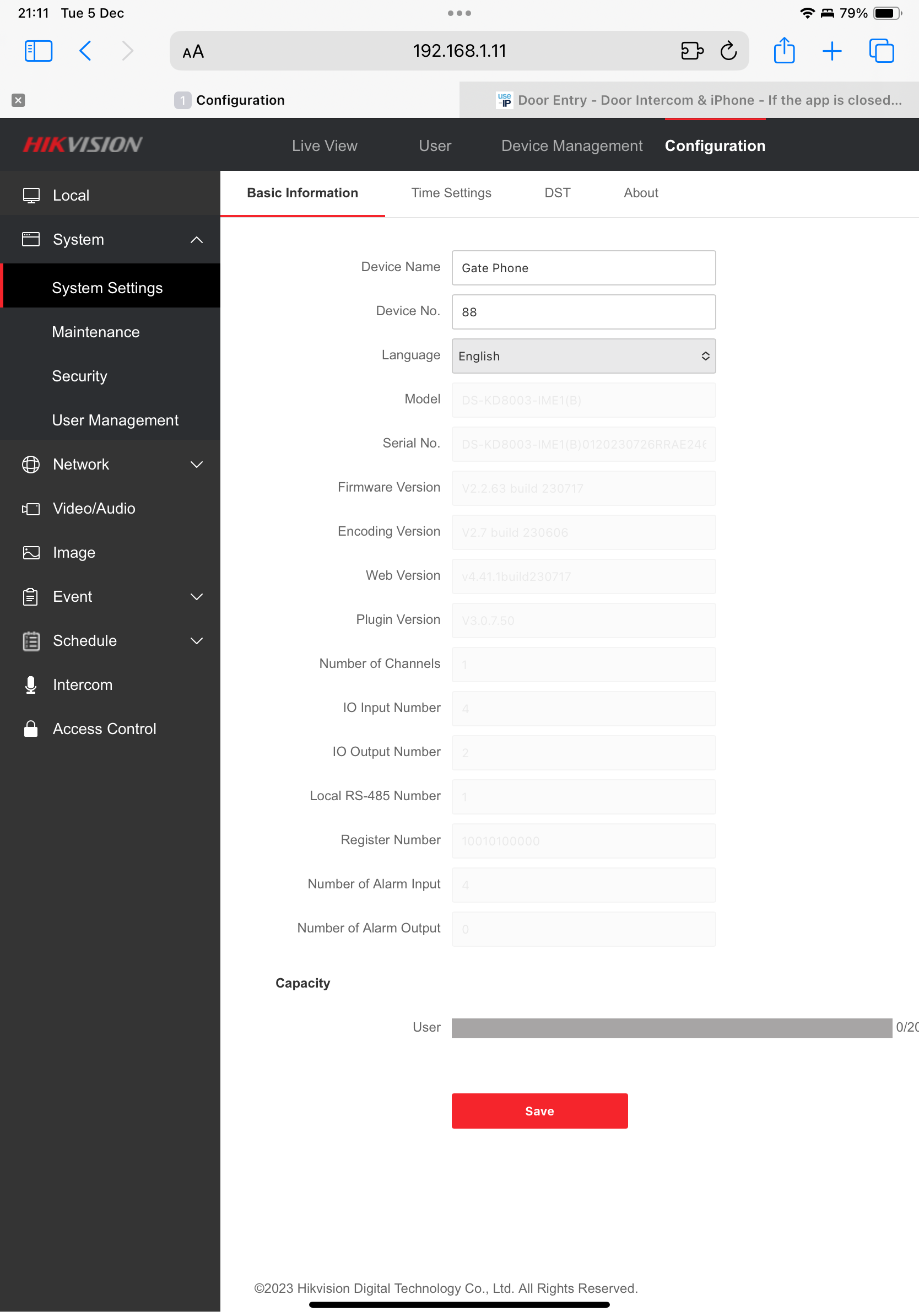

  • With a web browser navigate to the IP address of the outdoor station and login with the admin user
  • Once logged in. Configuration > System > System Settings > Basic information
  • Change Device Name from the default of 'OUTDOOR STATION' and click save

I don’t think the KD8003 can directly connect to Hik-Connect? It is connected via the indoor station to Hik-Connect. I have changed the name under Configuration>system>system settings>basic, but the change is not being reflected. Perhaps I need to logout and log back in to Hik-Connect. I’ll try that in the morning.

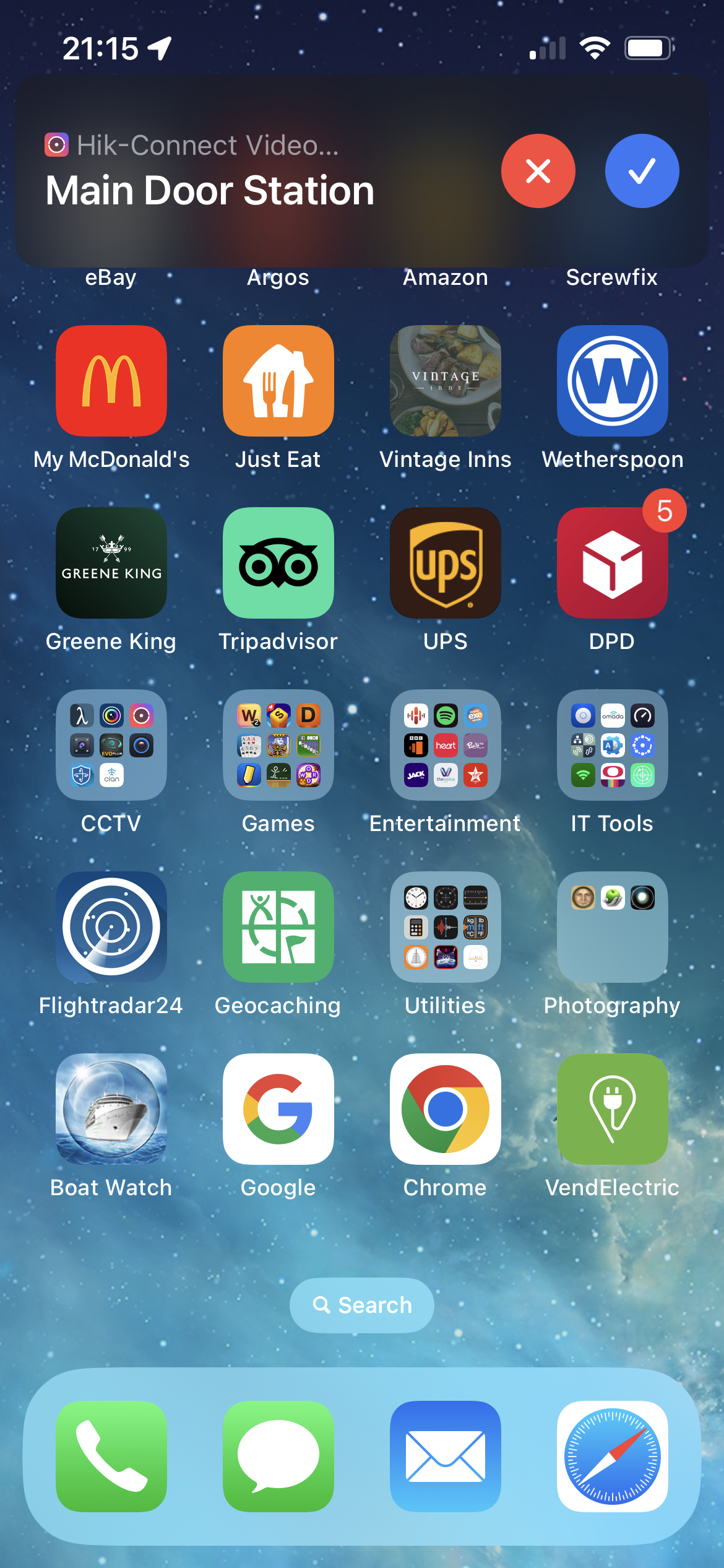

I couldn’t wait until morning, I just tried logging out and back in on the app. The device name in the app now displays correctly, but the call still comes through from “main door station” :-/
