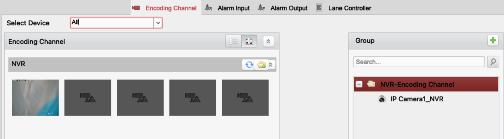

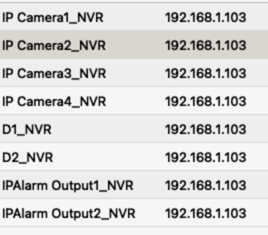

I have had a breakthrough!
I went to "Group" under "Device Management" in ivms-4200.
I chose "Import" and the camera view showed up, I clicked on the image that showed on the left (my one camera).
I imported it.
Then went back to main view and nothing showed. Double clicked and it it gave a slightly different error message - not able to connect.

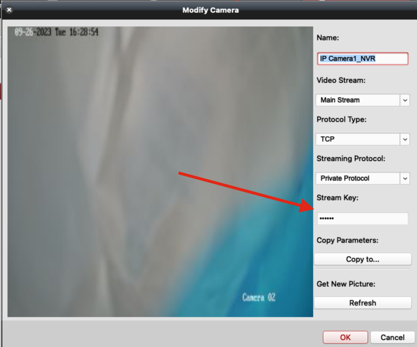

Then I went into the "Modify Camera" settings and inserted the encryption key in "Stream key".
At first nothing happened, but after jumping up and down and saying a few prayers, the live stream appeared!
I'm so relieved.

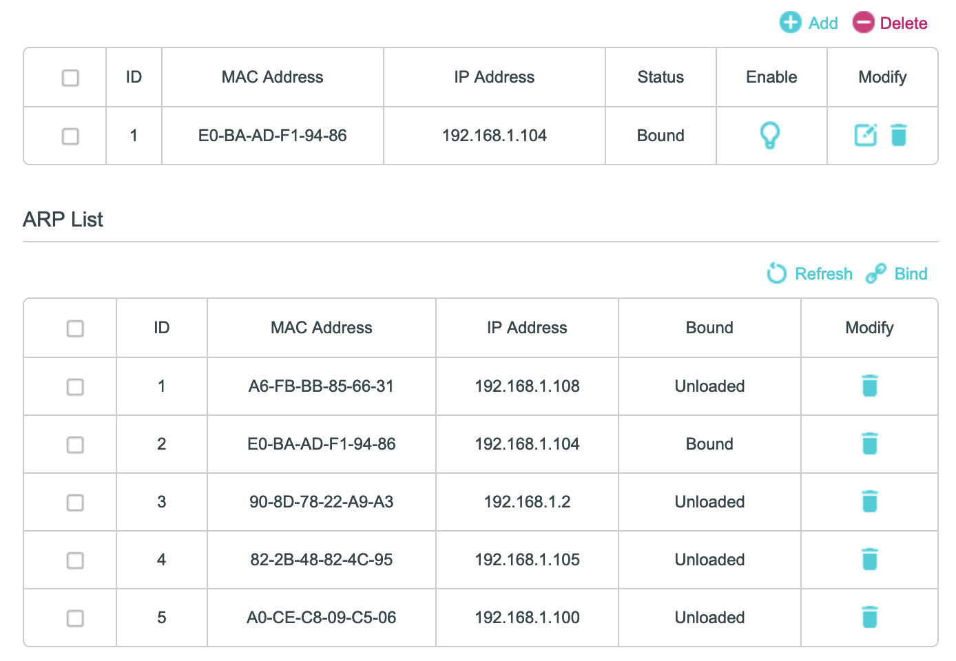

I've bound the NVR's IP - you were right, it did change after resetting the router. I had to re-do the cameras - for some reason this time they were already added in the group under the NVR along with alarms etc. Pity that wasn't the case when I embarked on this, or I would have at least seen the streams and realised that they were encrypted for the main view!

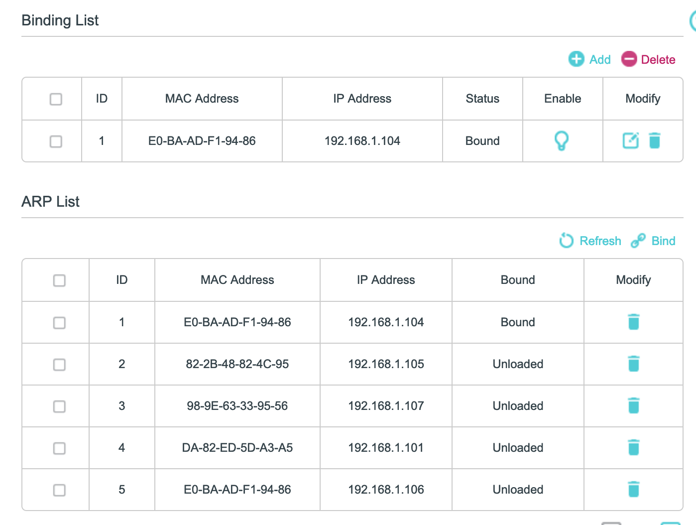

Hi @David
Not sure if you're able to assist. Since binding the IP of the NVR, each time I've restarted it gives me a different IP. I've no idea why it's not sticking. Bound to .104, now it's .106. Any ideas what to troubleshoot?

Check the MAC address of the NVR WAN (ethernet) port is correct.
On the binding list is line id 1 enabled?
Are you just restarting the NVR or router and NVR?
Does the router firmware need updating?

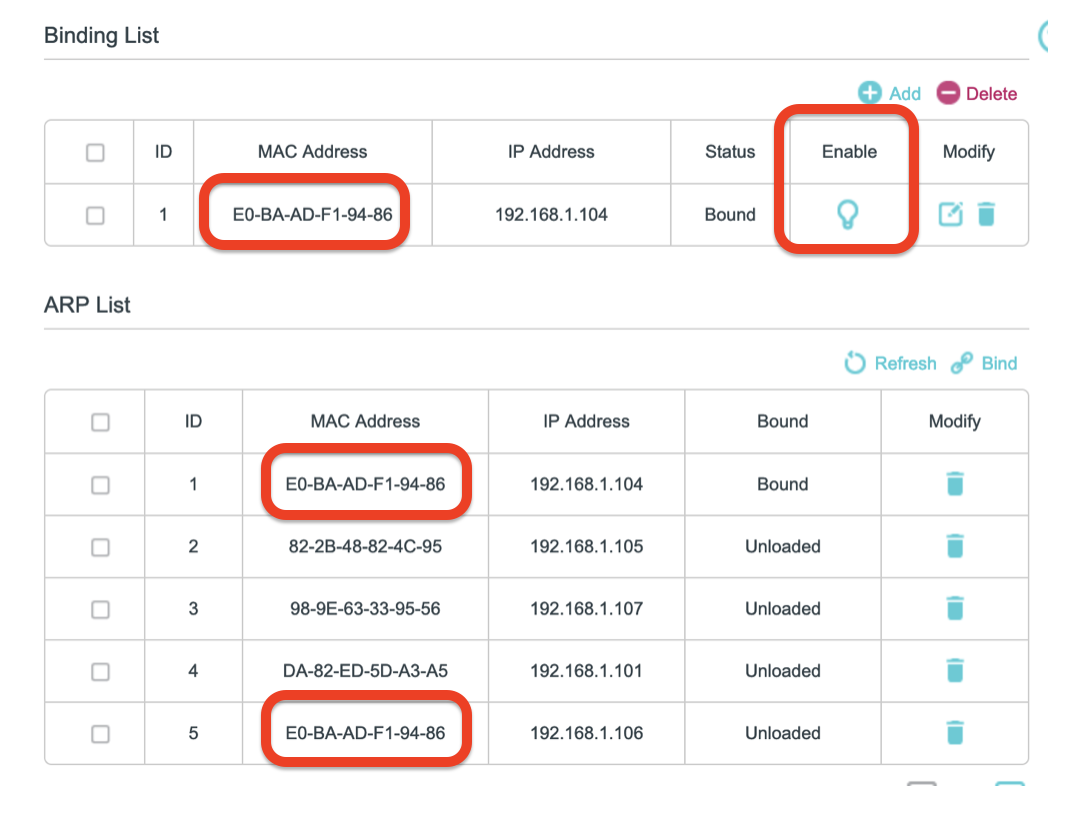

Thanks for responding David.
I'm not sure what to do,because even though I've bound it, it keeps changing.
Just to be sure, is the "enable" icon supposed to be like this

I would say the icon without the red ring is enabled. The ARP table list shows both IP addresses (104 and 106) linking to the NVR MAC address, did you reboot the router after creating the NVR MAC binding to 192.168.1.104?
Make sure your router firmware is up to date.

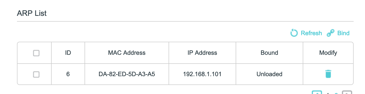

Yes, rebooted router and NVR. I enabled DHCP again. It's now decided on .101 but shown as bound to .104
I've been struggling here on another thread to upgrade - managed the cameras but not the NVR. Waiting to find a resolution.
ARP List ID 6 has a different MAC address against IP 192.168.1.101, can you post the NVR WAN interface MAC address?
