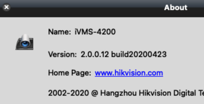

I've successfully upgraded the NVR firmware thanks to a file sent to me by Hikvision. It only wanted to upgrade using ivms-4200 for some odd reason.

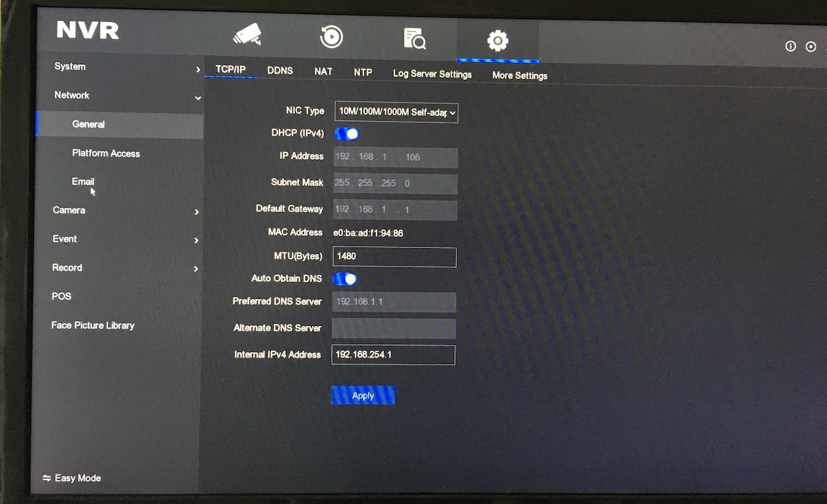

The NVR has been using .101 as the IP, even though it was bound to .104. So I decided to bind it to .101. Rebooted both router and NVR and it hopped back onto .104!
So if firmware is not to blame, could it be my router? I've looked up issues to do with TP-Link Mac binding, and their help is not very helpful.

check NVR enable DHCP
