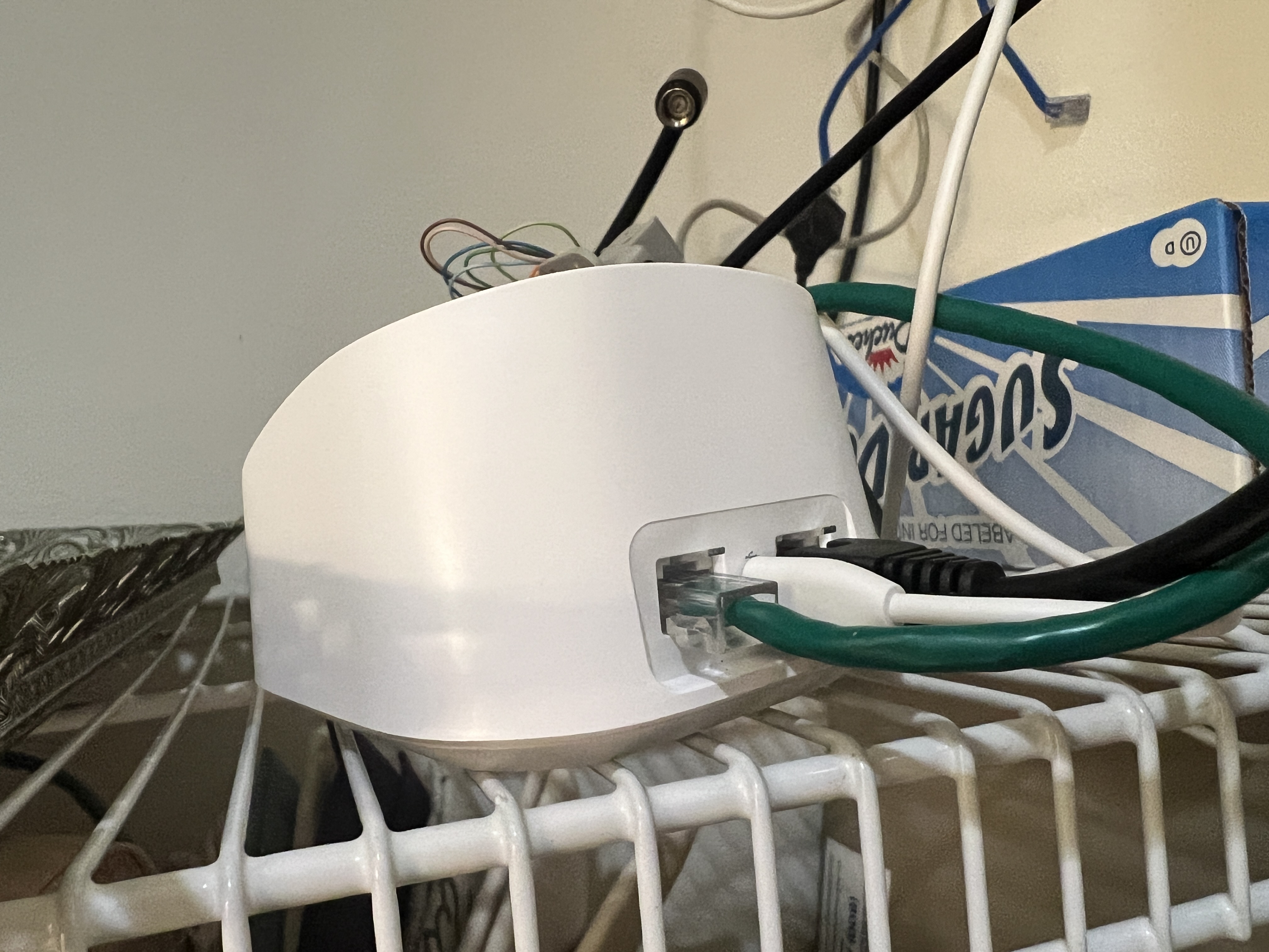

I do not have another router, this is a photo of the back of the router (power cord, 1 in and 1 out port ) I do not know if I need to reconnect the
system using the main HICVISION box or the app on my phone.
Which of the green and black ethernet cables connects to the NVR LAN port?
Using the TV screen and mouse, do you have access to the NVR setup screens? If so could you post the network setup page?
Can you also post the IP address assigned to your smartphone or tablet?
Your NVR model number is DS-760865391, is this partly from the serial number? The DS-7608 usually has a different suffix to identify the model, mine is DS-7608NI-I2 / 8P.
