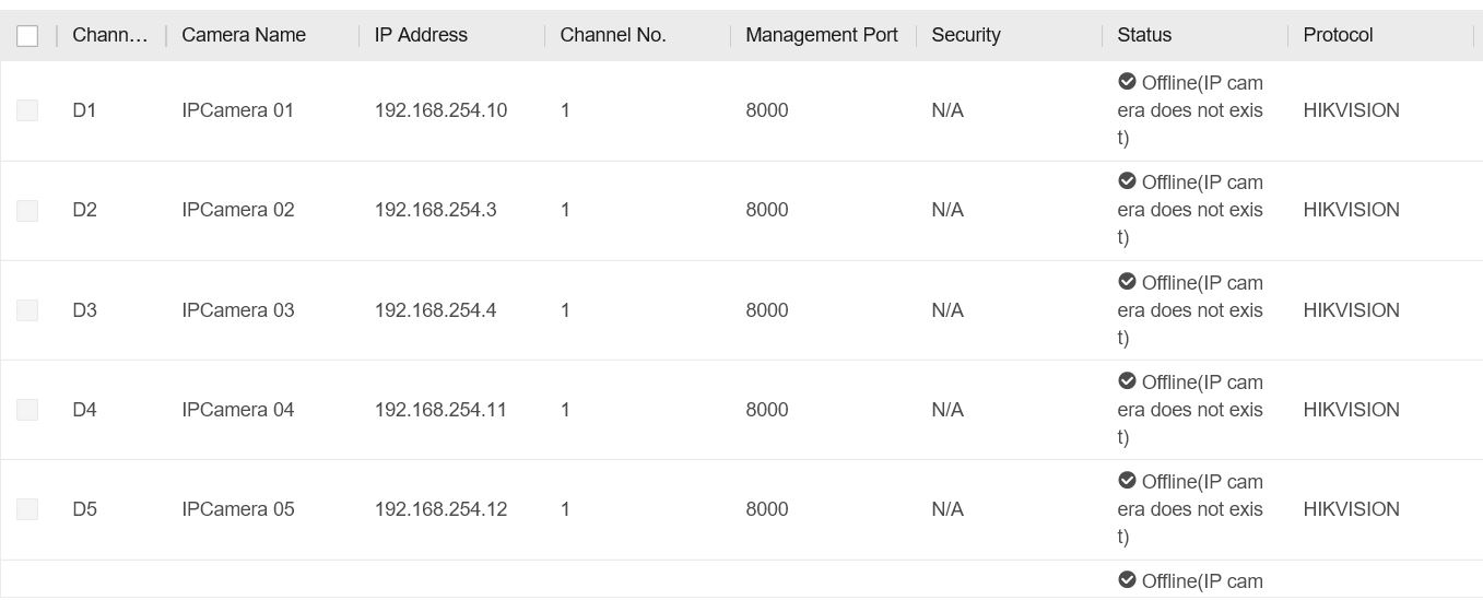

Suddenly all cameras went offline the status shows "Offline(IP camera does not exist)"
NVR
Current Version *V4.51.025 build 210927
Please help what can I do I have rebooted several times to enable the disabled POE option in NVR. My cameras are connected directly to the NVR POE port.
Has the POE port gone bad? all property of NVR works like remote login, user management etc but the camera does not show online nor live view is working. Please help

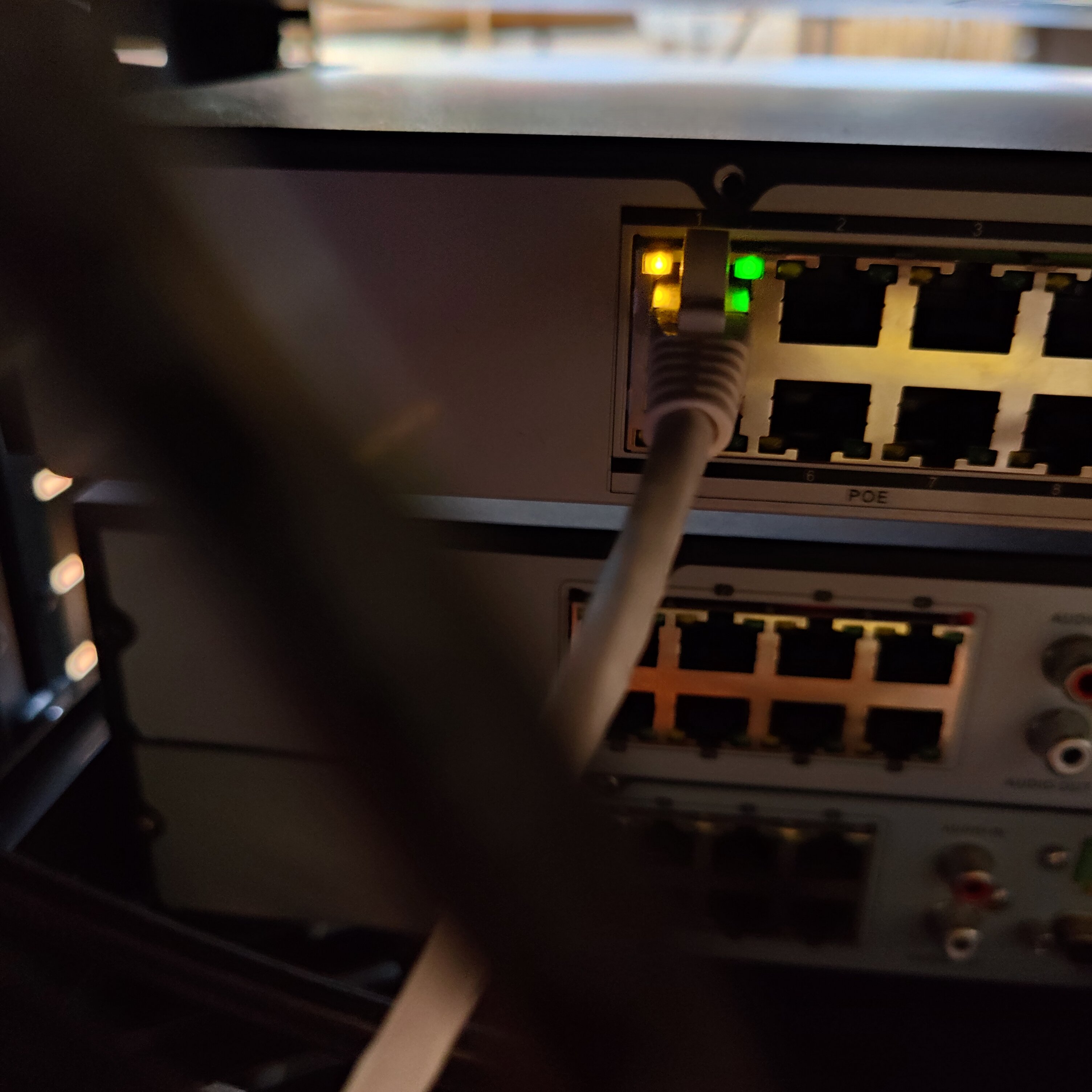

See the attached picture, if the PoE ports are working/providing power to the cameras you should see at least one of the 2 LEDs for each port lit up.
If the built-in PoE switch on the NVR had failed, one potential sign of that would be to see all of these LEDs off.
