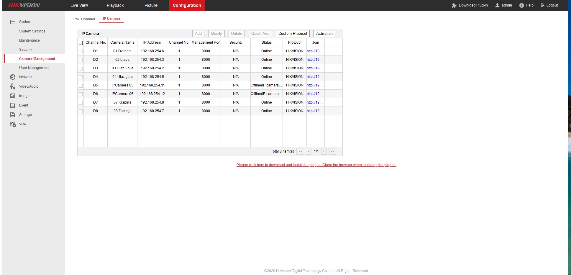

Step 4:
Now, navigate back to the Camera Management window from earlier. You'll notice that the previously empty connect tab now features links for each camera currently connected to your NVR.
Step 5:
Click on any of these links to access the respective camera via your web browser:
That's it, you're done!
