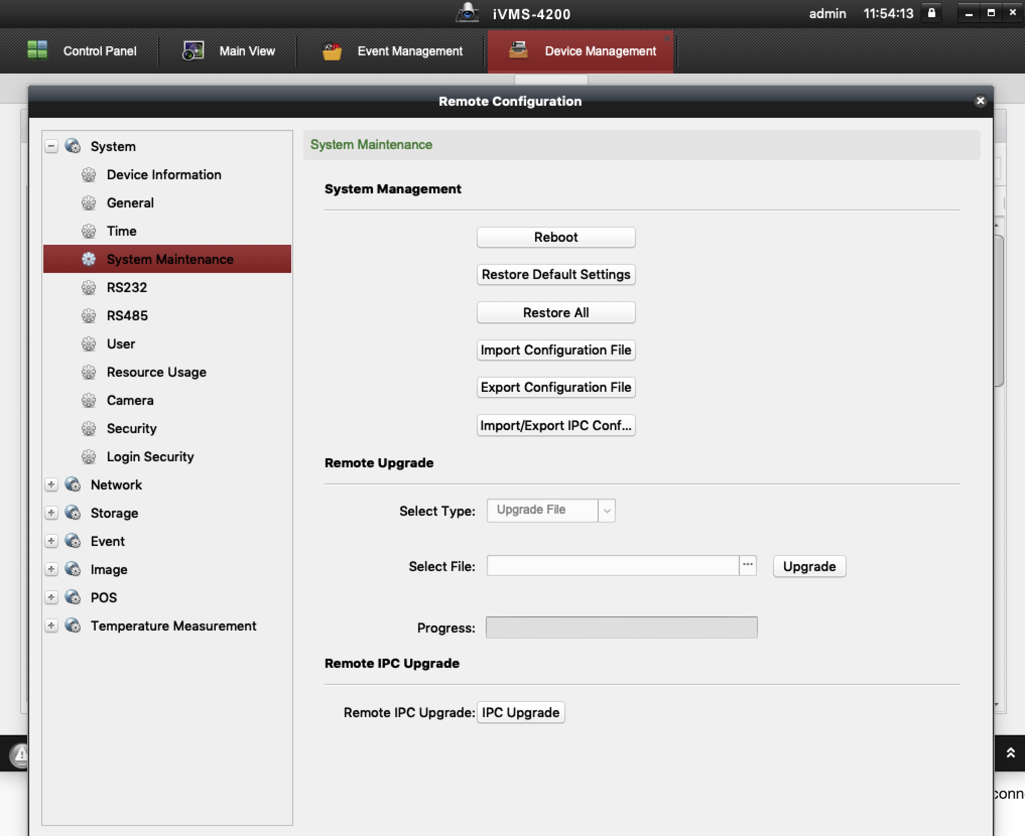

The K-series NVRs do not support the 'no plug-in' update that was given to the latest I-series NVRs and so with a Mac browser access is limited and you may have to install an older 3rd-party browser like SeaMonkey that still runs the old NPAPI plugin that the K-series NVRs use. You should still have full access via iVMS-4200 and a direct monitor, and as another option, you can update the firmware of the cameras using iVMS-4200. Go to Device Management > Group > Select a camera > Remote Configuration > System > System Maintenance > select a file and upgrade.

I downloaded the file which was labelled "digicap 3.dav". I tried to open the file on my iMac (OS 10.13.6 High Sierra) but the format wasn't recognised. I seemed to remember having this issue before. I transferred the download file directly to a USB stick and inserted the stick in the back of the NVR because I seemed to remember having to do something like this before. I then accessed the NVR and on its attached monitor screen (an old TV) I accessed "System Maintenance", then "Upgrade" and got the message displayed "Upgrading failed. Firmware mismatch" Any ideas what I should try next?
You don't need to open the 'digicap' file, once you unzip the downloaded file then you should be able to go to remote configuration iVMS-4200 and go to the Maintenance page and load the digicap file, we would try this before trying the next thing. Sometimes there can be an issue with jumping several firmware versions, If updating through iVMS-4200 doesn't work I would try downloading an earlier firmware version, update to that and then to the latest version.

Thanks for pointing me in the right direction Dan. I have now managed to upgrade my NVR to the current version 3.4.103.Build 181226. I managed this through the iVMS-4200 Application. The pathway was Device Management: (Select NVR); Remote Configuration: Upgrade. The weird thing is that I'm pretty sure the file I chose from the desktop of my iMac had the ending ...STD_V3.4.82_160810.zip which looks like it is an old file from a year or so ago. Would this automatically "look for" the current version? Anyway, I'm only too pleased that I now have an embedded NVR with version V3.4.103 without really understanding how I did it. You may note that this is a version that seems to supersede the version you suggested was current. i.e. I have V.3.4.103 rather than V3.4.101.
