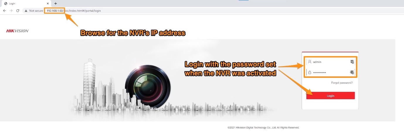

Step 1:
Connect to your NVR in a web browser by using its IP address and logging in.
