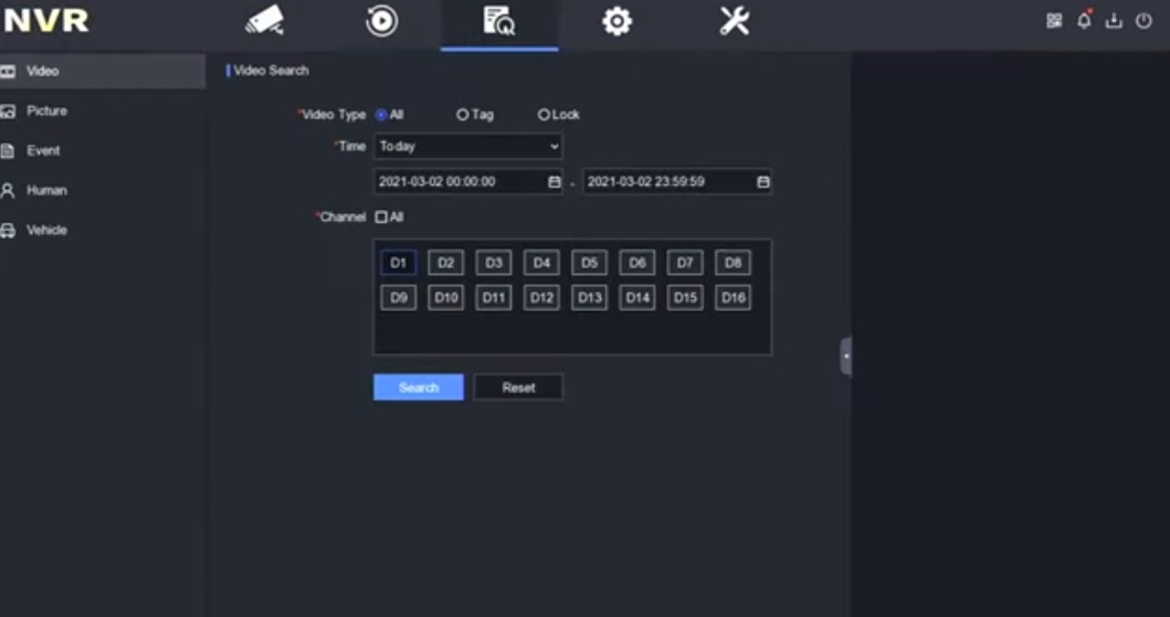

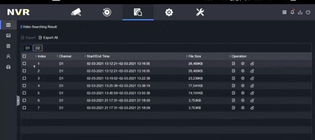

have found on the YouTube is identical , I saw here selected just 1

So the NVR breaks up your continuous recording into set packages of footage that are usually around 30 minutes in length by default, so if you wanted to download 7hrs of continuous footage you would need to download the multiple packages of footage that make up that 7hrs.
You can extend the duration of these packages, but I don't think you'll be able to extend it long enough that you'll get the whole 7hrs in one file.

That is what I thought, if you want to download all 7hrs of footage you will need to go into those search results (as is shown in the video) and select the multiple files that cover the 7-hour window you want to download.
You won't be able to download just one file that contains 7hrs of footage.

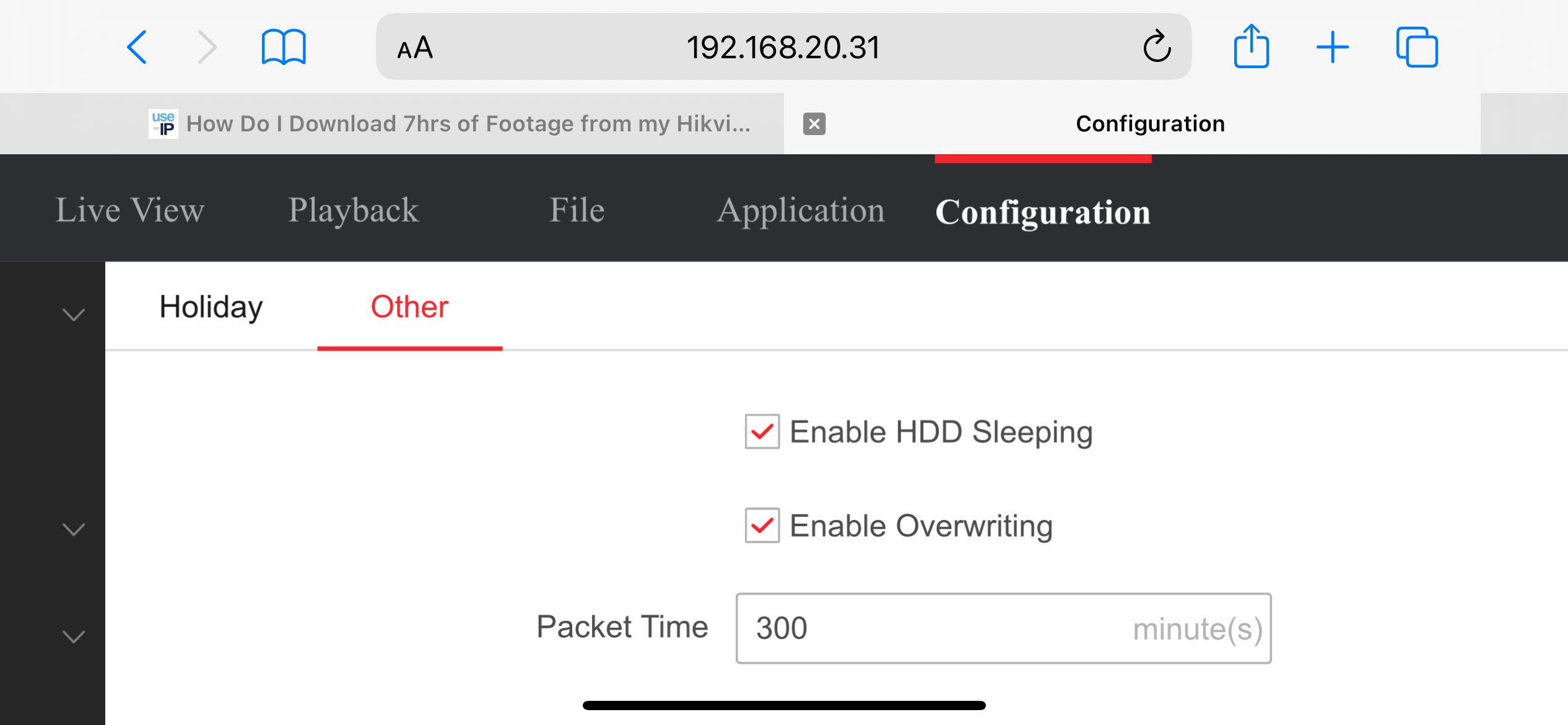

Hi Dan,
I’ve got a DS-7616NI-M2 / 16P NVR and am using a web browser to access the system.

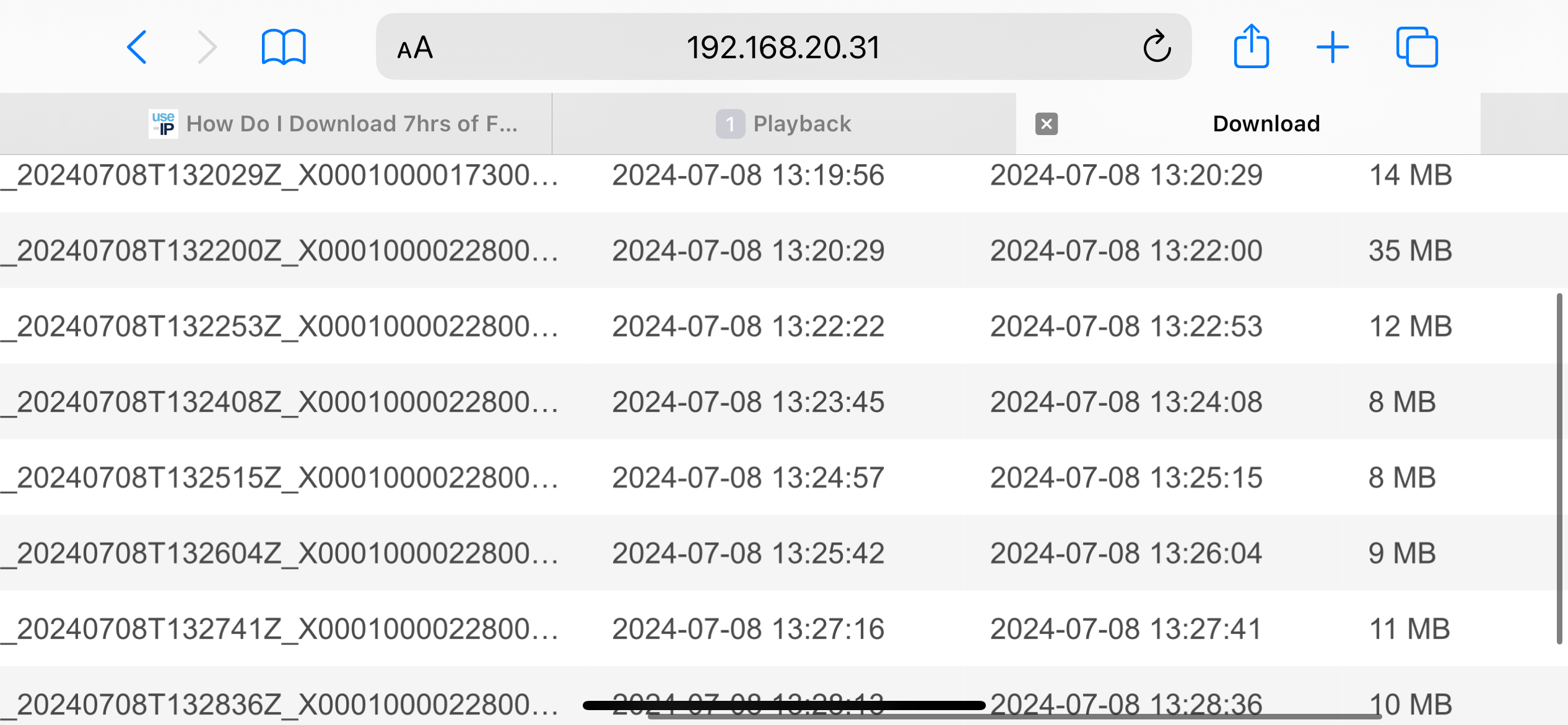

I found the below setting which I set to 300 mins, but it’s still only recording packets of around 30 seconds in duration (see second image).
Firmware Version is V4.61.430 build 231123

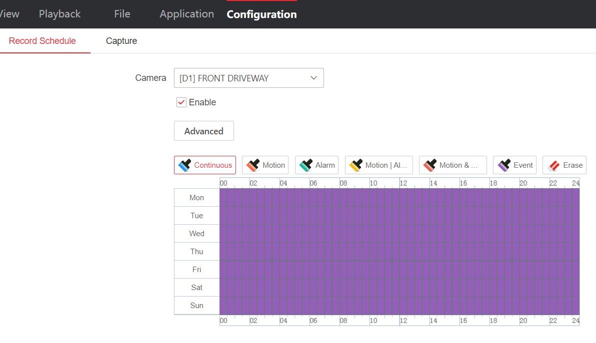

Hi Dan - yes all cameras are set to Continuous Recording Under Storage>Schedule Settings per below image (as I assume the red box around "Continuous" means that is selected).

Thanks @JohnD
So looking at that screenshot you actually have the camera set to Event recording (Purple), to set it to continuous recording you need to select the "Continuous" button (highlighted in red in your screenshot) and then drag & drop across the schedule to colour it in completely Blue for 24/7 continuous recording.
Once you've done this, you'll then need to leave it for a couple of hours to see if it is now successfully continuously recording and creating 300-minute packets.

Thanks very much Dan - makes sense. Have now painted everything blue and will advise in next day how it goes.
And looking at previous recordings it’s now obvious that not all time was being recorded (ie there were gaps between recordings between each file). No wonder I was getting 5-6 weeks worth of recordings on my 3TB drive… looks like I’ll need to add a 2nd drive now we are actually recording continuous…
