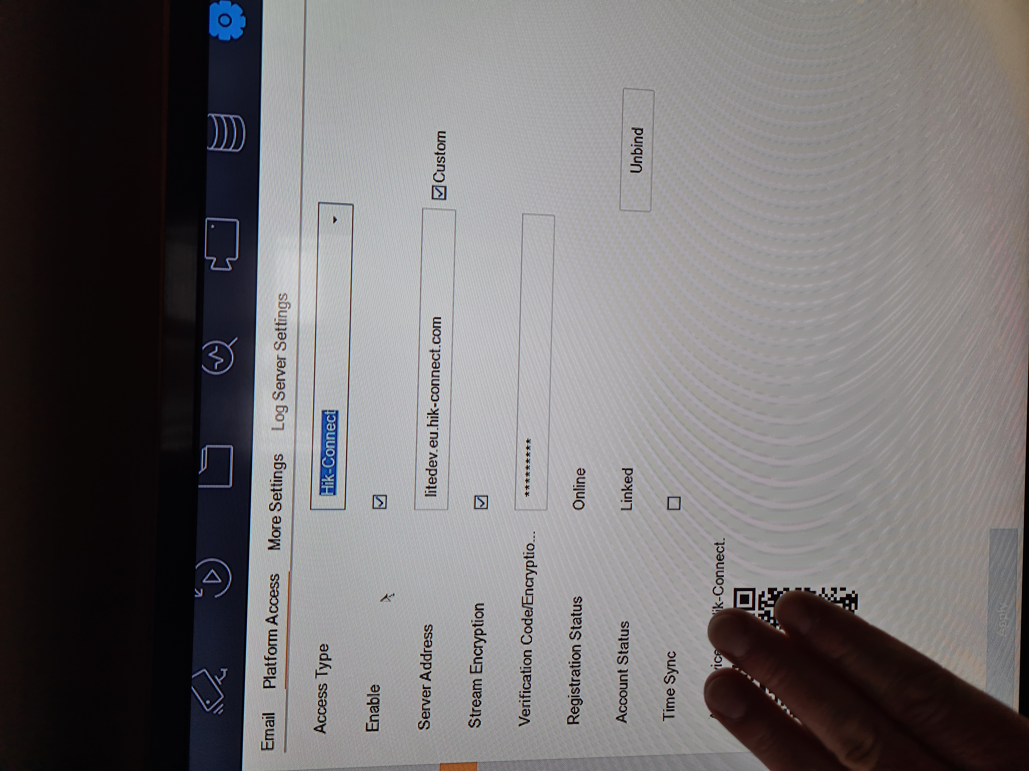

Looks like your hik connect address might be wrong?
I think the eu can either be present or not. It’s just a server location. So can also be dev.hik-connect or dev.eu. I have tried all different server addresses as well but no luck.

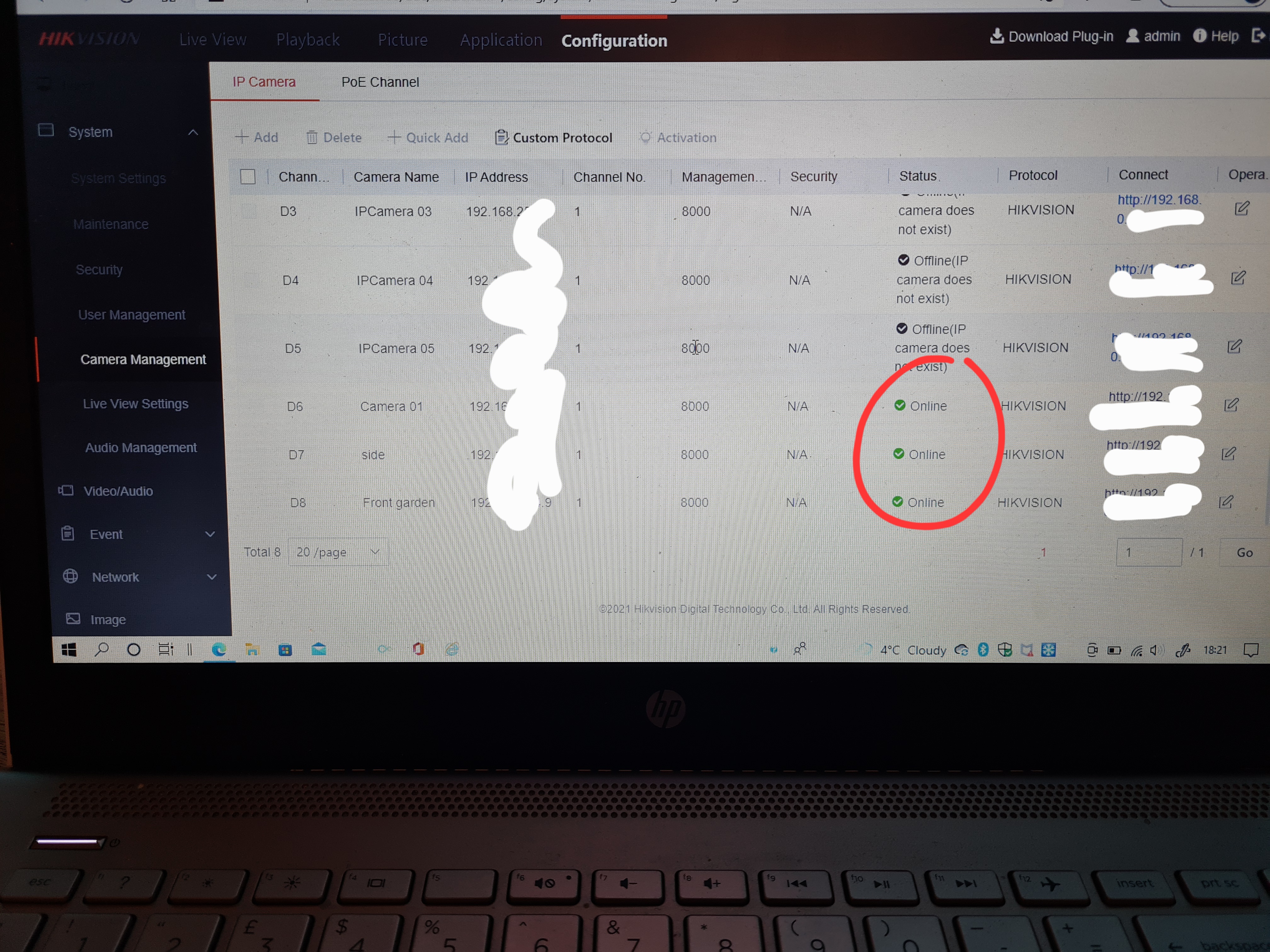

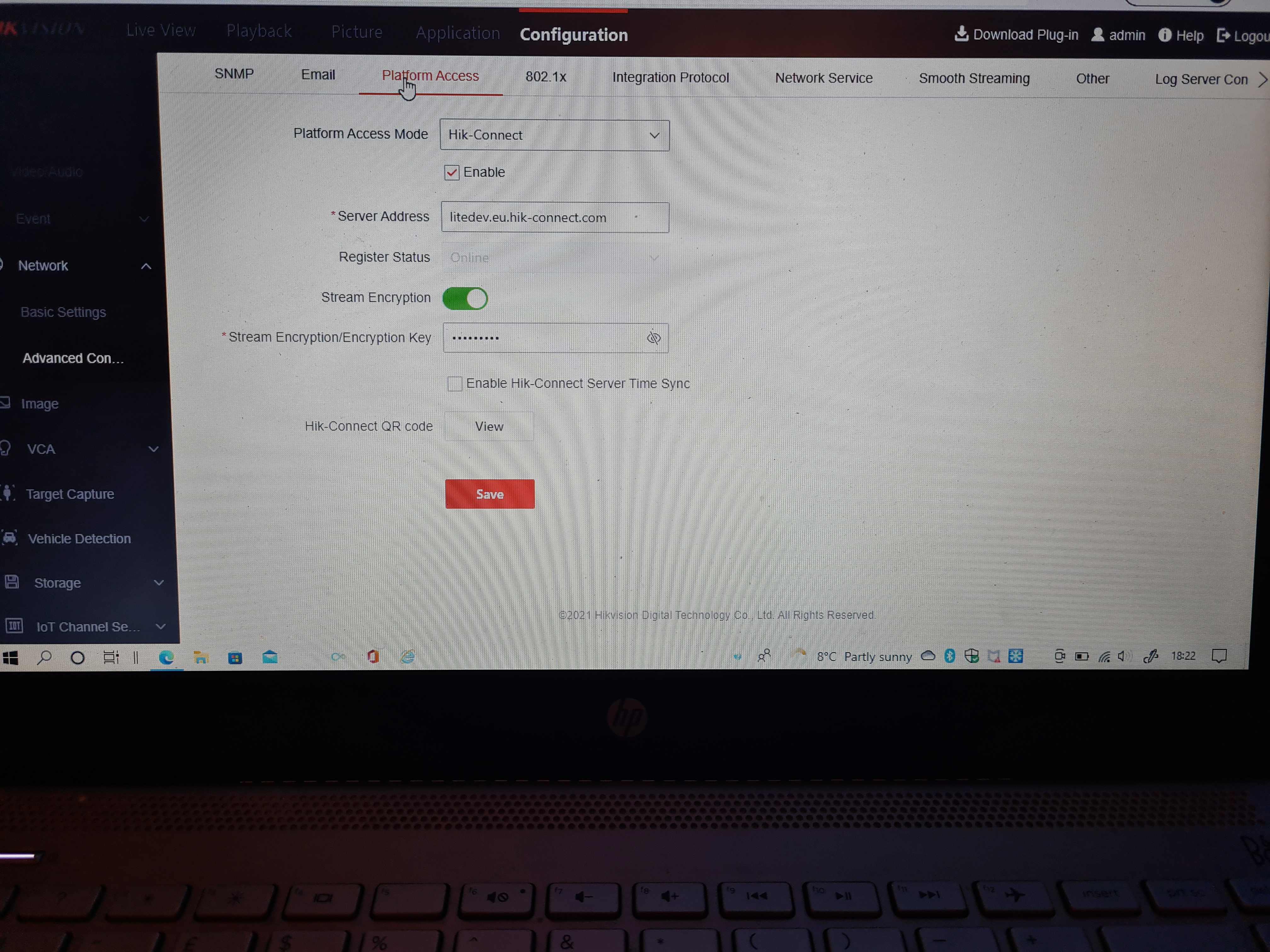

If yours is like this it must be an issue with your app
Yer my cameras are all online. If I connect a monitor to the NVR I see live video. If I connect via IP I can see live video / playback video. The platform access part is the same apart from the server address but I’ve tried that. I guess I will need to contact support for this.
I’ve even tested pinging 8.8.8.8 on the NVR to prove my network is online and I got a good response. So I’m pretty certain my NVR is connected to network with internet.

I solve my problem with green screen with:
Go to Network > Advanced > Platform Access OR Hilook (whichever appears on your screen)
Disable Encryption OR Verification Code
