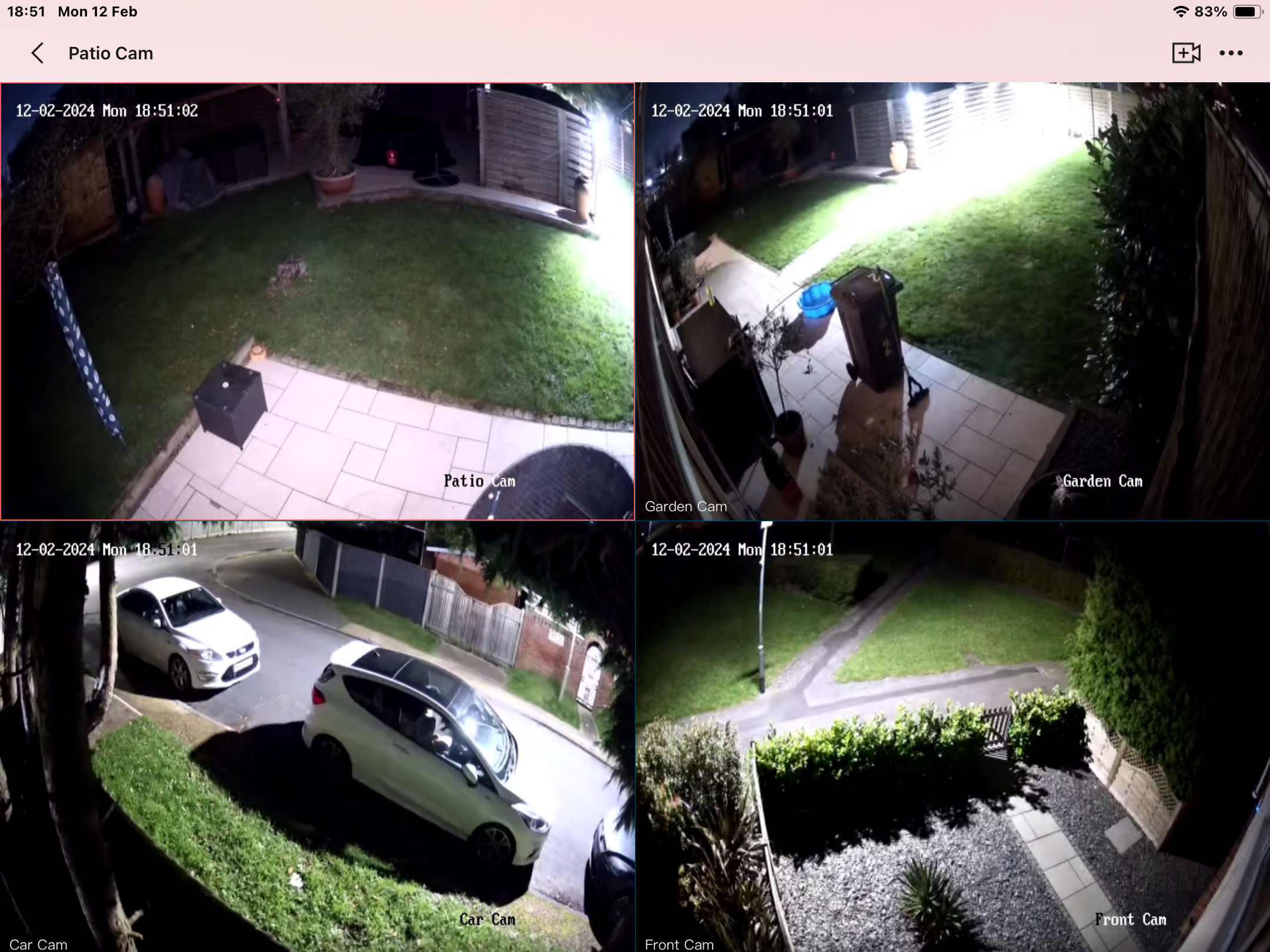

I’ve been trawling the web looking for a solution to the very same problem! Recently upgraded my iPhone 13 Pro Max to a 15 pro max and after updating the app, that’s when the problem started…funny thing is everything works fine on the 13 but can not view notifications or watch ‘playback' on the 15! Both phones are both up to date, the app on the 15 is 6.2.1 but the app on the 13 won’t update now, despite accidentally tapping “update” last night. I’ve done the usual log in/out, deleted the app and reinstalled it and rebooted the phone….no change! As shown in the image, notice the date….why it is showing that I have no idea but when I tap it, the app crashes! Needless to say, I won’t be updating anything else until this is fixed. In the meantime if I manage to figure something out, I’ll be back
