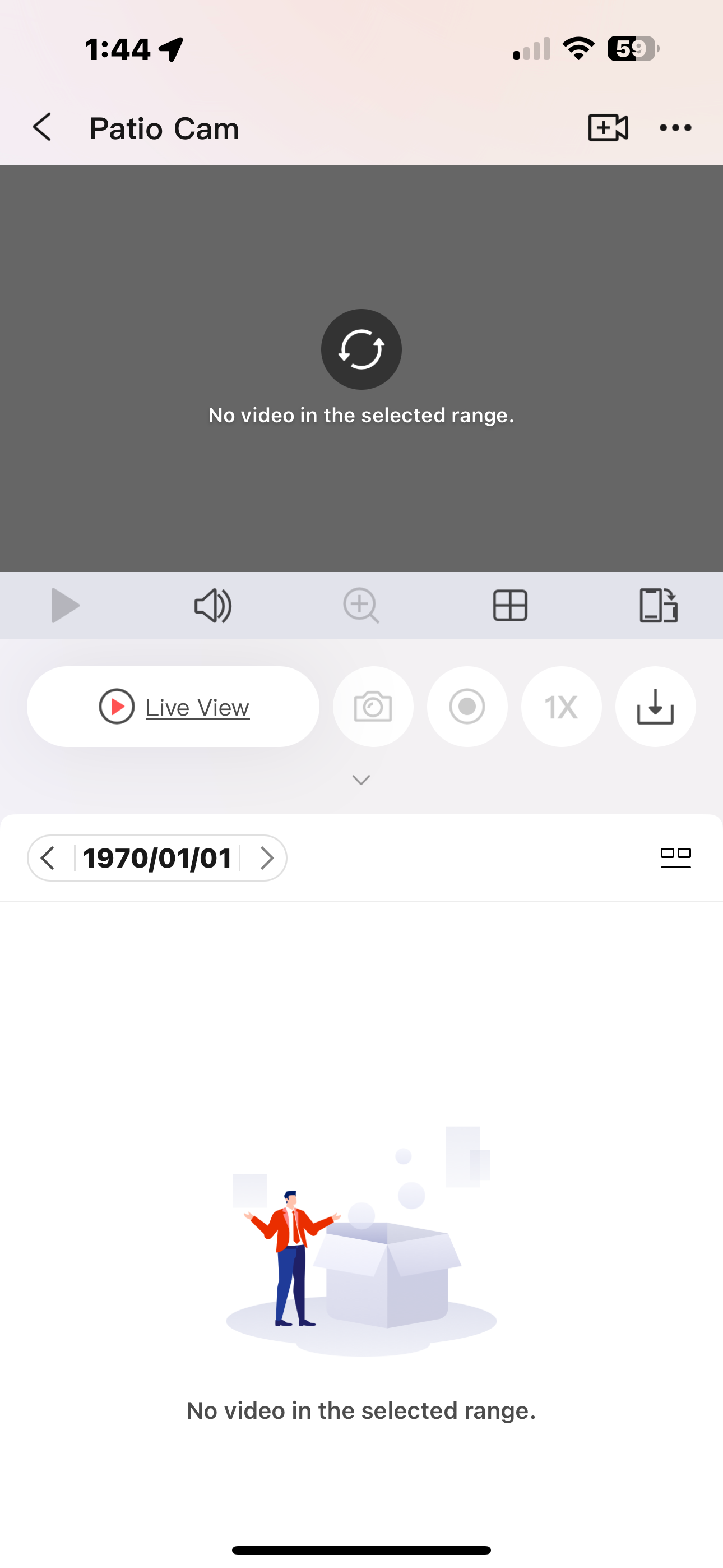

I’ve been trawling the web looking for a solution to the very same problem! Recently upgraded my iPhone 13 Pro Max to a 15 pro max and after updating the app, that’s when the problem started…funny thing is everything works fine on the 13 but can not view notifications or watch ‘playback' on the 15! Both phones are both up to date, the app on the 15 is 6.2.1 but the app on the 13 won’t update now, despite accidentally tapping “update” last night. I’ve done the usual log in/out, deleted the app and reinstalled it and rebooted the phone….no change! As shown in the image, notice the date….why it is showing that I have no idea but when I tap it, the app crashes! Needless to say, I won’t be updating anything else until this is fixed. In the meantime if I manage to figure something out, I’ll be back

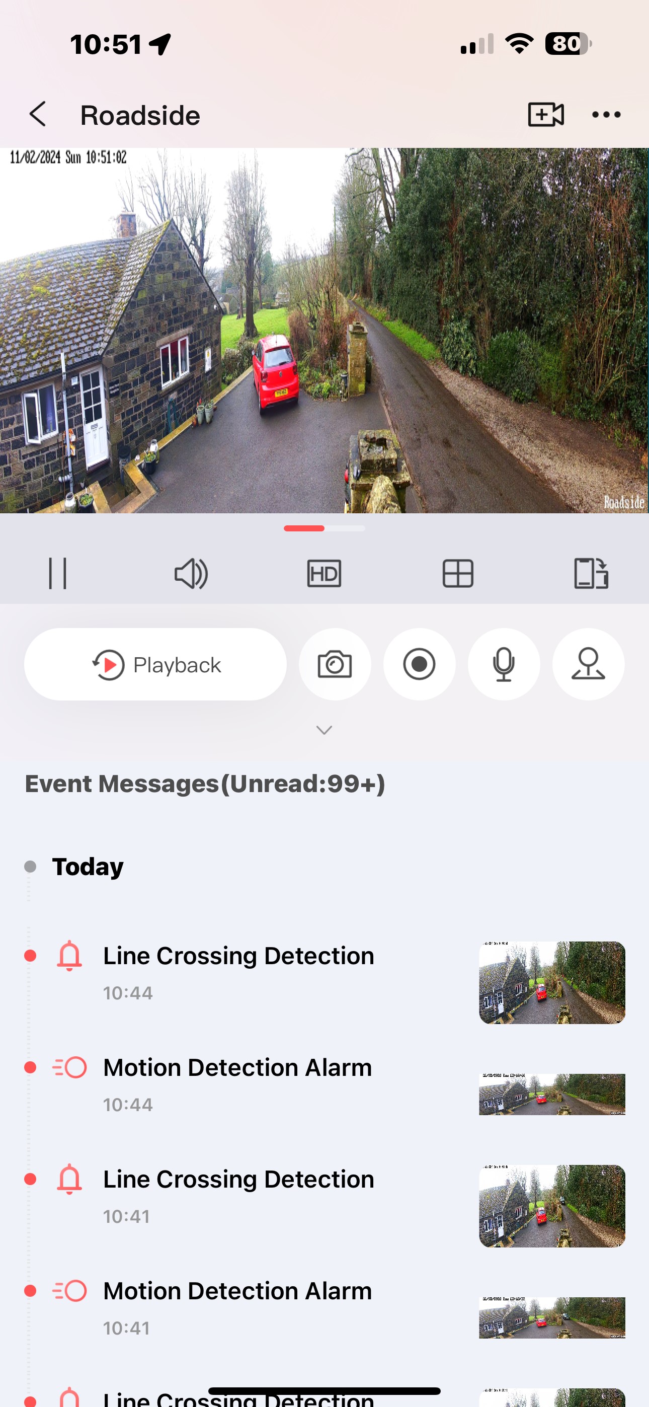

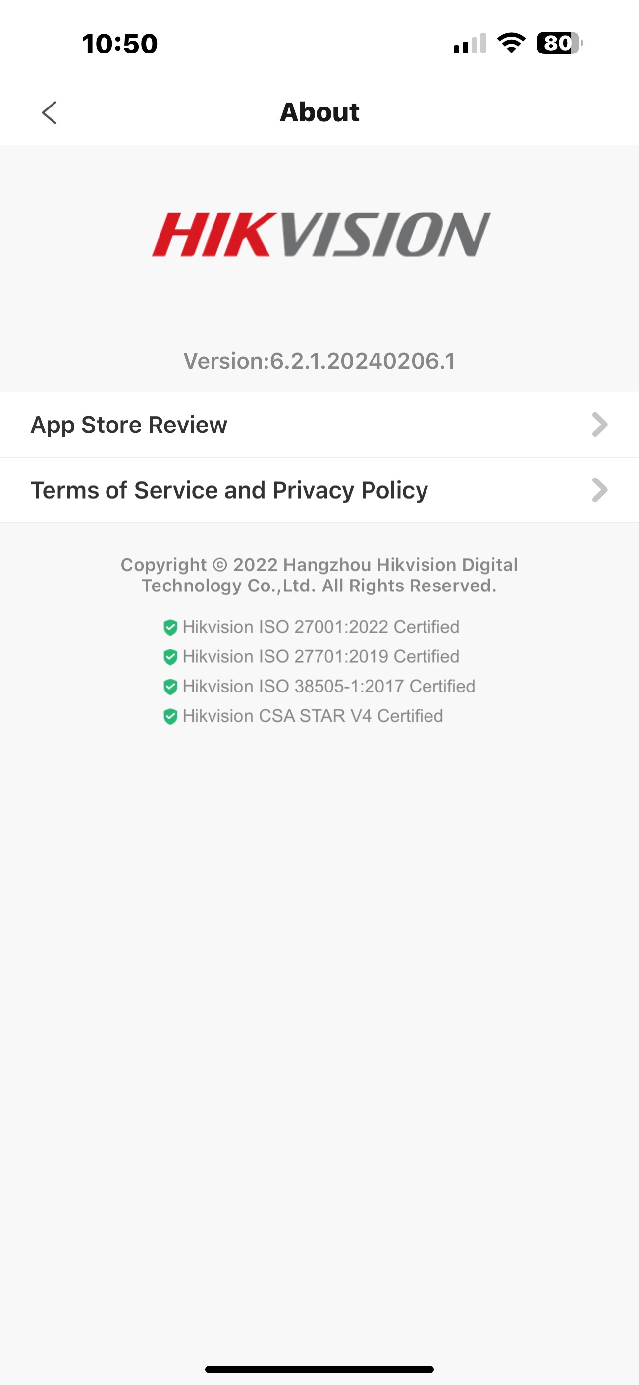

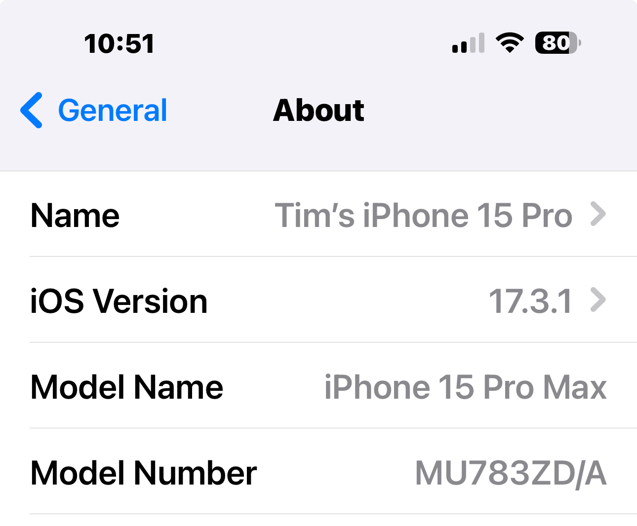

Hi Neil, Thought I would let you know I am running the iPhone 15 Pro Max and everything is working fine with the App 6.2.1
The only issue I have is the "BUG" already spoken about with the jerky playback but it actually works.

Hi Busterboy….occasionally suffer with the jerky playback but i guess that’s to do with the distance between my router and the DVR….thats in the loft while the router is in the lounge, about 50' away! If the problem isn’t sorted before we go away for a few days, I’ll have to put the sim back in the 13

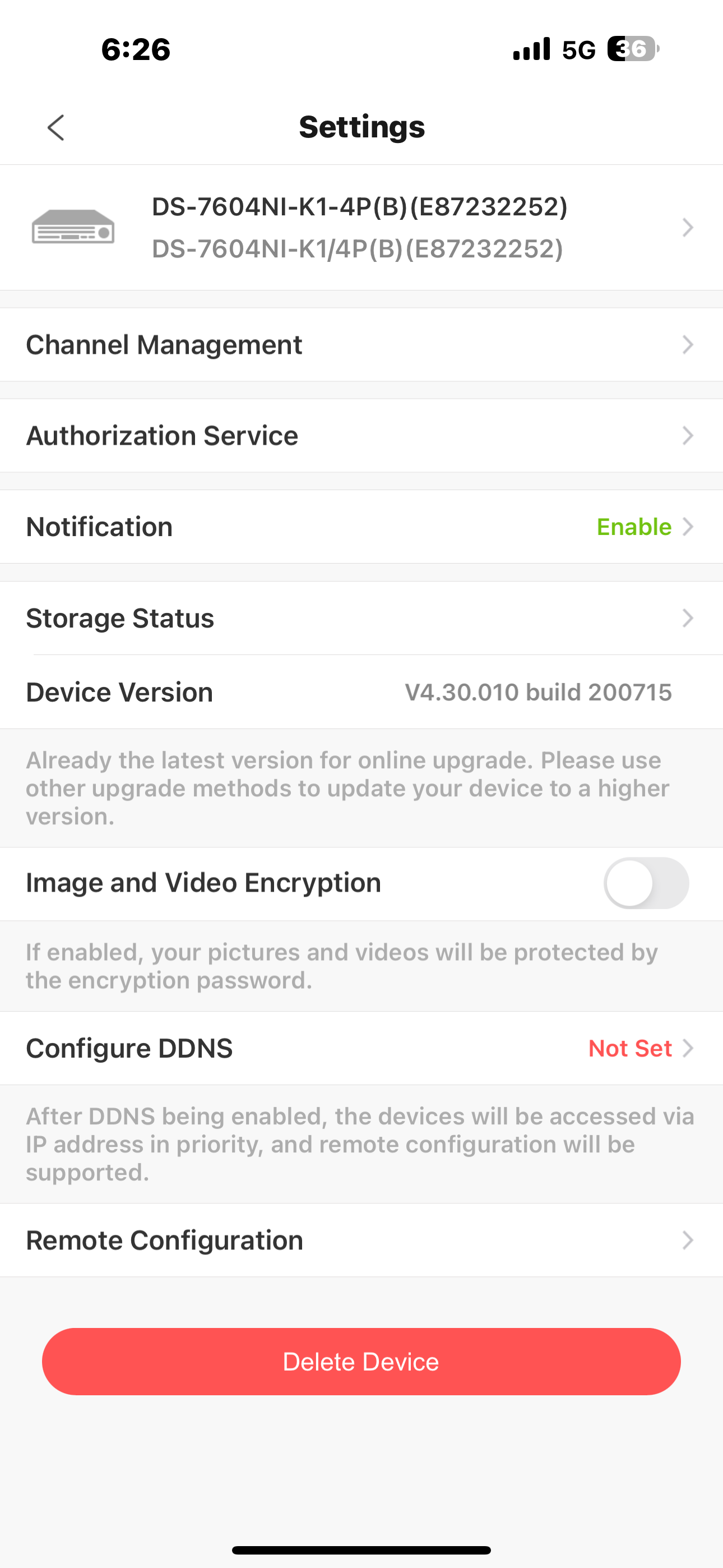

Hi @Neil_H ... what NVR do you have... which firmware?
Gentlemen…..please excuse my late replies, I work nights (lgv driver) and it’s easier for my oldish eyes to view on an iPad than an iPhone!
@johnfitzy….is this any help? Other than that, I have no idea what box it is as I never purchased the system myself, it was a friend of the families brother who works for a local alarm company…up until this last update it’s performed perfectly and to cap it all, my old iPhone decided it would automatically update the app so now I only have it on my iPad!
