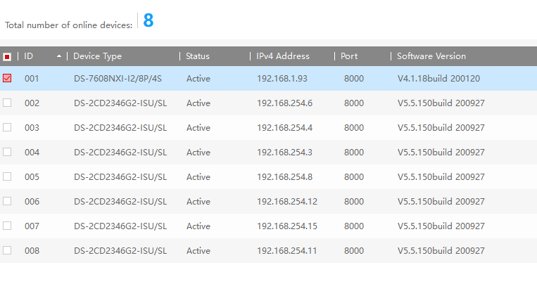

When talking about user accounts we need to be specific, which account are you talking about?
Using ivms4200 the NVR is added as a device and needs a username / password to access the NVR, do you know what username password this is?
You can also remotely configure the NVR using IVMS4200, see attached screenshot from the maintenance & management tab
