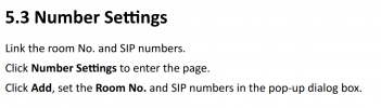

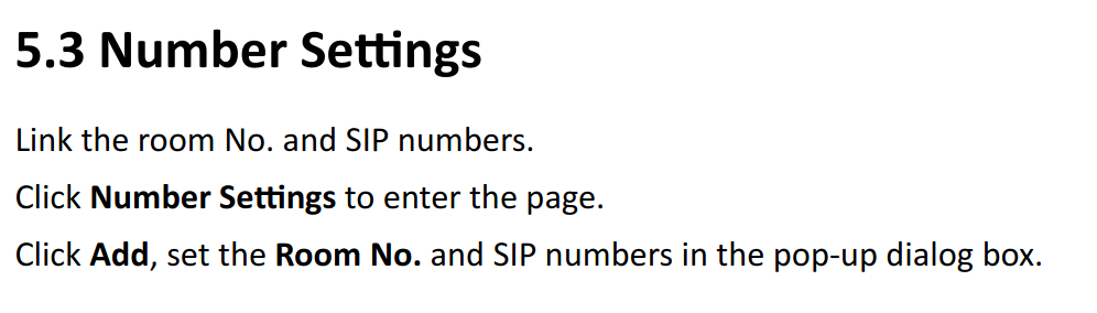

Hik documentation is very poor. It seems that you have to setup room numbers. Set # 2 to the room 1. Intercom will call to this number. I also wish it to call the next room in the list, if nobody answer the first, but it doesn't do that, so I had to setup this with asterisk.
  • UD20207B_Baseline_Video-Intercom-8-Series-Villa-Door-Station_User-Manual_V2 2 3 PDF.png
Yeah, found it too and indeed I had to setup forwarding rules on free PBX
