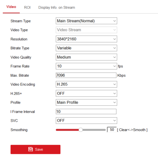

I have 4 cameras tiled all displaying sub-stream, if I double click one of the cameras it displays:
"Not Enough decoding Resource. Please switch to sub-stream"
I've been through the camera and reduced the bitrate on most of the cameras.
This used to work fine on the previous firmware, any ideas?

I've lowered the video quality and data rates on the cameras, but it is still doing it.
It was running fine before the FW update.

#3 will still not go into full screen mode on the NVR
